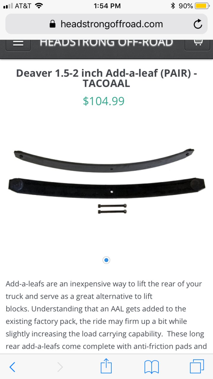

    Ok my TW family. I wanna lift the truck some more but not sure I want to use blocks. Currently running Billie 5100’s front and back. Is there a Billie shock that I can run in the back to achieve a 1.5/2 inch lift like I can in tha front? Also can I still run stock springs?

    shocks dont lift, springs / blocks lift. :thumbsup: they do make extended billies for the rear though

    Thank you for the clarification jimbo. What springs can I use to achieve a 1.5/2 inch lift?

    do you have an add a leaf in there yet? I think the deaver single AAL gets 1.5"-2"

    No the only thing I have changed is I have the bilstein 5100’s everything else is stock

    No he's stock on the rear with 5100 on the front set at .75 to level it out

    the add a leaf, add a leaf (or 3) to your existing rear leaf springs. much better than blocks for sure :thumbsup:
    or new dakkar leaf pack........for $550+, they would likely get ya 3+" though

    These?
