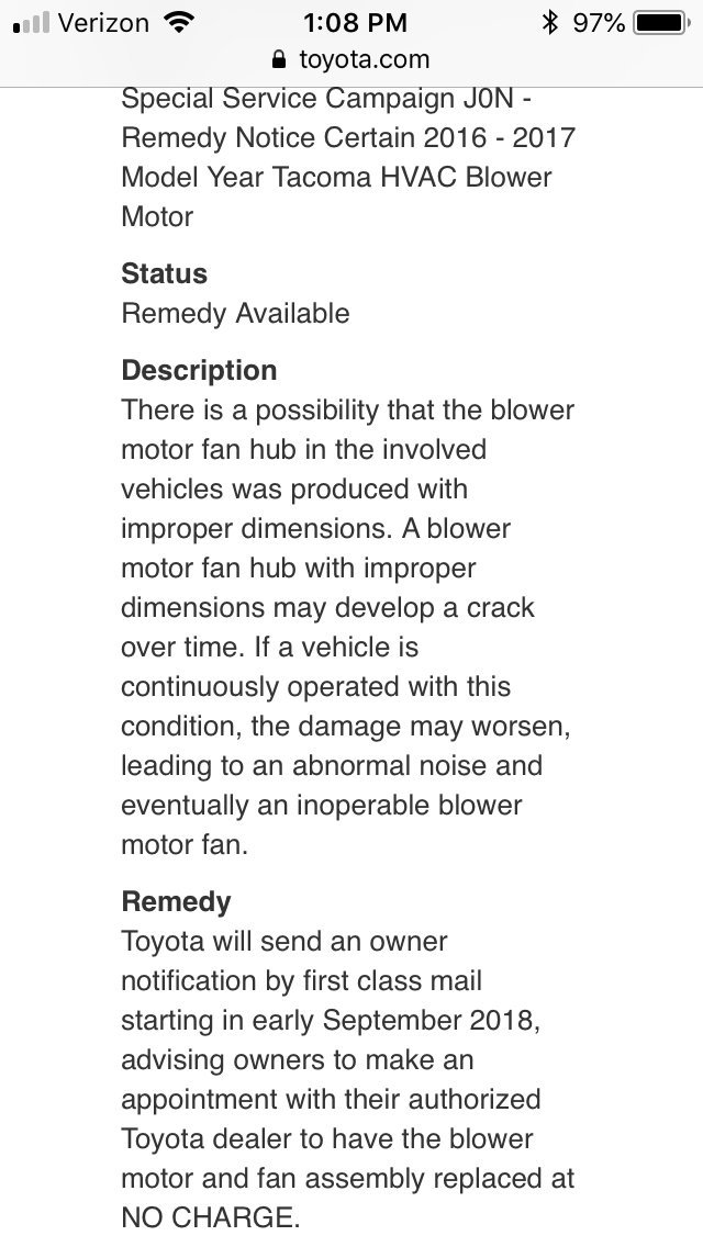

    @SC2SC theres a recall rolling out for the 3rd gens a/c. Is it possible yours could be included in that even though it’s not a third gen?
    SC2SC and scottalot like this.

    Hmmm... worth looking into- although they are paying for this one.
    Extremely. Beyond Frustrating.
    Dealer said Toyota agreed to replace condenser, even though it had been more than 12 months since it was replaced uneer warranty. (If I had paid cash for the repair- would have been warrantied for 36 months...o_O)
    Dealer said Toyota wants consumer to pay a small portion, since no longer warrantied, but clearly not right. Dealer said usually 10-15% consumer pay. For me that was $84.xx.
    Whatever.
    Could not argue as I am ATL now on business, and wife was dealing with it.
  14. Sep 19, 2018 at 7:15 PM
    Sammie
    Sammie :D :P ;)
    Nov 14, 2016
    #202417
    10,018
    NC
    ‘17 Tacoma BBP
    SC2SC[QUOTED] likes this.

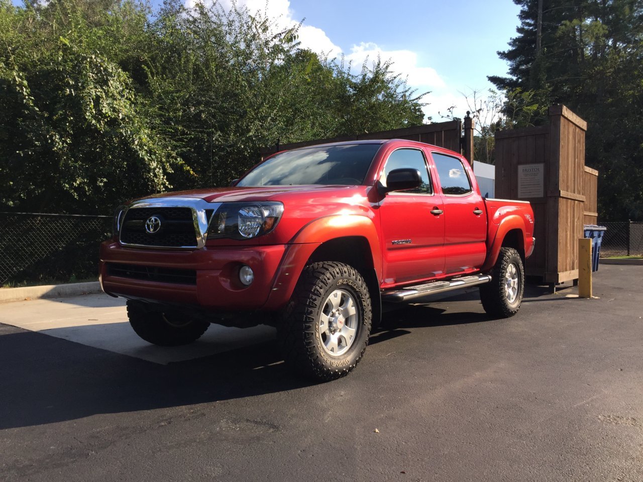

    Spray waxed my pavement princess today and felt it was too pretty not to post. I’m very loyal to Colinite 845 and always use it, but the Meguiars ultimate quick wax makes the paint really pop for reasons unknown to me. Loved this pic so much that it’s my new avatar. The clear coat on the roof has failed despite my rigorous detailing, but I suppose that will happen when it’s been parked outside for over 10 years straight.
