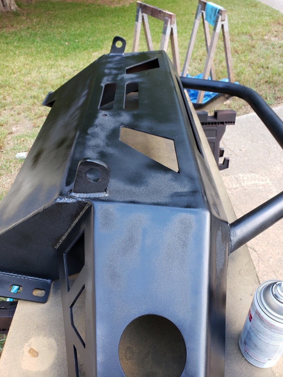

    Need some advice on getting this paint to look better. I've been wet sanding with 1200 grit sandpaper, but still getting rough spots.

    I did the alcohol wash, then sanded with I think 300 grit, then a few coats of primer, then moved up to maybe 500 grit? Now I am using 1200 grit and wet sanding between sprays.
    This is all hand sanding.

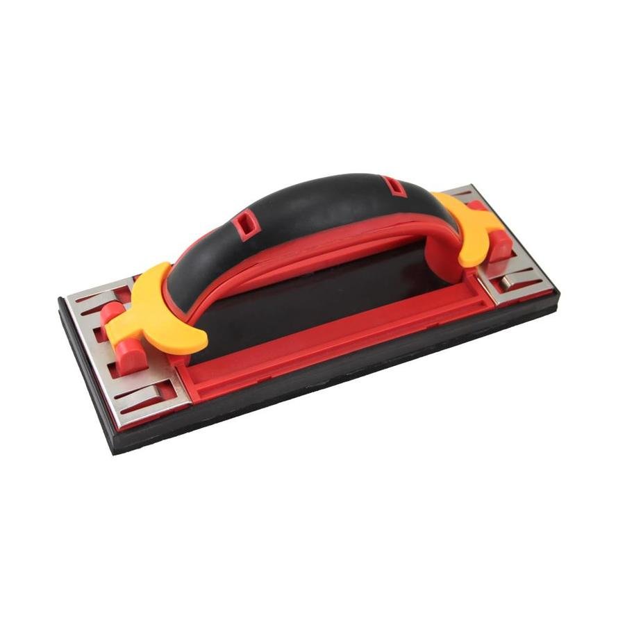

    Oh, and I am sanding with this guy.

    Is those spots where the paint is wrinkling? Is that two different types of paint? Would cause separation of the chemicals. Too wet in some spots. Not consistent painting Strokes. Let it dry for 3 hrs. Dry sand those spots blow off. And use blue lable bedliner spray. NOT undercoating.

    It might be the uneven spray. I tend to keep the nozzle around 6-8 inches away from the metal. Also if you spend too much time on one particular area when you spray, it tends to wrinkle up with too much paint build up. Light thin layers spray is key to quality even paint.

    Thanks, guys. I was going to do line-x but they want too much money. I think it's not consistent spraying, and pretty sure I am more than 6-8 inches away. I am going for a shine. I really liked @GreeGunc bumper when I saw it. It was like powder coat it looked so good.
