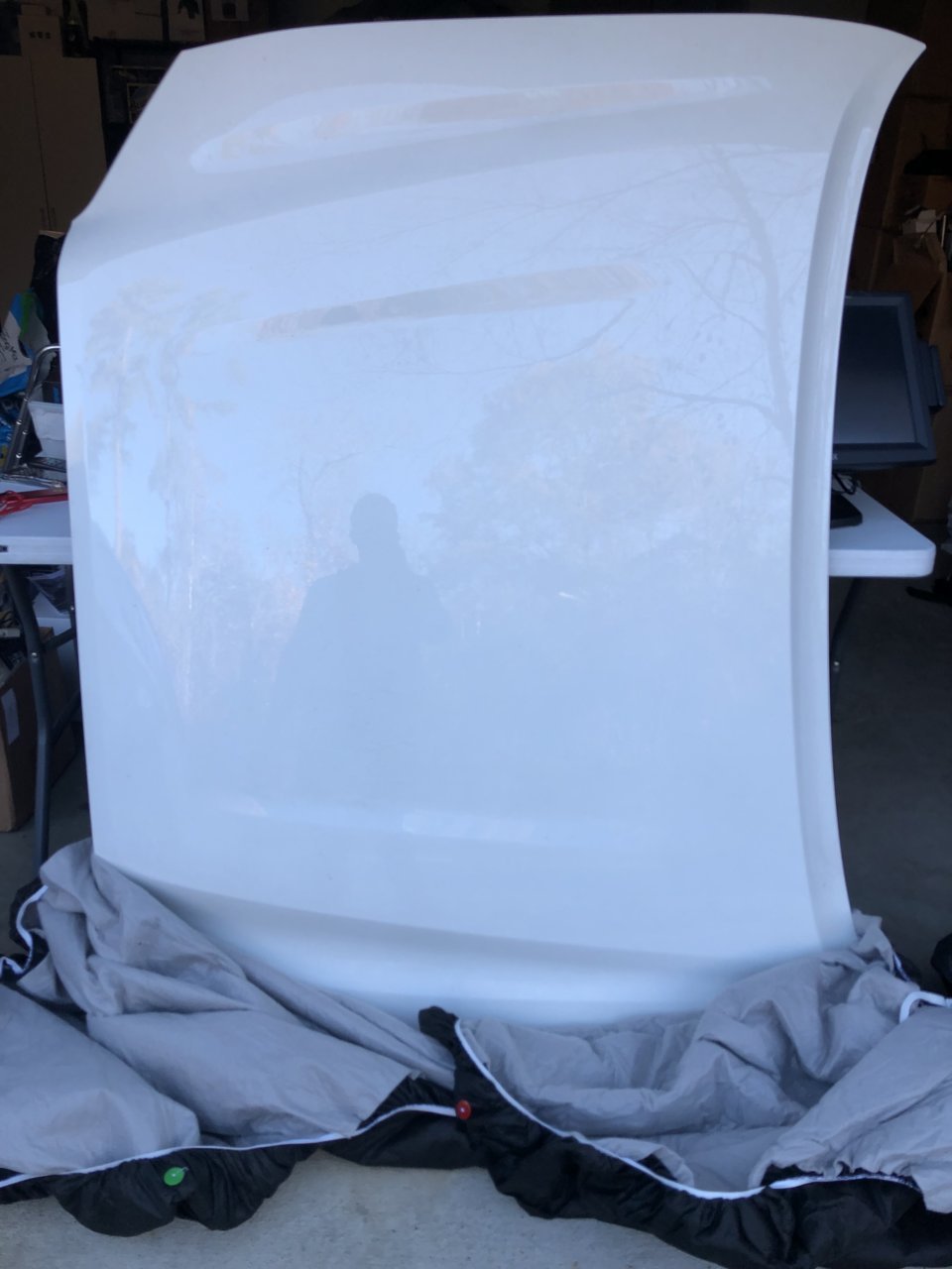

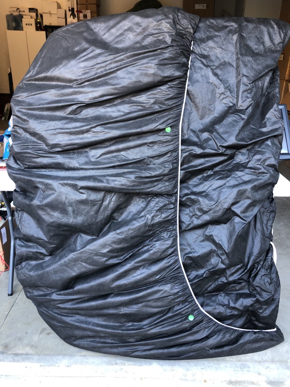

    Trying to sell this. I'm in Columbia,SC
    I ended up getting a scooped hood. This one is 10 months old. Is fully wrapped from dealer with 3M.
