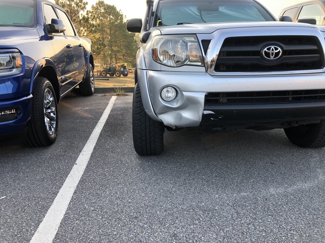

    Went to firestone to get an alignment after I replaced parts... maxed out adjustments on LCA and tie rods and it’s still off. My last hope is a bent spindle. Otherwise my frame is bent

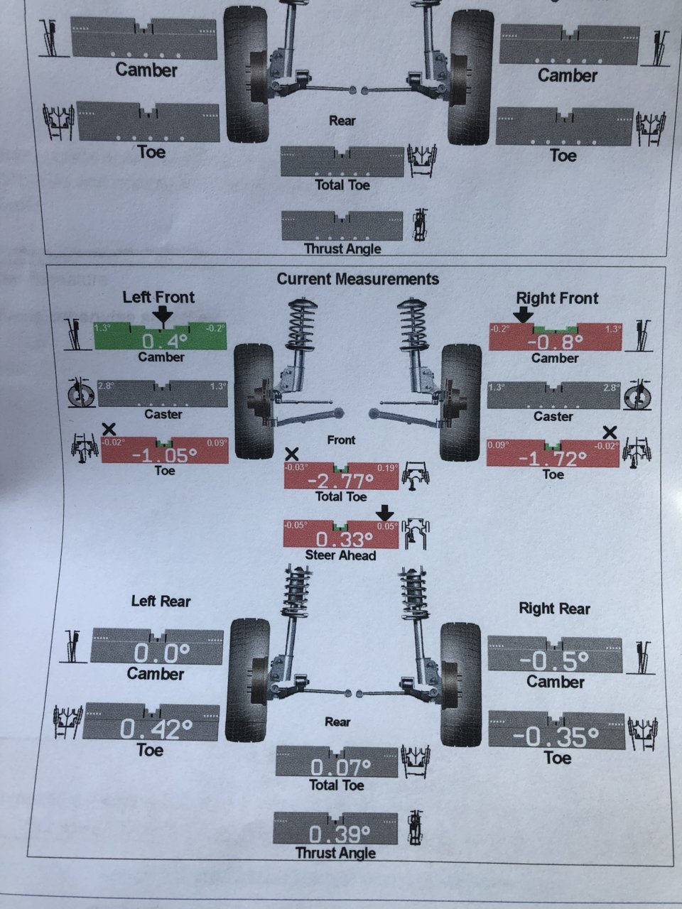

    Was it ever in a wreck? If not do you have your print out of the alignment?

    Post your alignment sheet

    A guy had trouble aligning my truck a while back and asked if it’s ever been wrecked. Said yes, and he said could be that the frame is bent because the passenger side could not get into spec.
    the body shop said the frame was off by .001 inch when they put it on the machine right after I wrecked it, so who knows.

    What was your thrust angle measurement?

    passenger side caster is maxed out. Stock UVA’s tho.

    You're thrust angle is perfect at .2 a bent frame or really fucked suspension the thrust angle would be well over 1

    Yeah... this all started when I hit a big buck at 70mph on I-26. My passenger side was leaning in so far it was almost touching my spindle.

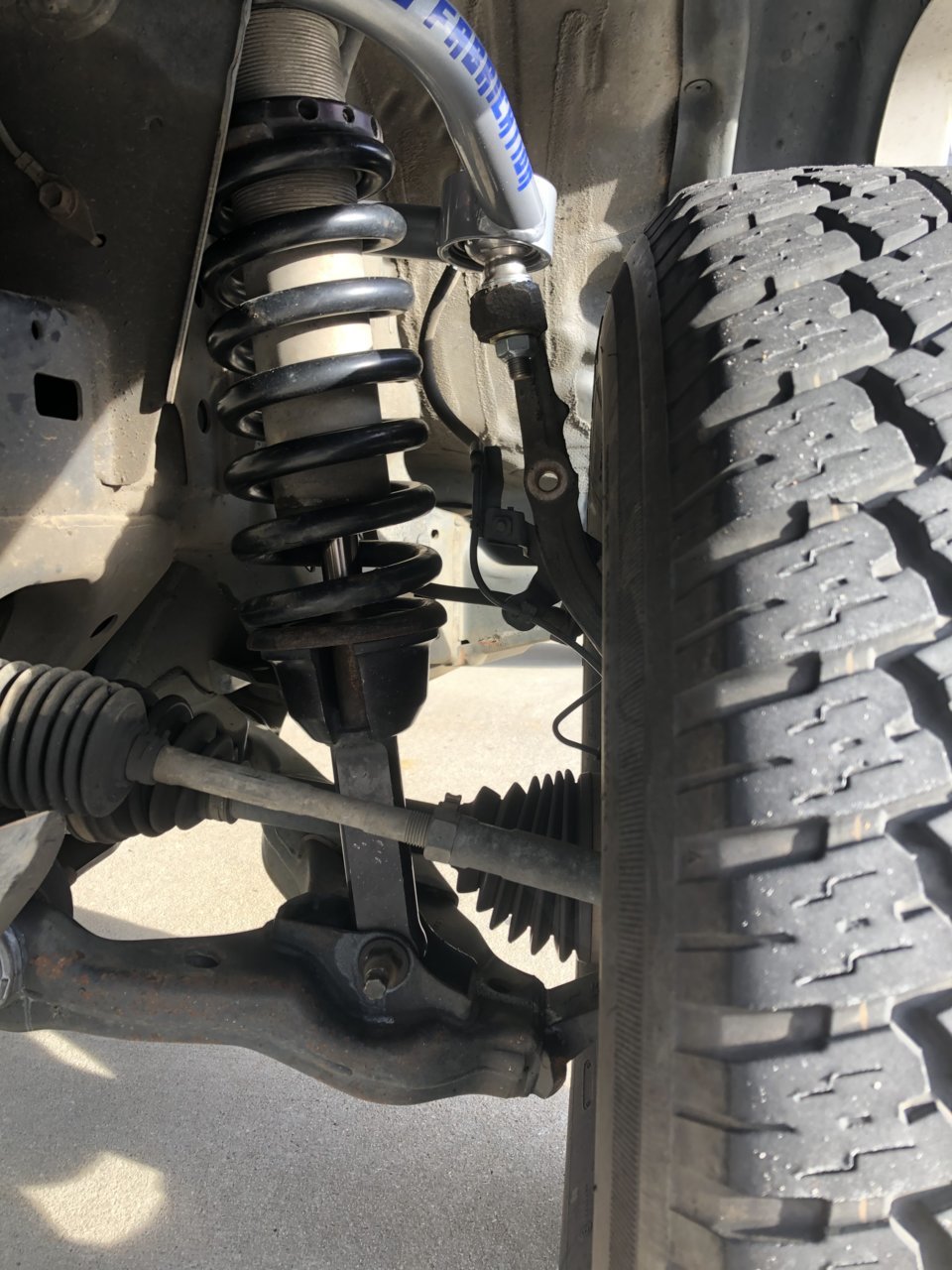

    When I brought it in the right front camber was at 5.0 but I eyeballed it after new LCA and hardware. Front right tie rod is at its max.

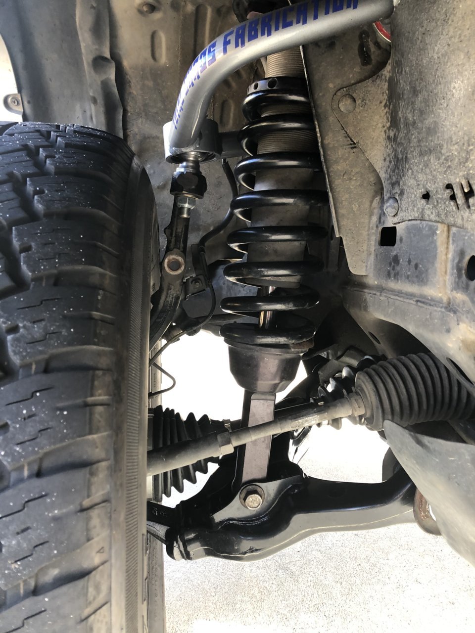

    See pics

    holy shit dude

    :goingcrazy:
    Yeah. Something is fucky.

    the other wheel is straight. This was right after hitting the deer. Top of tire is leaning in bad. Stance life lol

    Probably a bent spindle. Those specs don't scream tweaked frame to me but I would have it checked none the less.
