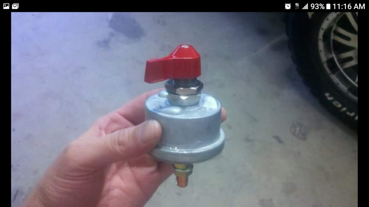

    Installed my SOS streamline bumper, winch and rock sliders yesterday. So now I have the Cali rake, but that's better than the Carolina Squat. Have to order spacers now, it really is a rabbit hole. :D
    Mounting the control box on the winch after installing it in the truck without removing the bumper is fiddly and a giant PITA! Definitely should mounted that beforehand. But at least the winch works! I'm not sure how I feel about it having power all the time. I may install a cutoff switch.

    OME 881 coils with OME nitrochargers shocks up front. TC UCA's OME Dakars with extra leaf in the rear. Warn 8000 winch with 80ft custom braided synth line. Custom 60ft synth extension. All pro tube bumper, Hi-lift jack, Safari Snorkel, Wilco tiregate. 2019 Jeep JLUR.
    I purchased one for that purpose after reading some horror stories about thieves cutting the wires and stealing winches leaving the exposed wires.
    Some resulting in vehicles fires resulting in total losses. 2 caught nearby garages on fire and one house destroyed.
    Sadly, I wish I knew which box it's been sitting in for the last 6 years or so.
