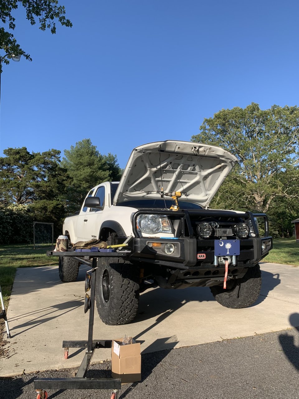

    Getting started on a cowl snorkel on this lovely thirsty Thursday :drunk:3A5EA6FF-AFF1-412D-9533-0C2E8882E2C6.jpg

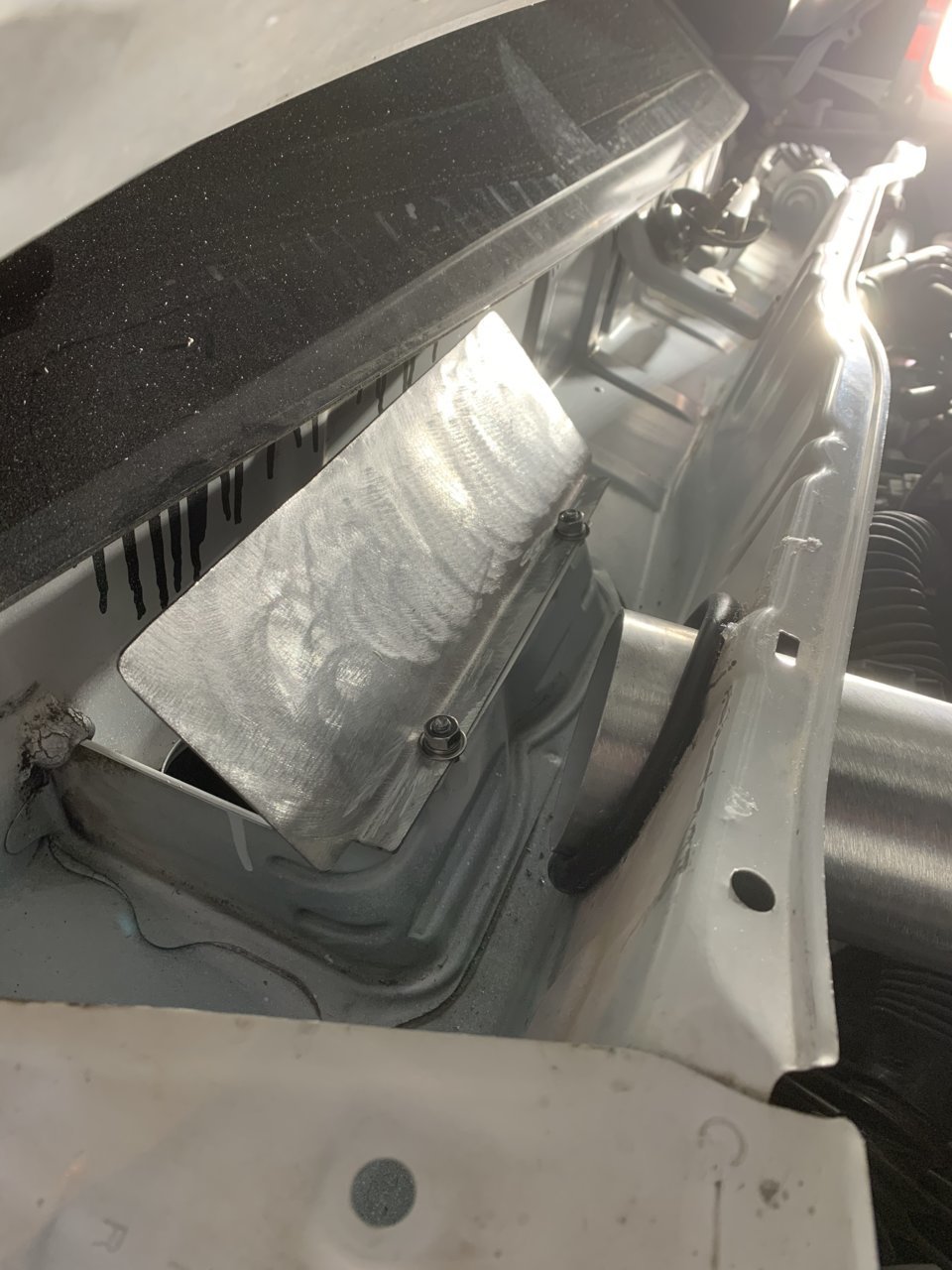

    Made an aluminum divider bewteeen the cabin air and intake. 01831B22-CAAB-4EF1-A958-98B72EB2086D.jpg

    No metal screens over the holes inside the cowl like most peeps do, It’s a pain in the ass to access and the truck is 15years old and their has been no rodent problems so far that I know of. Now to cap this 4” hole from oe intake. . 4” Corrugated landscaping pipe cap from Lowe’s. Bam!

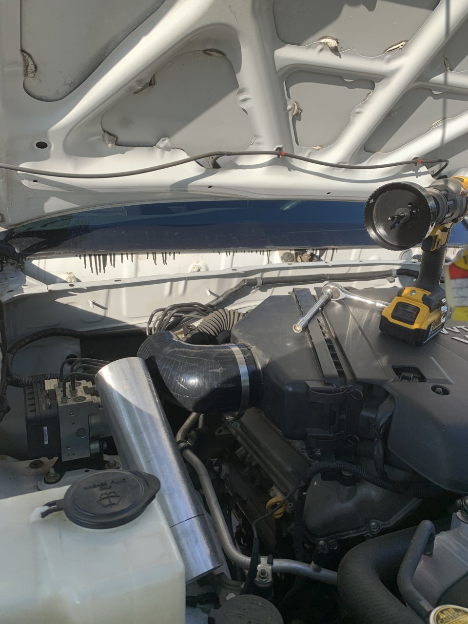

    Also cut a huge ass hole on the passenger side firewall to inside fender to get more air flow.

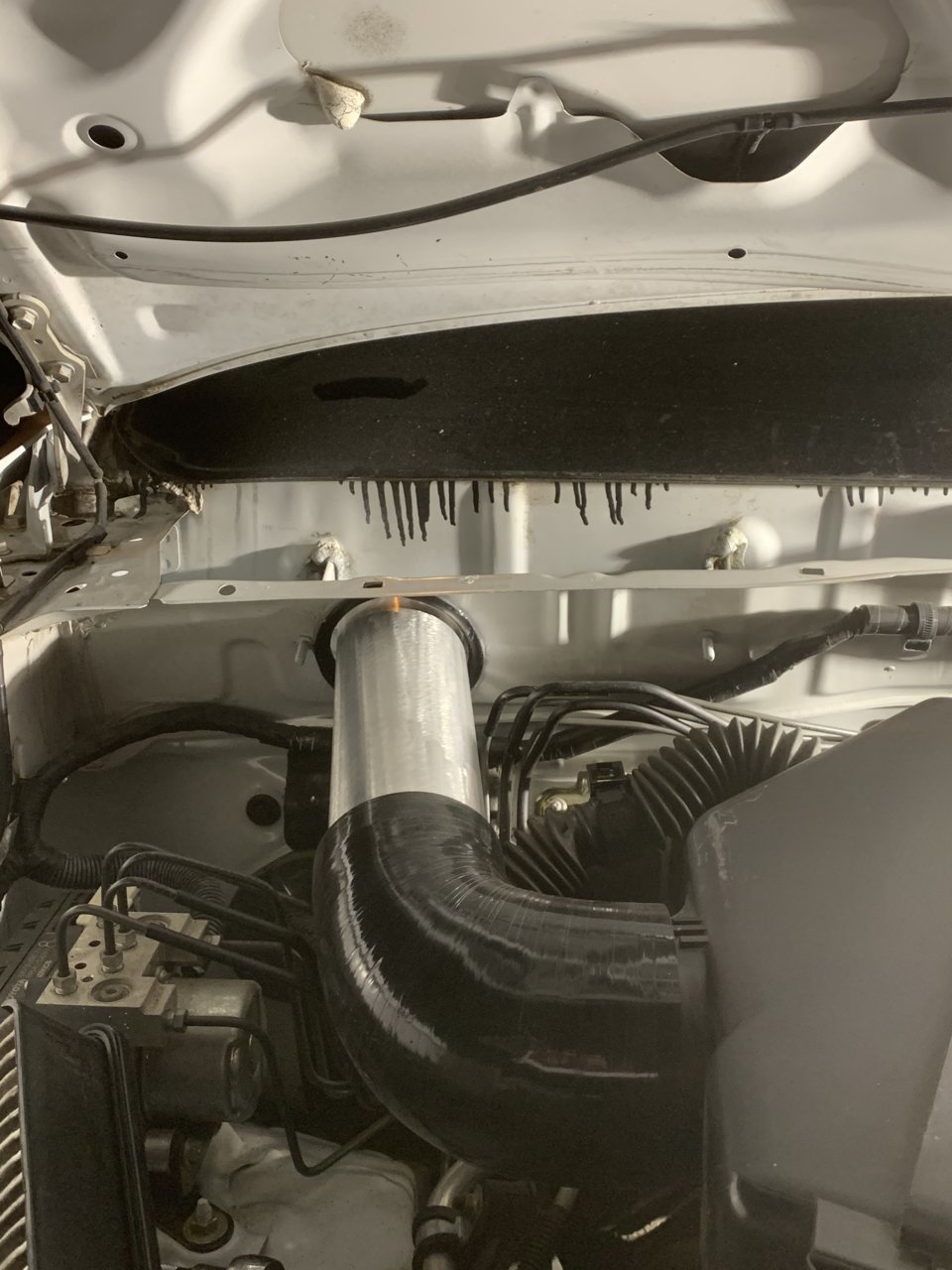

    22775895-2827-49FB-8291-6798F0254A57.jpg Dunzo, room for air compressor now:D

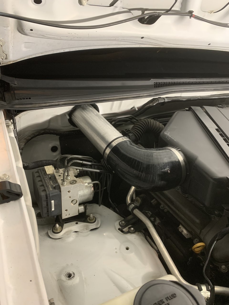

    Just Took it for a ride, only noticeable difference is: taking off from a stop I hear what sounds like a Diesel turbo. There is a whistle. I hear it coming to a stop Too. It sounds good. A normal person would never notice it. Didn’t get to highway speeds but I doubt it’ll be any different.
