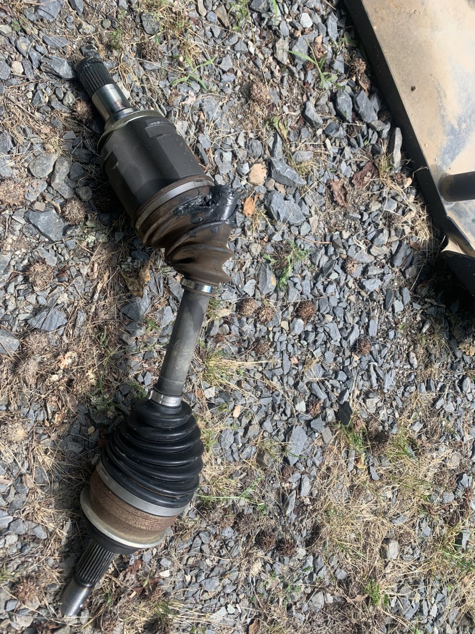

    Cheap replacement CV and climbing up Daniel with a little wheel hop and pop goes the weasel
    Same place @ahspurlock turned his tie-rod into a pretzel.

    I was no where near that spectacular it was much more slow speed. Weak aftermarket axle is what I'm chalking it up to. My factory spare with a ripped boot took much more abuse than this one did. It's all good, I got some much better axles coming.

    No I got in on the JD fab group buy it has a 934 inner joint and 300m shafts reuses the outer joint. But from all the axles granading I've seen and the pics posted on here I haven't seen an outer joint break.

    Yeah I haven't either . Only the inners or shafts them self's

    This one snapped the axle right where it splines into the cage on the inner joint. Weak shaft, I have a feeling if I tore it down there might be some twisted splines.

    Oh I guarantee it spun that shaft
