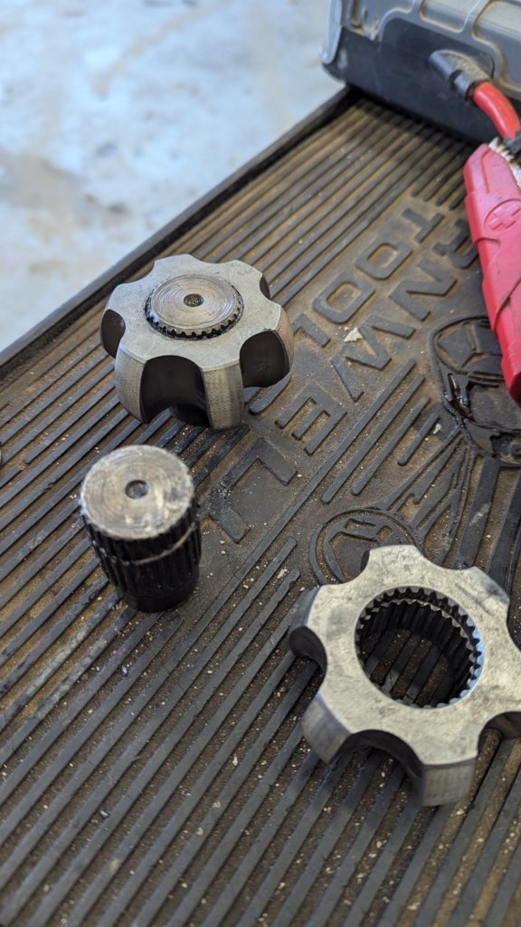

    @colinb17 these are the shafts after cutting them and pressing and drilling them lol

    well that's the worst thing ive seen so far this year......
    if you ever have to do another set, let me know and i'll connect you with the guys at Round Fab. they have a press large enough. they're the only reason i made it to the last day of overland south

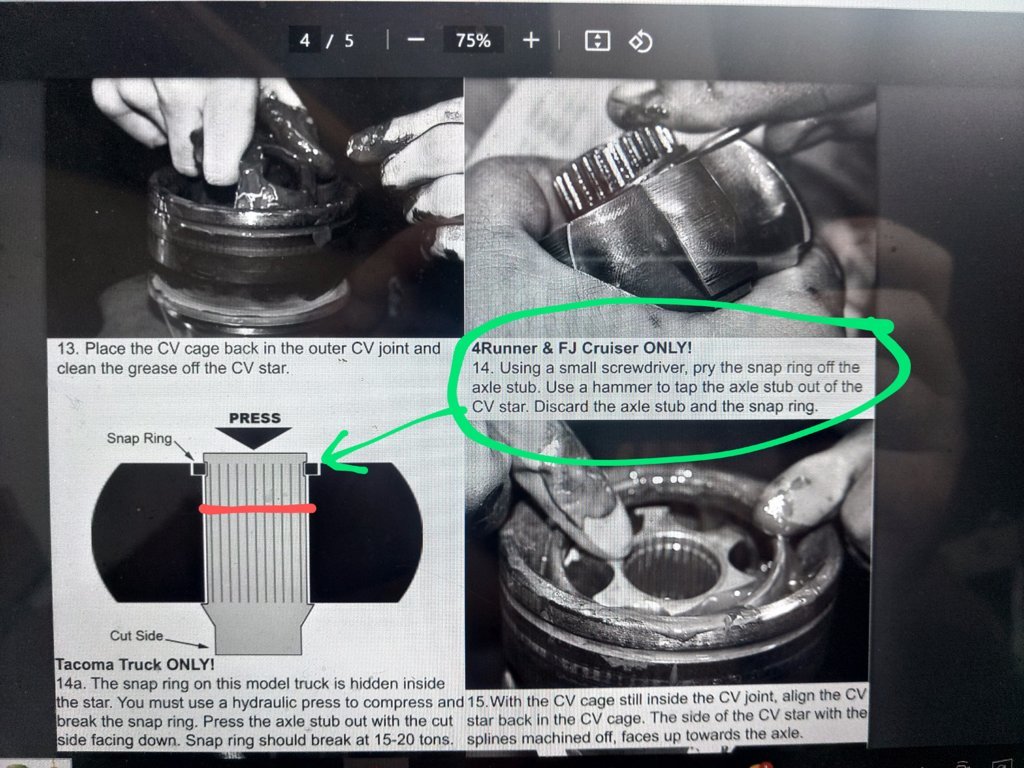

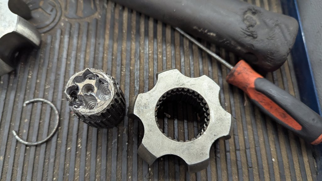

    any chance you have some tacoma CVs in your truck? just referred back to the total chaos instructions, and sure as shit, they call out an accessible snap ring on the 4r and FJ. also just texted my buddy with an 06 4r, and he said he just had the snap ring. no need for a press when he put his new shafts in.
    red line is of course where our rings were....

    Yea my donor CVs were out of a 2nd gen Tacoma.
    My stock T4Rs are still in the T4R so once I get them out I'll have to check that out . Definitely interesting tho
