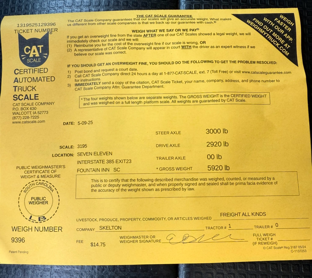

    edit 2: for anyone familiar with weights here's my truck's weigh in sheet from last week. John at Accutune said I was between 650 and 700# springs. This is the truck basically empty with me in the driver seat at ~185lbs.

    another good resource if you're on the fence between 650 and 700 is the total chaos customer service team. I spent a decent amount of time on the phone with them when i ordered the long travel. we spoke about bumper type, skid plates, winch size, and the roll cage design to determine the best starting spring rate. Just tell them you're running their stock length control arms, and I'm sure they'd have a similar conversation with you.

    Awesome thanks man. All good advice. I edited my post above with more information on the truck. Accutune told me I'm between the 650 and 700# springs.

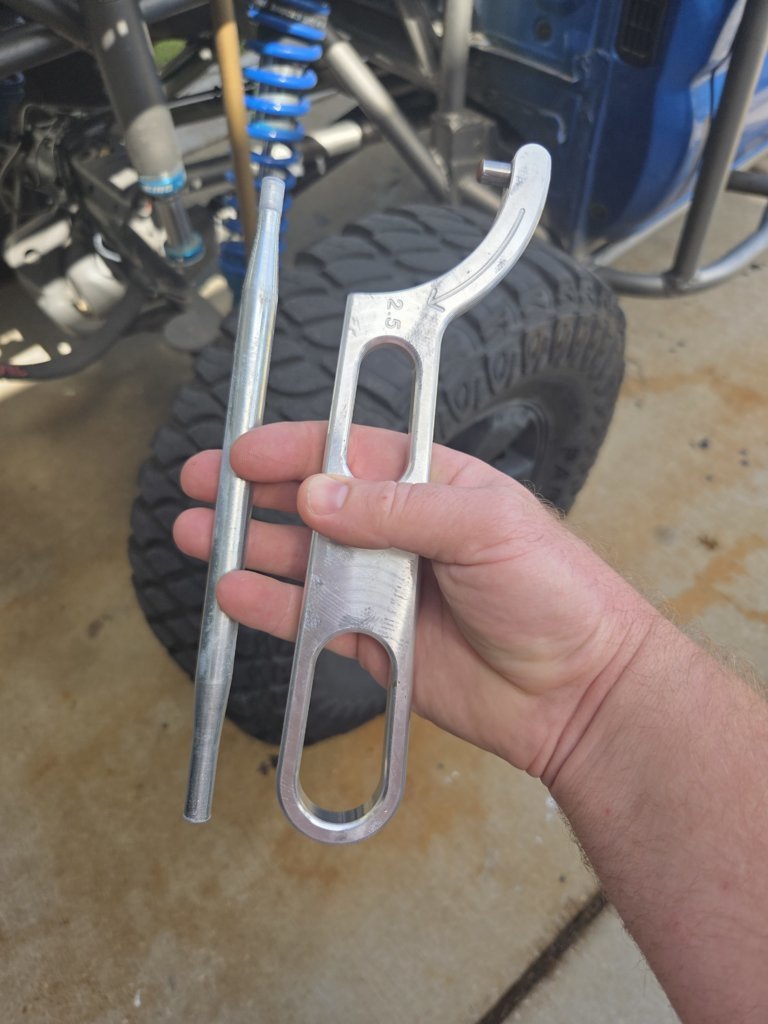

    The 90 degree fitting for the reservoir hose on kings is notoriously a problem to work around when adjusting the preload. Most people end up needing to remove the coiliver to adjust it, but there are a couple of ways around that.
    The risky way is to loosen the jamb nut on the 90 into the shock body, and you can spin the fitting back and forth about a quarter of a turn to fit the spud style collar wrench into place. Ive done it suxcessfully this way, but you risk seeping some oil and nitrogen pressure this way.
    The better way is to make sure you have both spud style and spanner style collar wrenches. You essentially alternate using each one to be able to avoid the reservoir fitting interference. Makes adjusting them on the truck a piece of cake. My guess is that your coilovers will either come with the spud style wrench, or none at all.
    The aluminum spanner wrenchnis available on Amazon or through kartek. Typically cheaper on kartek though. Make sure to get the spanner for 2.5" shocks, not 2.0
    Over thee course of your trip, your springs will definitely settle, so it'll be important to be able to djust them, maybe even a few times, during your trip.
