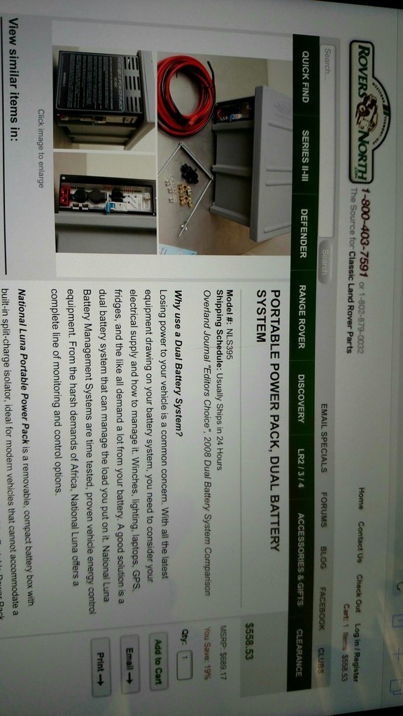

    c8fc4871df7fc876e8f64754ec9e55bf_6876e42a59397a36f542bcfddfcf86cd5e85fafb.jpg so I'm looking into something like this but for a lot less money.. Anyone know where other options can be found? Even thought of custom building

    Decent Idea but unless you dremel a little hole in the end of the slot the frame will eventually crack and cause way more issue than welding a resi mount on the frame.

    Very true but others have done it so assumed would be fine

    I have never seen it on a 2nd gen Tacoma, 1st gens will do it and Jeeps do it bad. It is just how metal works, if there is a sharp point and the frame starts to flex it will start to crack around that point. Honestly if I wanted a quick and easy solution for something like a resi mount, I would just drill and tap the frame and bolt a set of clamps to the side of the frame. I might have some pictures of one I recently did, if you guys want to see how.
