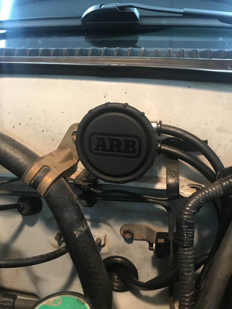

    bah! diff breather extension mod on rear. 3rd gen has one for front diffs it is located about mid fender height. if you are deeper than that......troubles

    I need one of these

    This is the kit

    Holy hell that's an expensive diff breather. You can make your own for like $20 or so all OEM minus the tubing

    Zach doesn’t believe in cheap!

    Well if it's all OEM is it really cheap???

    This
    i dont know if it was even $20.... diy when possible

    Ok so never knew a diff breather kit existed, always just extended lines and added a couple of loops for an air lock. Just looked at ARB kit briefly and my redneck analysis is;
    Kit makes for a clean, common termination point for 4 vents. Would make checking vents for puke quick. Has a filter but Im not sure if volume of return air on cool down warrants a filter. Biggest pro is really ease of maintenance. Con is $70, but hell I bought weather tech floor mats!!! Personally Id like to see a bellows kit like the ones on can am atv's if it's possible.

    On diff breathers, even when extended, one must check diff oil and condition after a ride with water crossings. Capillary action can and will pull water past axle seals eventually. Saw it many times on atv's and sxs's. Oil dosnt leak out but capillary action pulls water past seals as the diff cools in the water.
