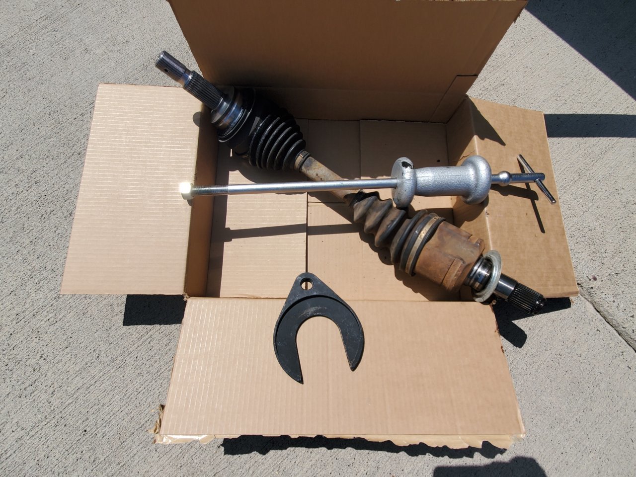

    Anyone have any tips for a stuck CV axle. I've tried pry bars (both prying and hitting), but can't seem to get enough bite. Tried a slide hammer too but it just won't budge.
    Going to try and rotate the axle a bit today in hopes of re-aligning the c-clip. Might look into the cable/hammer trick if that doesn't work. Any one have any other tips?

    I have the C4RS cv puller but haven’t used it yet. Others swear by them.

    I've given it some gusto for sure. So much so that it's starting to gouge the tulip from the slide hammer and slamming pry bar methods.
    Hoping that rotating the axle works this afternoon. If not, I'm going to look into a cable method similar to the C4RS idea.

    Rotating the axle usually does the trick. I have to replace one of mine as well.

    Had to do mine twice recently to fix an axle seal. Just be patient rotate it a little, give it a try then rotate it a little and give it a try. might have to go around a few times before you find that magic spot but it'll pop out eventually.

    O and it can also help to keep it horizontal

    Thanks guys. I'll keep at it.
    Worst case scenario I figure I'll just cut the boot and remove the tripod joint from the tulip. I figure that'll help take the weight off and give me a better spot to get 3 jaws on for the slide hammer.
    At this point I'm thinking I want to throw this aftermarket piece of shit in the trash and put an OEM one in anyway...

    Took a few days, but prying/beating the CV axle wasn't working. Took some extra persuasion from a slide hammer and CV removal tool, but I finally got the fucker out...
