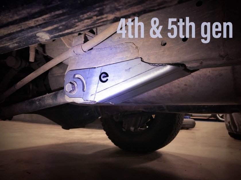

    Those look...healthy.
    Ive been looking at RCI's bolt on skids.
  10. Nov 27, 2021 at 4:17 PM
    #2890
    SearArtist
    SearArtist GX poor
    Jan 5, 2016
    #174151
    18,968
    NC
    GX470 & GX460
    Things
    yeah. I’ll have to wait and get the sliders on first. The ubolt on the slider will probably interfere and those plates will need to be modified some

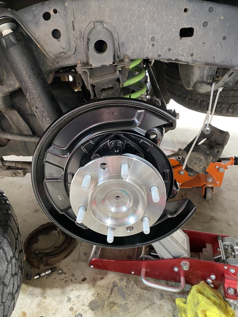

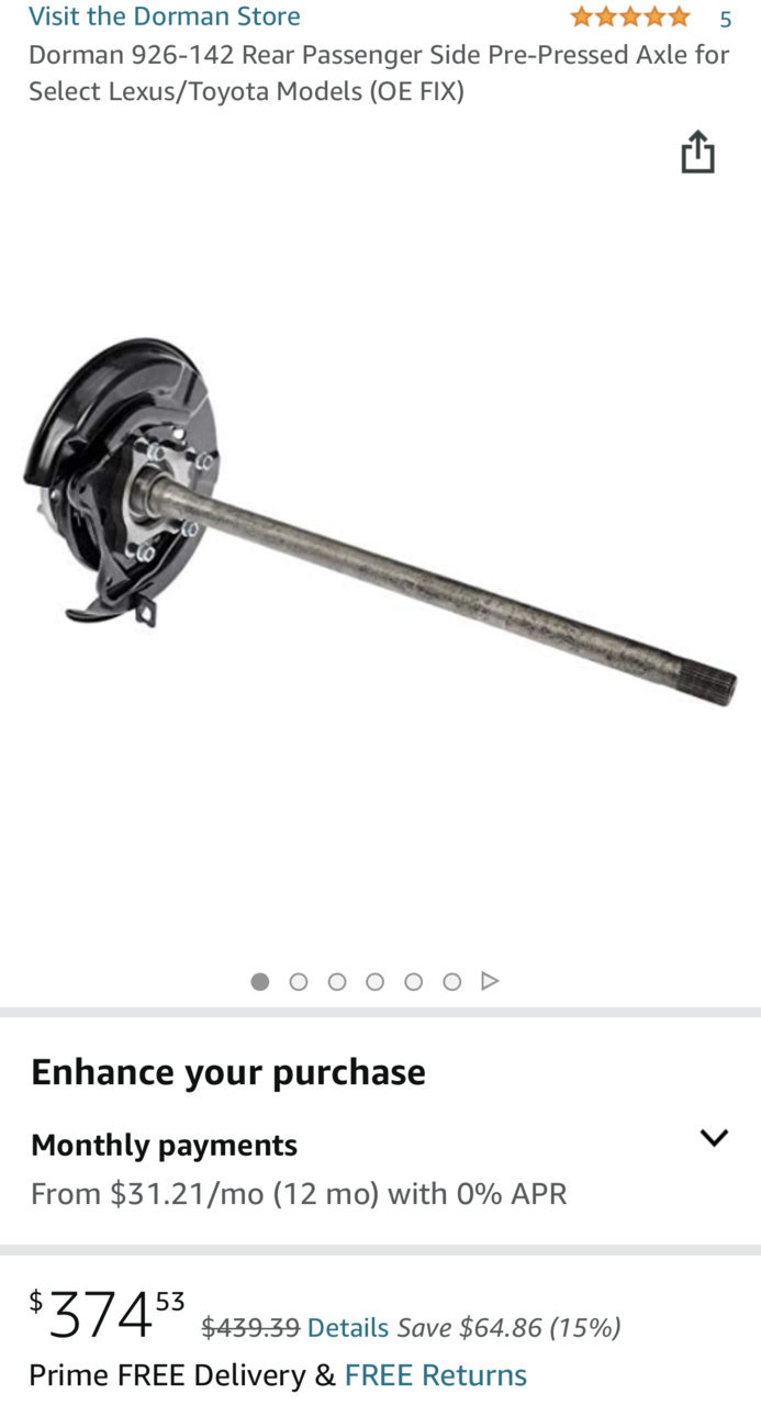

    6MT too. Fiancé's car…
    I was having a ton of rotational noise from the car. It was diagnosed as wheel bearings.
    Had two quotes for well over $1K.
    Ended up buying these Dorman Pre assembled axles. Comes with the axle, dust shield and bearing pre-pressed together. They also include the axle seals as well for about $400 each. Also did new rotors, pads, shoes and calipers for a total of less than $1K and half a days work.
    Anyone with rear wheel bearing noise, I highly recommend these
