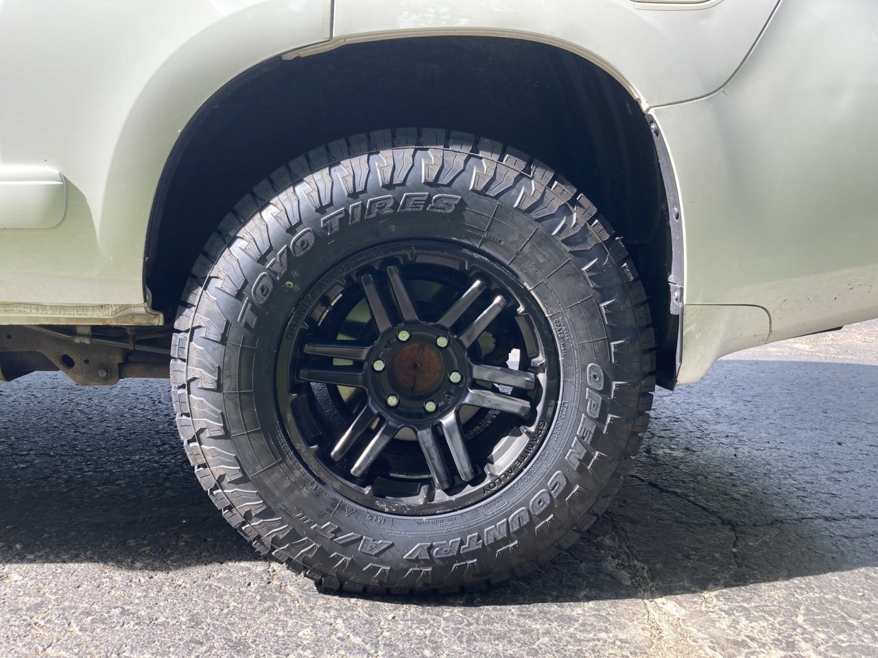

    i have these cheapo tirerack specials. they work for what i wanted and if you're just looking for cheap black wheels, but kinda wish i woulda sourced some plain steelies

    they came with center caps but they have some silly logo on them, so i run without.

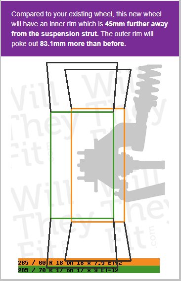

    Might be an idiotic question here, but a 9" wide wheel shouldn't rub any more than a 7.5" wide wheel so long as they have the same offset, right?

    I guess it depends on the offset, and you could get lucky. But say you have a 0 offset wheel, you’re going to add .75” of width in either direction from the center of the wheel.
    That’s why different widths come in different offsets, too wide and too positive and you’ll rub suspension components, too negative and you’ll be clearing the fender well for days

    Seems like there's an aspect of it that's just "go for it and hope for the best," which is contrary to my over-research to the point of mental exhaustion mentality...
    The wheels I'm looking at are 17x9" with -12 offset. Hoping this would work on 285/70/17 Toyo AT3s with the Ironman FCP kit (using their UCAs) with minimal rubbing.

    Thanks-- That visual is amazing, and I always forget that site exists. For some reason offset/backspacing is like the one thing that my brain just cannot compute. The visual helps a ton.
    So I guess the follow-up question is more about how wheel width would affect the potential for rub given the same tire size, wheel diameter, and offset. Say, a 17x7.5" wheel vs a 17x9" wheel, both -12, and on a 285/70/17 tire. My brain sees is as "tire is the same size, shouldn't it rub the same regardless of wheel width?" Any thoughts?
