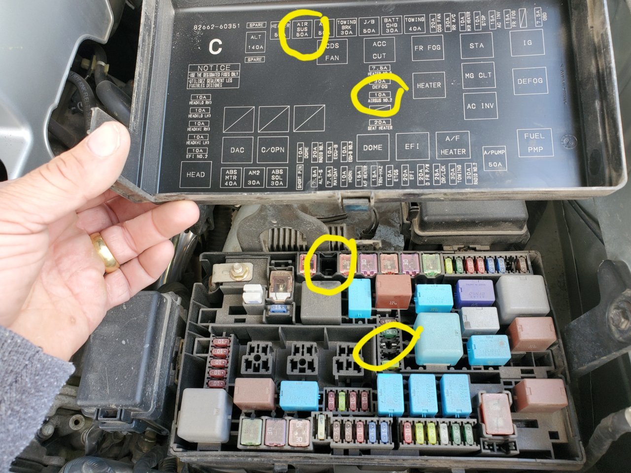

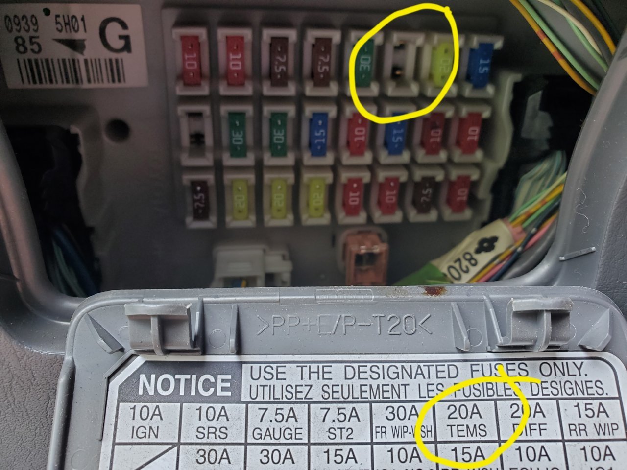

    Another weird thing about those superseded ECUs. Some GXs that install a lift kit, even when you pull the air suspension relay and fuses, the "OFF" light keeps flashing. This is the issue with mine, even tried the zero point calibration. His GX with a lift kit, all we did was pull the relay and fuses and he doesn't have that flashing light. So I have a feeling the newer ECU doesn't look at TEMS.

    josh
    Monroe, NC
    2006 GX470
    My "off" light flashes as well and everything has been pulled. I guess im in that group.
  10. May 30, 2022 at 12:15 PM
    #3390
    klavender1
    klavender1 Well-Known Member
    Sep 8, 2015
    #163705
    2,652
    Columbia/Lugoff, South Carolina
    2005 GX 470
    Well maybe my theory isn't correct then since you have an 06. If I pull all the fuses, I get all kinds of lights. I have to leave in the TEMS fuse to only get the flashing "off" light.
  11. May 30, 2022 at 12:49 PM
    #3391
    Gen1FTMFW
    Gen1FTMFW Well-Known Member
    Feb 20, 2017
    #211192
    2,710
    2000 Tacoma 3.4 TRD "Stock AF" & 2006 GX470 Sport
    Weird. Fuses/Relays removed and everything works as it should, no lights...
    klavender1 likes this.
