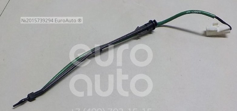

    Finally figured out my A/C issue. It was the evaporator temp sensor. I did my best to test it but it was a guess when I did. You're supposed to remove it from the evap box and measure resistance at ambient temp. We can't seem to remove the little $3 cover that holds it in. But plugged in the new sensor and it runs perfectly. Which brings us to the next problem. We can't seem to remove the little cover that holds it in place. We aren't sure how it comes out. Don't want to break it. I ordered a new cover along with the sensor Friday but the cover is discontinued. So I'll spend some time searching for a Toyota/Lexus dealer with this in stock before we go ham on the old one.

    Glad to hear you got it figured it out! I can't help the issue with the cover however. Are you 100% sure the cover is the only way to get the sensor out?

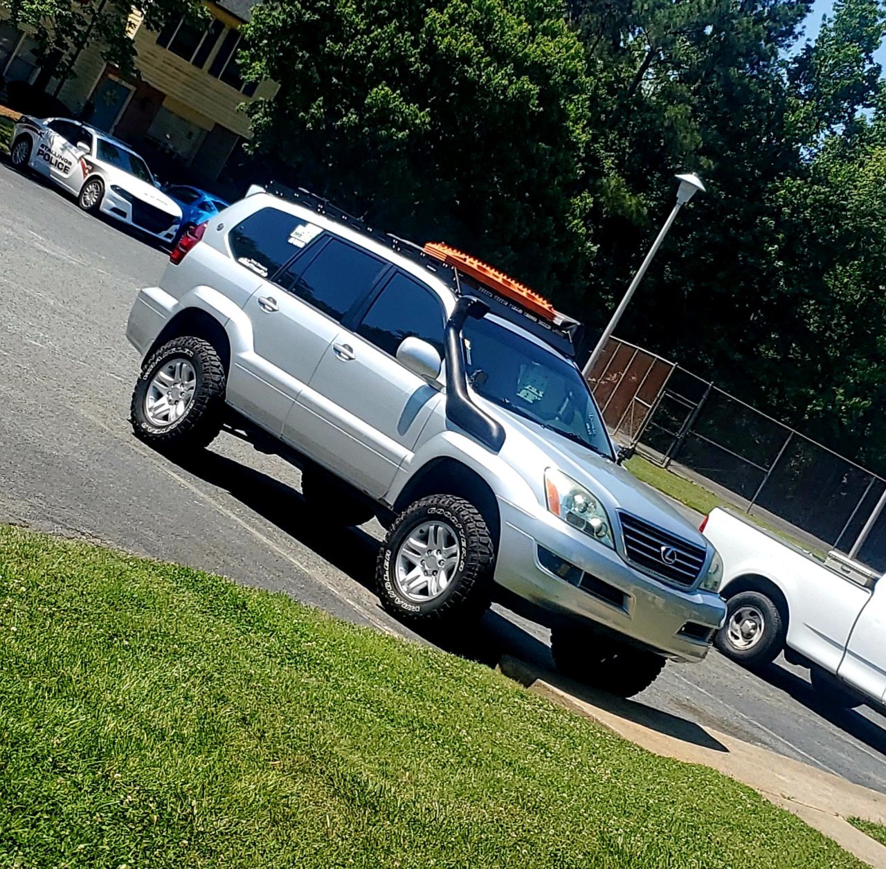

    I took off work all week to watch my daughter( couldn't find a sitter) so I got out early this AM and did a little fine tuning to the snorkel and changed the mounting for my Maxtrax in prep for a few roof boxes. Had to drill some holes to get things lined up but wasn't difficult.

    Yes unfortunately.
    This in the only photo of this "cover" I could find. From a Russian used parts site. The green is the sensor wire, the black plastic is what holds it in. I'm assuming the curve puts the sensor up against the evap fins to prevent it from icing over.

    hope you don’t have to end up pulling the whole dash…

    Hope not. Even if it breaks those tabs holding it in, we can always just silicone or FIPG it to hold it in place.
