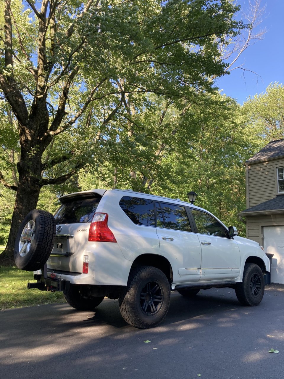

    got my Wilco hitchgate Switch on. besides being overpriced IMO - this thing is great. nice welds, good powder coating, actually very easy to operate. this "Switch" model sits closer to the body to eliminate most peoples complaints about the wilco, which is that is sticks out so far. happy to be able to carry a full size spare again

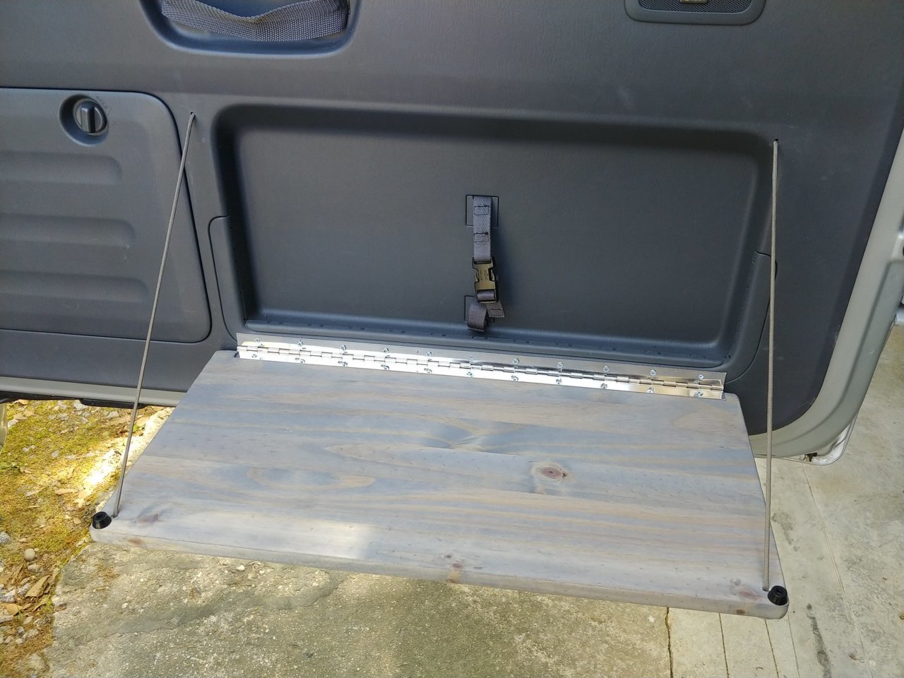

    That's why I did. Cost me a few bucks for screws.

    How'd you mount it on the back?

    That paracord is only 1 piece, it goes thru the plastic to the other side. Then just screwed the piano hinge into the plastic. Fairly sturdy but I probably wouldn't put a ton of weight on it.
    And folds up like this:
    [​IMG]0404211216a
    I drilled an extra hole in the washer to keep it closed. I really didn't like any of the latch systems I saw for those DIYers. The paracord stretches a little so you can pull it tight against the door.
    [​IMG]0404211217
