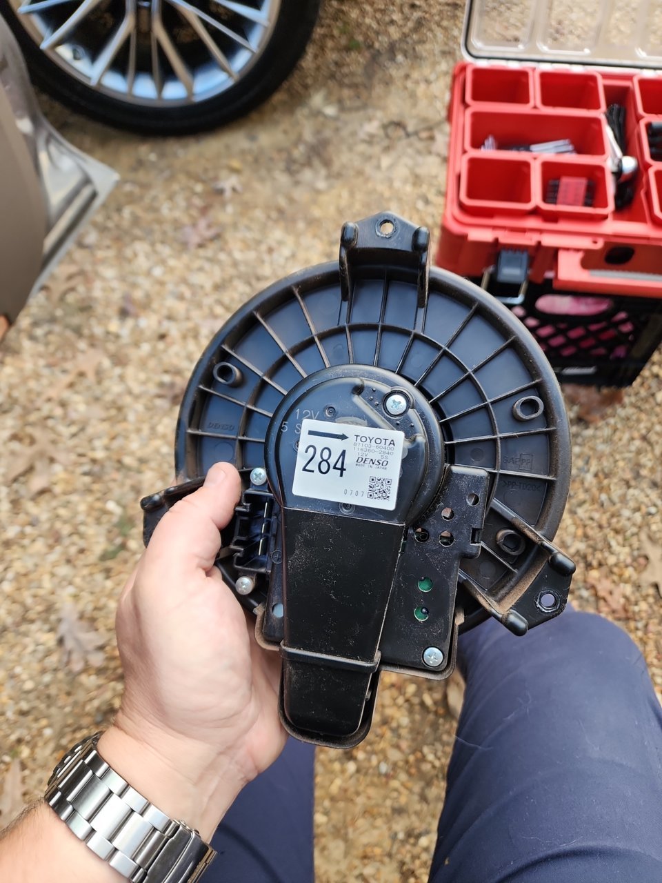

    My gx was squeaking terribly this morning after I washed it. I thought a pully was going bad I was super stressed about it. I tried some sprays and such on the pulleys... Nothing... I watched a video and they explained that if you put water on the belt and the squeak stops, it's not a pulley. So he used a 303 cleaner that's for vinyl and rubber. I found the equivalent in McGuire products at Vass pro. As soon as I sprayed it on the belt, the squeak stopped! Praise the lord

    Today was figuring out and learning about the AC. Sometimes it would and wouldn't blow air at all.

    I would ask if you have a giant mouse nest in the blower fan but you would have noticed that. Also you need a packout milk crate they are amazing

    I need to replace the blower motor in the 460...is it a bitch to get out? Ours makes a horrendous clicking sound on low speed.
