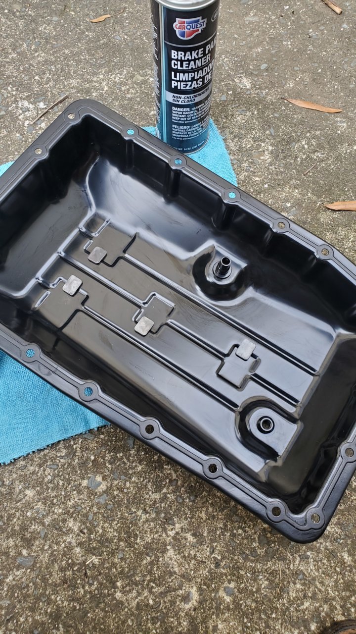

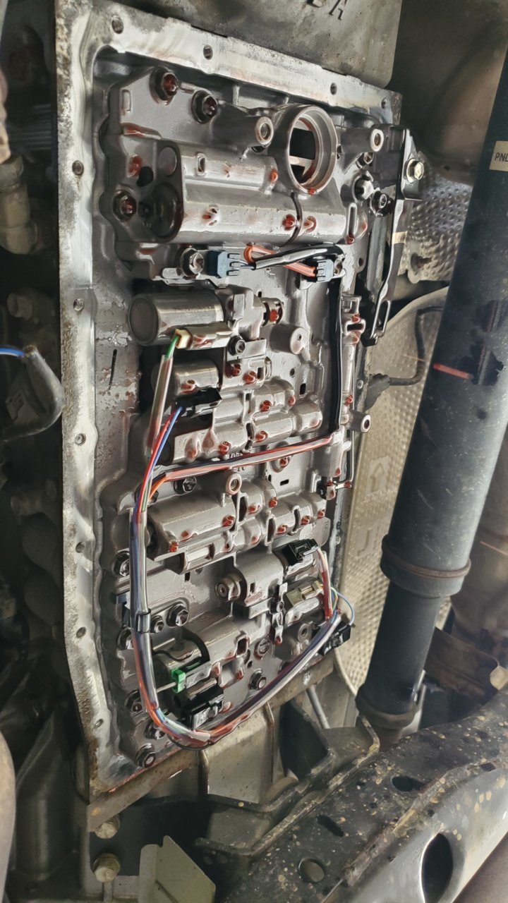

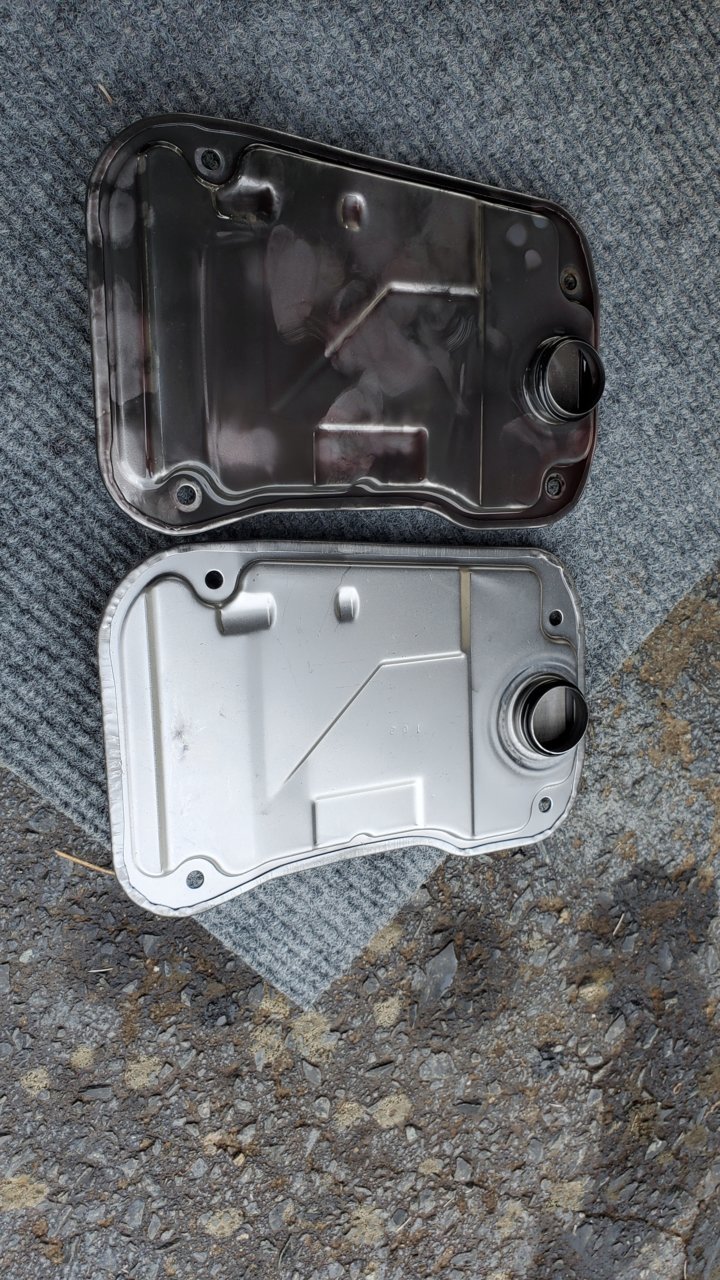

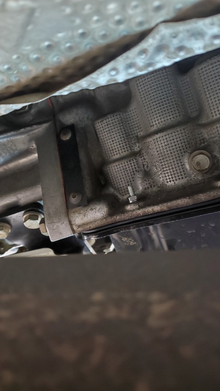

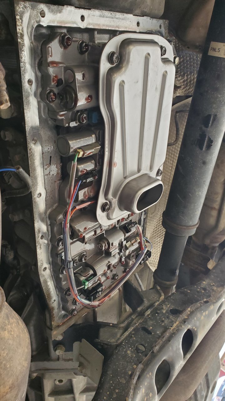

    20221217_114841.jpg Alright well I dropped the pan and changed out the filter. The filter was original as far as I can tell and was nasty AF. The magnets were covered in very fine material but no big pieces of anything. It went relatively smooth apart from snapping 2 pan bolts.
    So I did the right thing and drilled them out and thru bolted with some grade 8 hardware.
    Old filter on the left.
    New filter installed.
    Pan and magnets cleaned
    Drilled out the snapped bolts and Thru bolted.

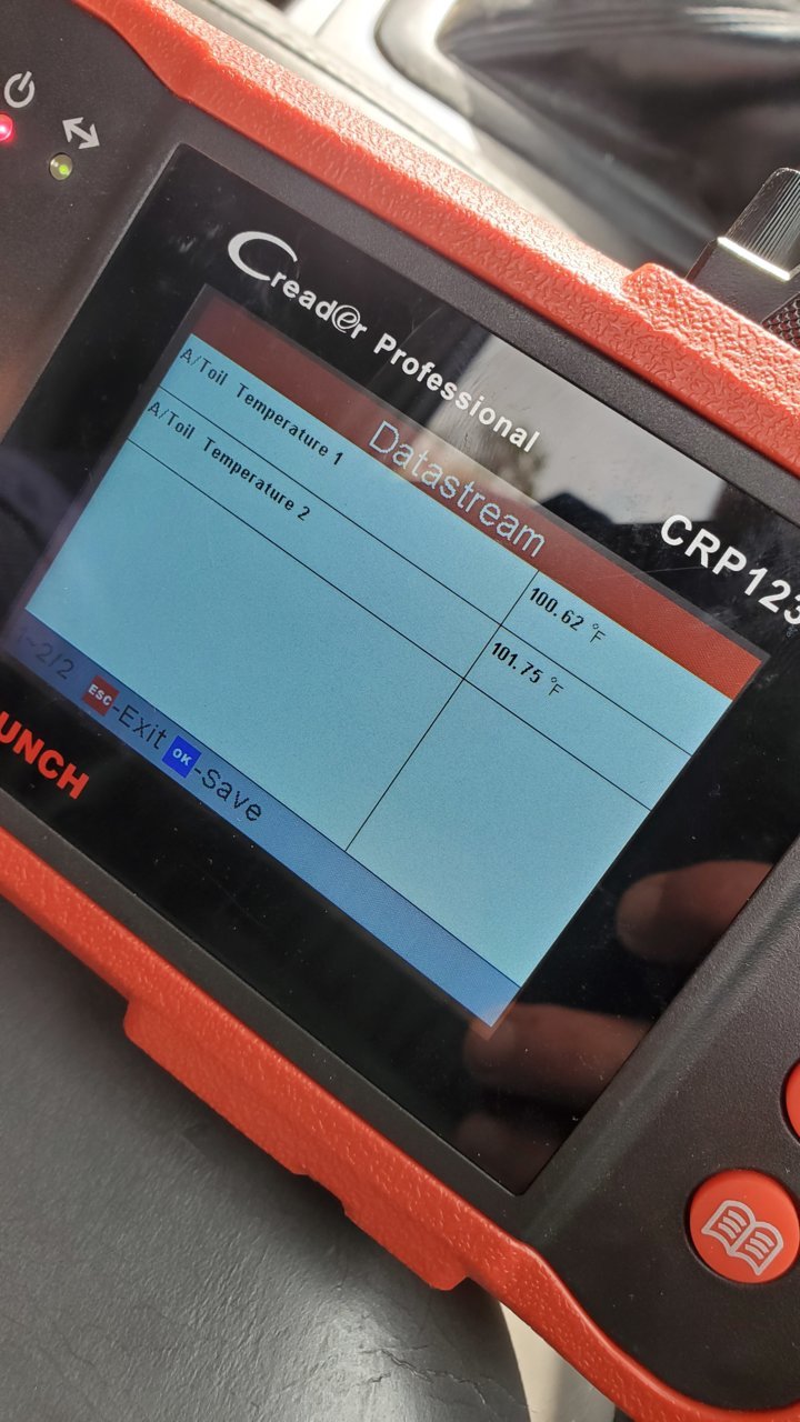

    6qts of fresh fluid along with another 10oz of Lubeguard.
    Checking temp with the OBD scanner
