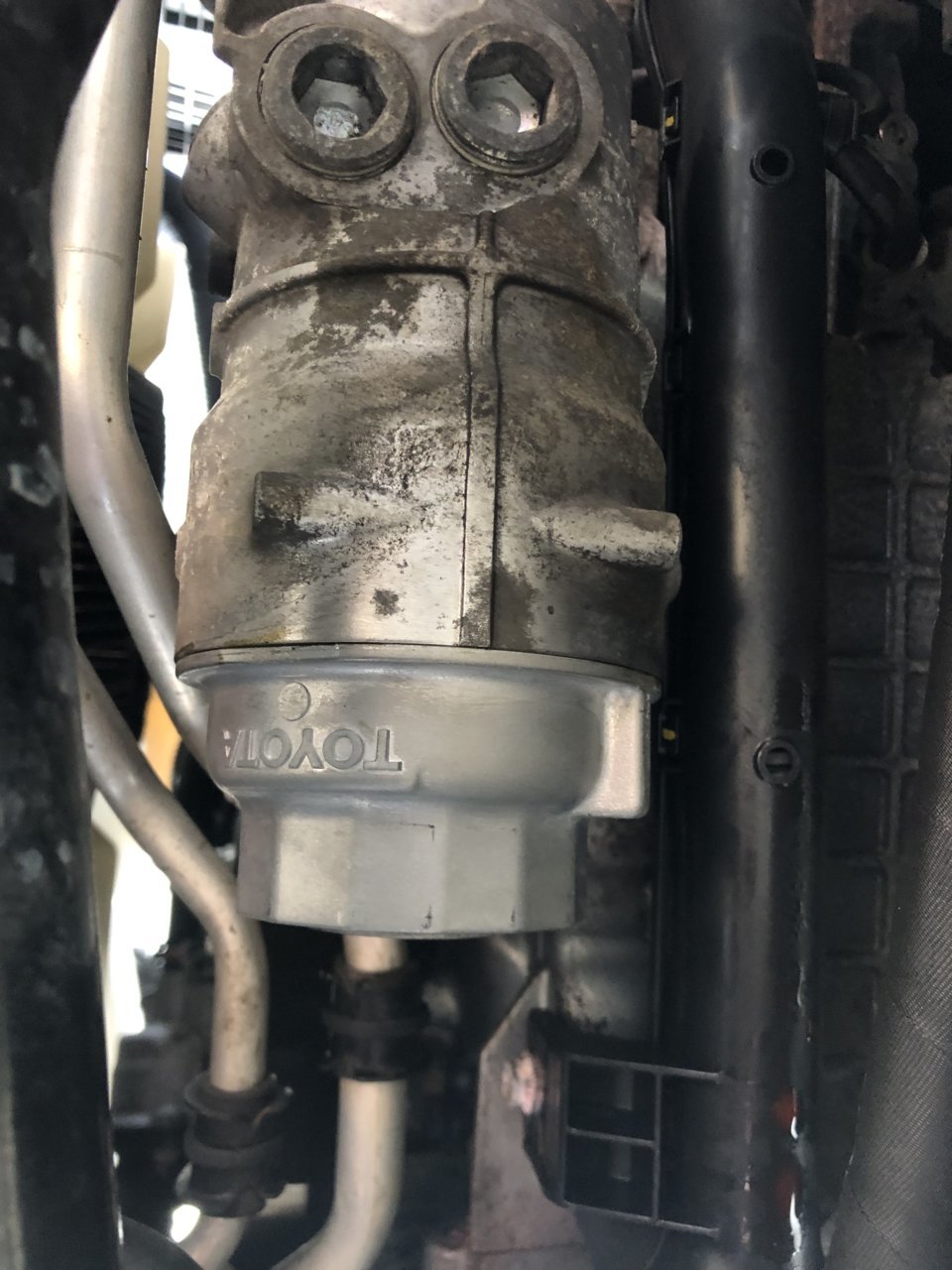

    Who ever decided the filter placement on the 2UZ needs to be stoned. I'd rather replace a CV than change oil and it's all b/c of the damn filter.

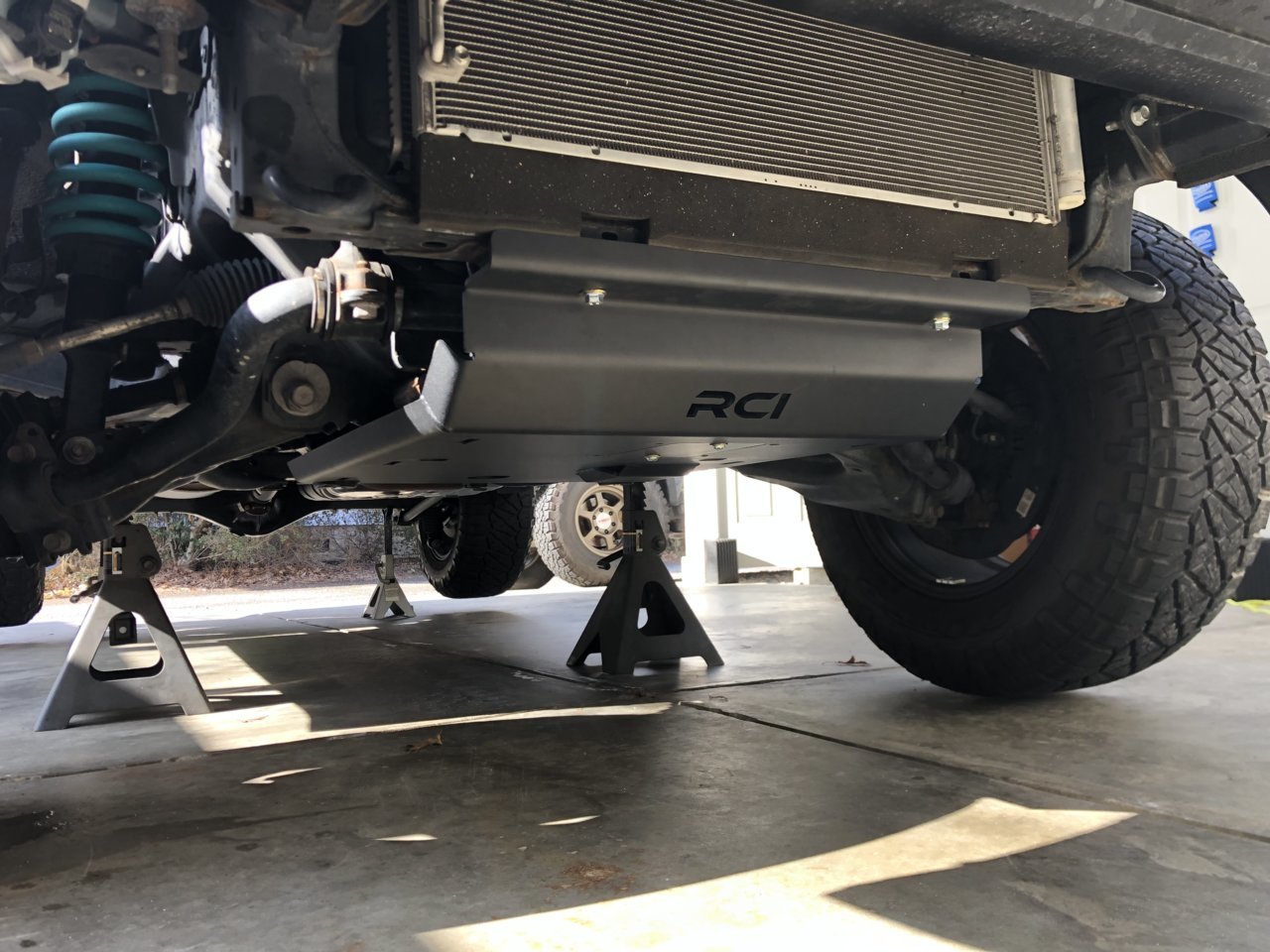

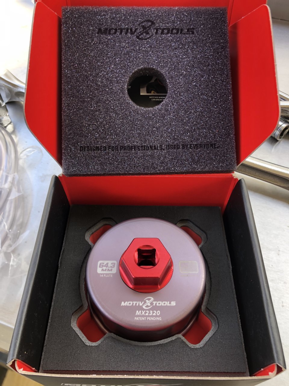

    First diy o/c since Lexus covered the first few. Did a couple mods to make it easier next time. Also, 10k interval and oil definitely wasn’t too bad or burnt. Refilled with 0w-20 mobil 1. Lastly, this oil filter tool is way too good looking lol

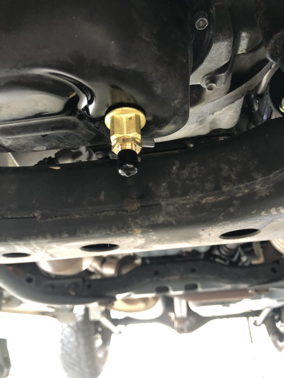

    Since I have RCI skid plates, I took a gutter drain tube, cut a side out and use that to redirect the oil from the filter. Works pretty well. That and a Fumoto valve for the drain plug.

    Will have to do that in the future, just installed the skid today so I had all the room in the world with the OE stuff out of the way lol
