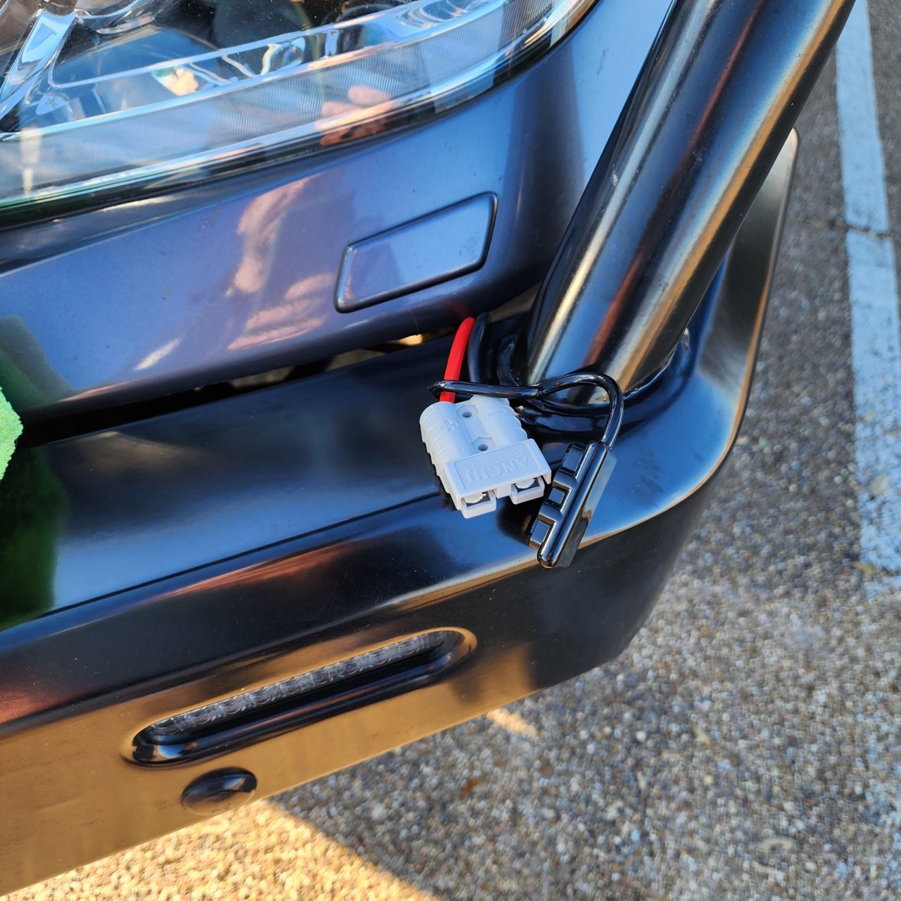

    codyjphoto
    codyjphoto Well-Known Member
    Jul 10, 2021
    #370931
    1,317
    Cody
    2015 gx460
    A bunch of junk
  14. Jan 10, 2023 at 12:42 PM
    #4014
    jlemmond
    jlemmond Well-Known Member
    Nov 15, 2019
    #310790
    3,019
    josh
    Monroe, NC
    2006 GX470
    Anderson Plug.
    codyjphoto[QUOTED] likes this.
