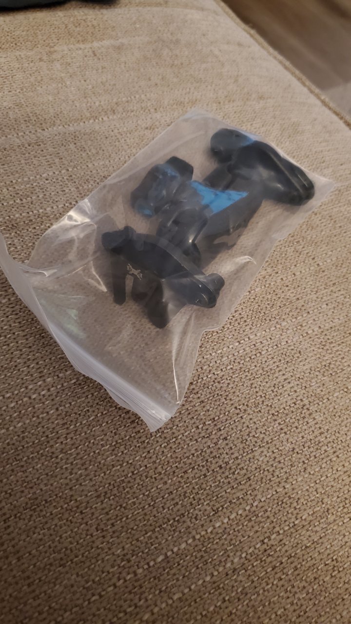

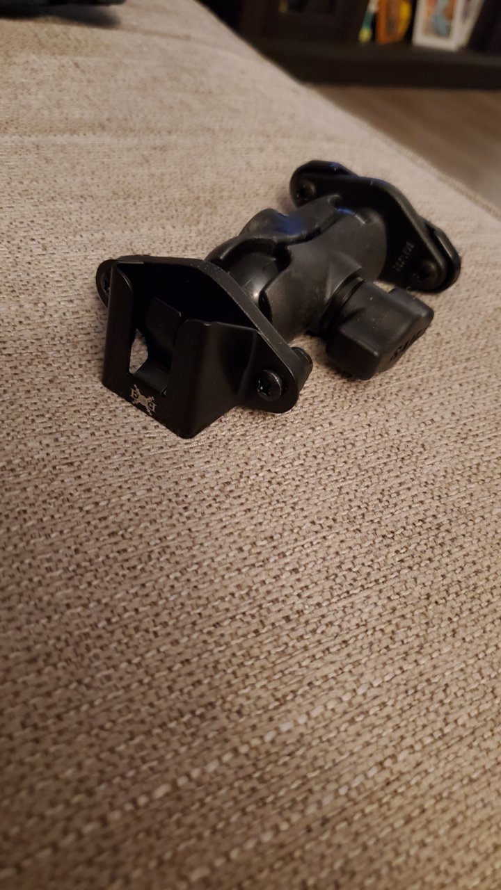

    Expedition Essentials mic mount on a Ram Ball. Still in the original packaging brand new. $20.00 and you pay for the ride.

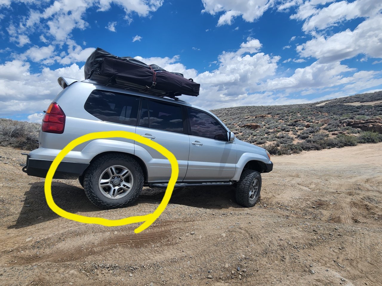

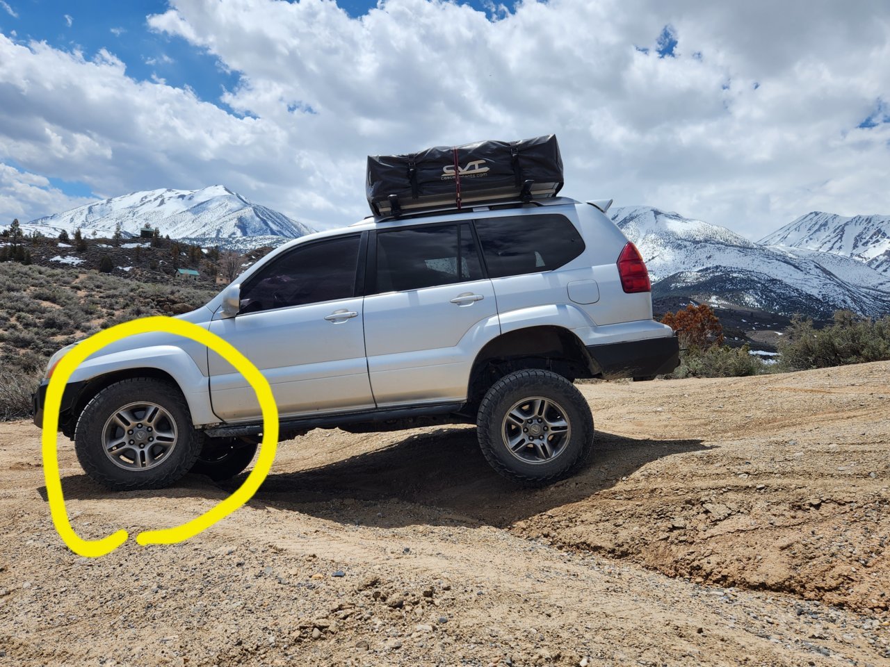

    Anyone on here have a CMC? Trying to decide if this is aggressive enough or if more relief is needed...

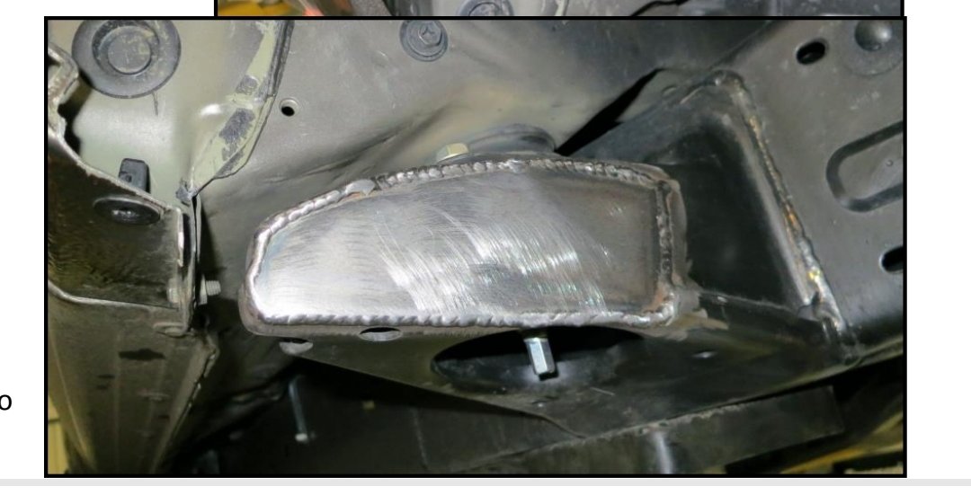

    you need to replicate the below. It essentially gives as much clearance as the relocation kits do.
