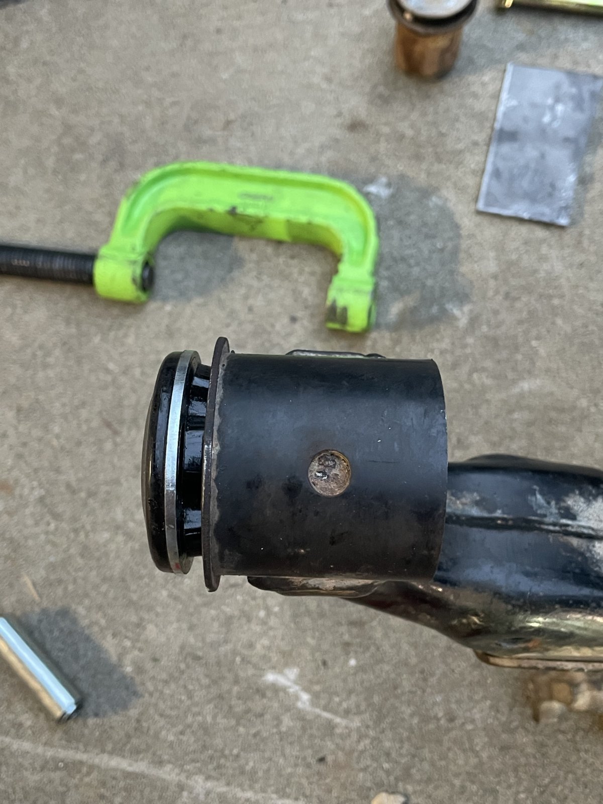

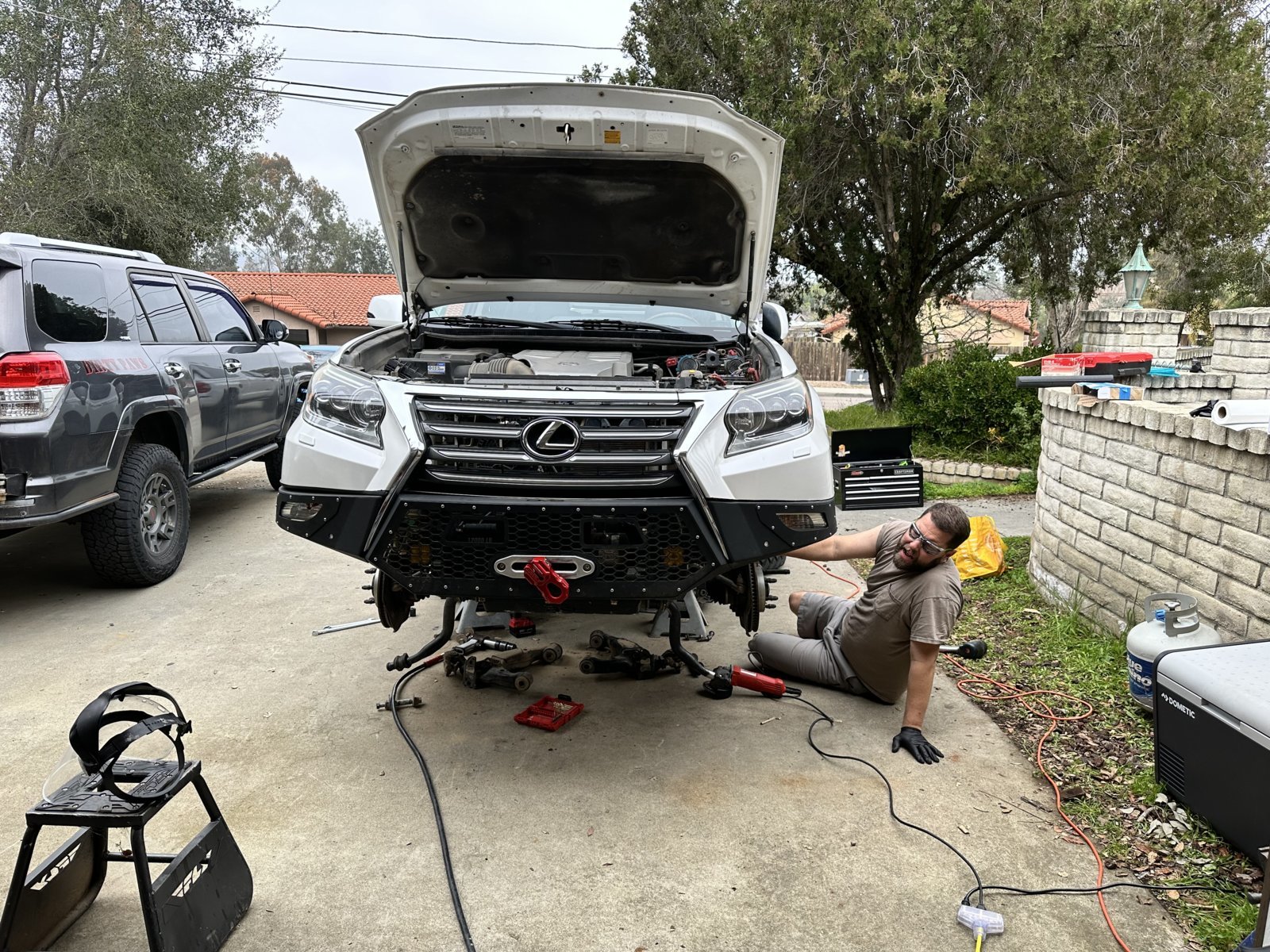

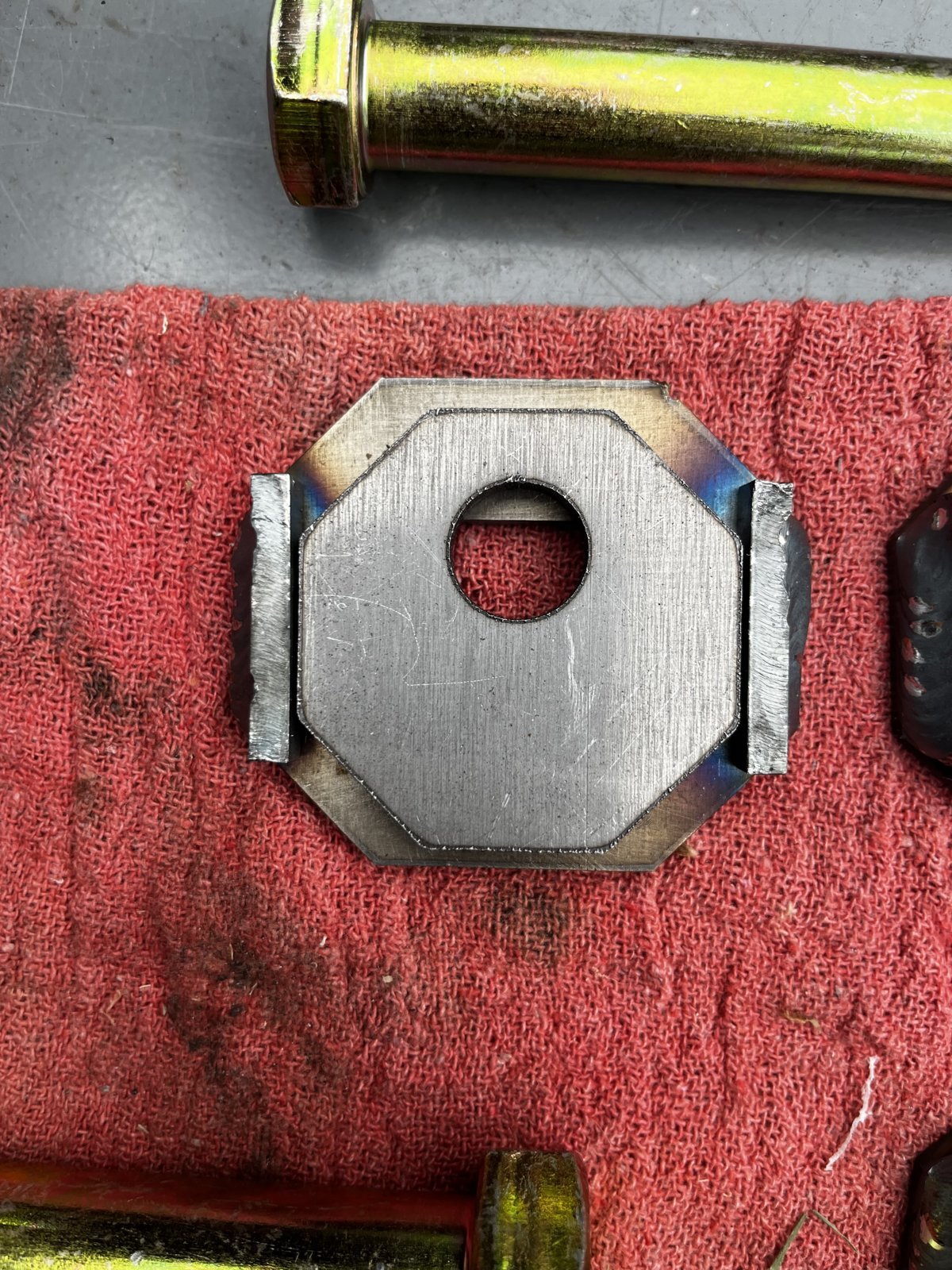

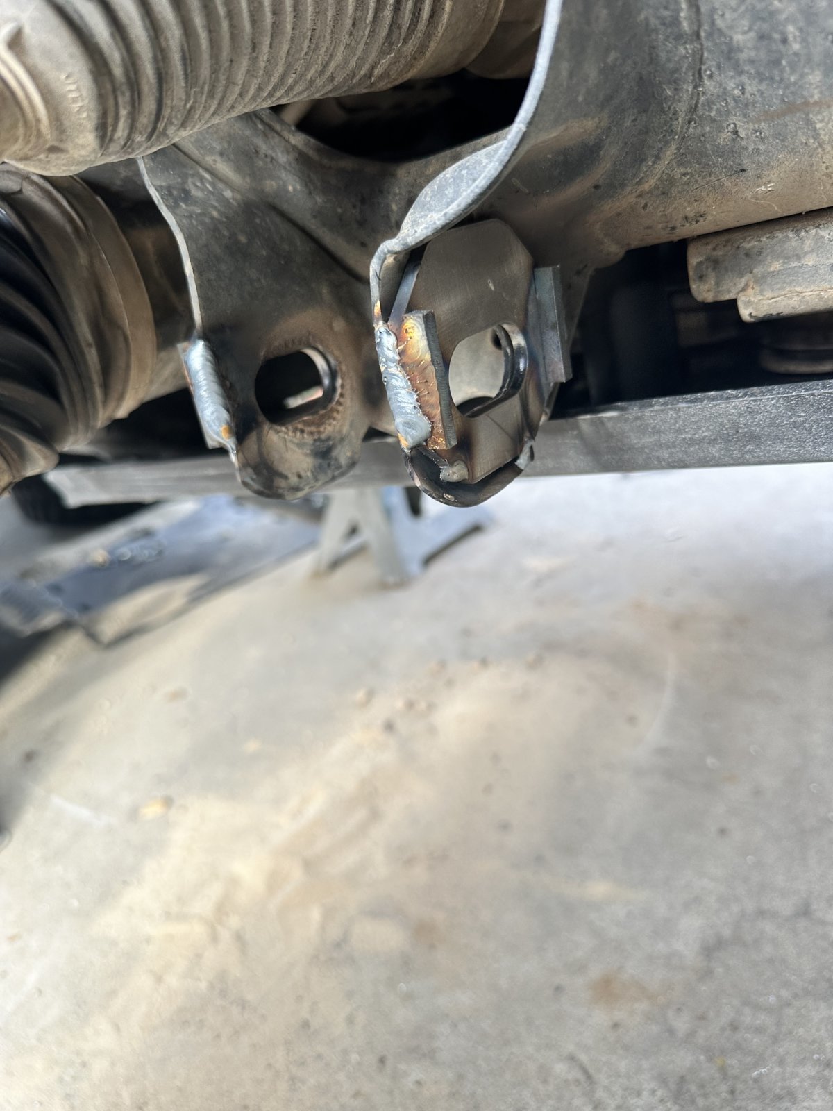

    Last weekend I got my LCA bushings replaced with Whiteline poly. One of the stock bushings came out without the steel sleeve and it gave me hell for a few hours until as a last resort I took a sawzall to it with a fresh diamond tooth blade. After just a few swipes it was through. Then I was able to drive a small chisel under the new lip and begin breaking the rust weld. Got it done without marring the LCA surface. Picture of me trying to force the bushing in before I realized the sleeve was still in there.

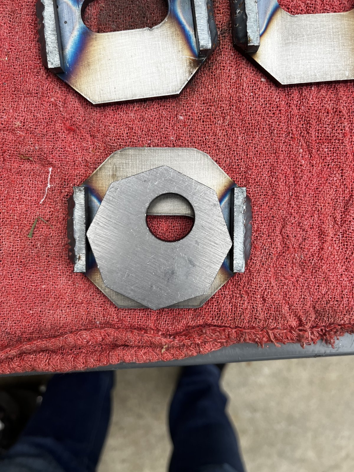

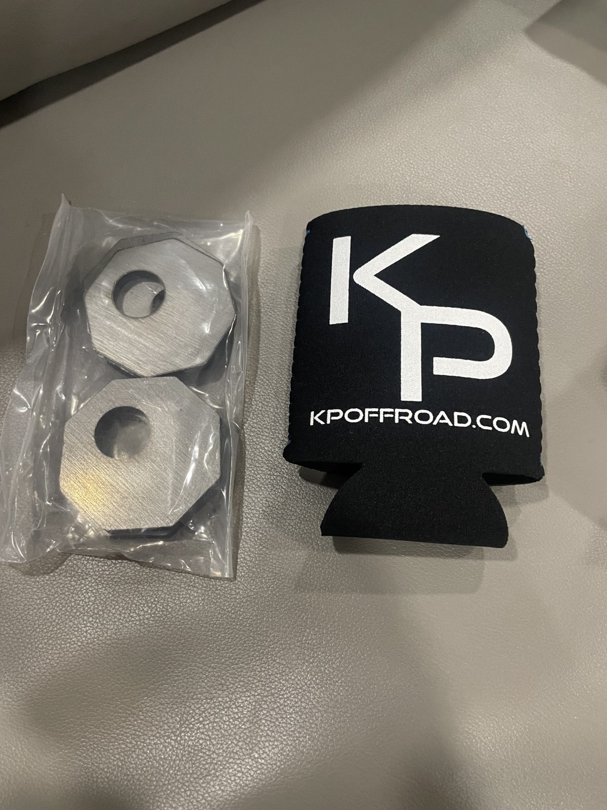

    The KP Off-road octagons were straight forward, until I discovered they sent the wrong size for the rear. I put the OEM bolt & cam back in to get me home. KP Off-road answered my Sunday morning email within minutes and I had a tracking # Monday morning. An honest mistake made right, I respect that. Wednesday I had the correct octagons and a fancy magnetic coozie for the inconvenience.

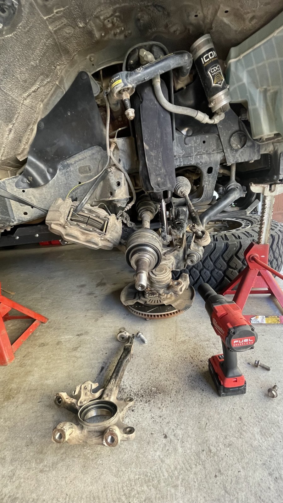

    Alignment shop confirmed the spindle is bent :annoyed: Ordered a new driver side one today and took off the passenger side after work. A local fab shop makes spindle gussets & will zap them on as well. So that’s gettin done next week :welder:
