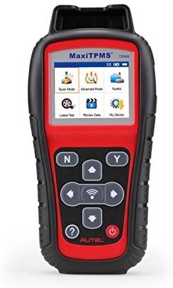

    TLDR: Firestone broke TPMS, couldn’t get it to register in my vehicle, I bought a tool and fixed it myself.
    After selling my 18 Taco, I swapped the SCS wheels to my wife’s 4R. I also needed to get the tires swapped from her OE wheels to the SCS since my Taco tires were on their way out and my wife’s were good. When firestone did the swap, they broke one of the TPMS and replaced it with a rubber stemmed sensor; this is how I know which one they replaced, OE are metal.
    Since leaving the shop the TPMS light never turned off. I tried those wheels on both my Taco and 4R, both had TPMS light come on.
    I was too busy to get back over to Firestone but while doing other things, I had Discount Tire, Mavis, and Randy Marion (GM dealer) take a look but none could fix it, some couldn’t even read that sensor.
    I finally took it back to Firestone 4mo later and asked them to fix it, understanding that I’ll have to pay their programming fee since it’s been so long. The took my $28 and told me the problem is my spare tire sensor is dead, the rest of the sensors are fine. What are the odds of the spare tire sensor dying at the exact time that they broke and replaced another sensor on my vehicle?? Not buying it but I didn’t press the issue and left.
    I began researching TPMS systems and learned that Toyota’s is one of the most difficult to work with because they require the TPMS hex IDs to be programmed to the ECU. Toyotas won’t automatically search for a sensor, they will only read the sensors for which the ID is loaded to the ECU.
    Most TPMS tools can either read sensors or program sensors, and most can’t load IDs to the ECU. I found an Autel unit that can do all 3, though it can only program Autel brand sensors.
    I got the tool in the mail today, and I was able to fix the problem in about 30min including learning how to use the tool. The new firestone sensor wasn’t being recognized by the vehicle. SHOCKER!!! Also the 4R is a 5 sensor system but only 4 are required, the 5th is optional and not used from the factory.
    I’m going back to firestone this weekend to ask for my $28 back, find out what half-assed tool they’re using, educate them on Toyota TPMS, and show them how simple this really was. I’m frustrated with them but it’s also the only issue I’ve had there so I’ll have to modulate my frustration when speaking with them.
    Another reason I bought this tool, is so that I can program my own sensors for the new wheels I’m getting for my GX and leave my OEM wheels as is for ease of swapping back if I want to. Sensors from shop $80ea, Autel sensors $22ea, and I never have to rely on a shop to program the sensors or the vehicle when I want to swap wheels again. It pays for itself with the GX wheels alone.
    Anyone in the CLT area, if you need help with TPMS lmk.

    Techstream would have been much easier :notsure:

    Techstream doesn’t give you the ability to read sensors that are already installed, which was the issue with the 4R. If you know the sensor IDs then yes you can use Techstream to load the IDs to the ECU. This tool does both the scan and load, and works for all vehicles.
