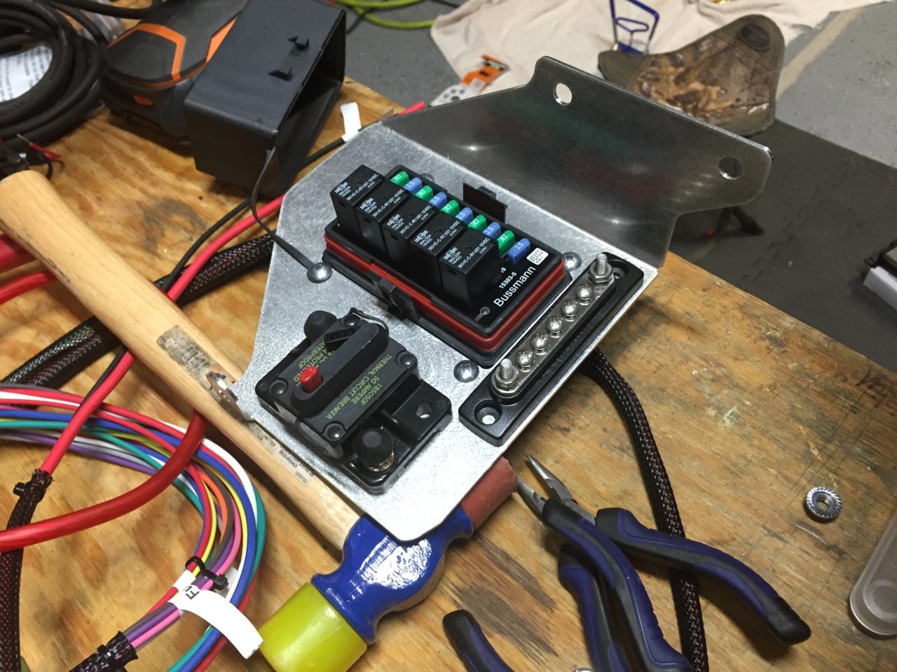

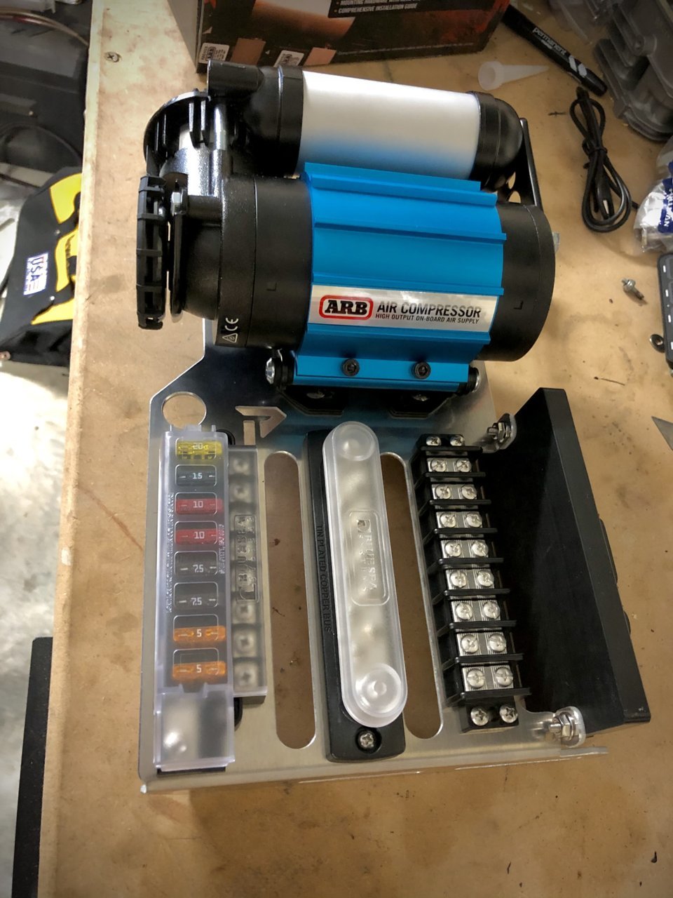

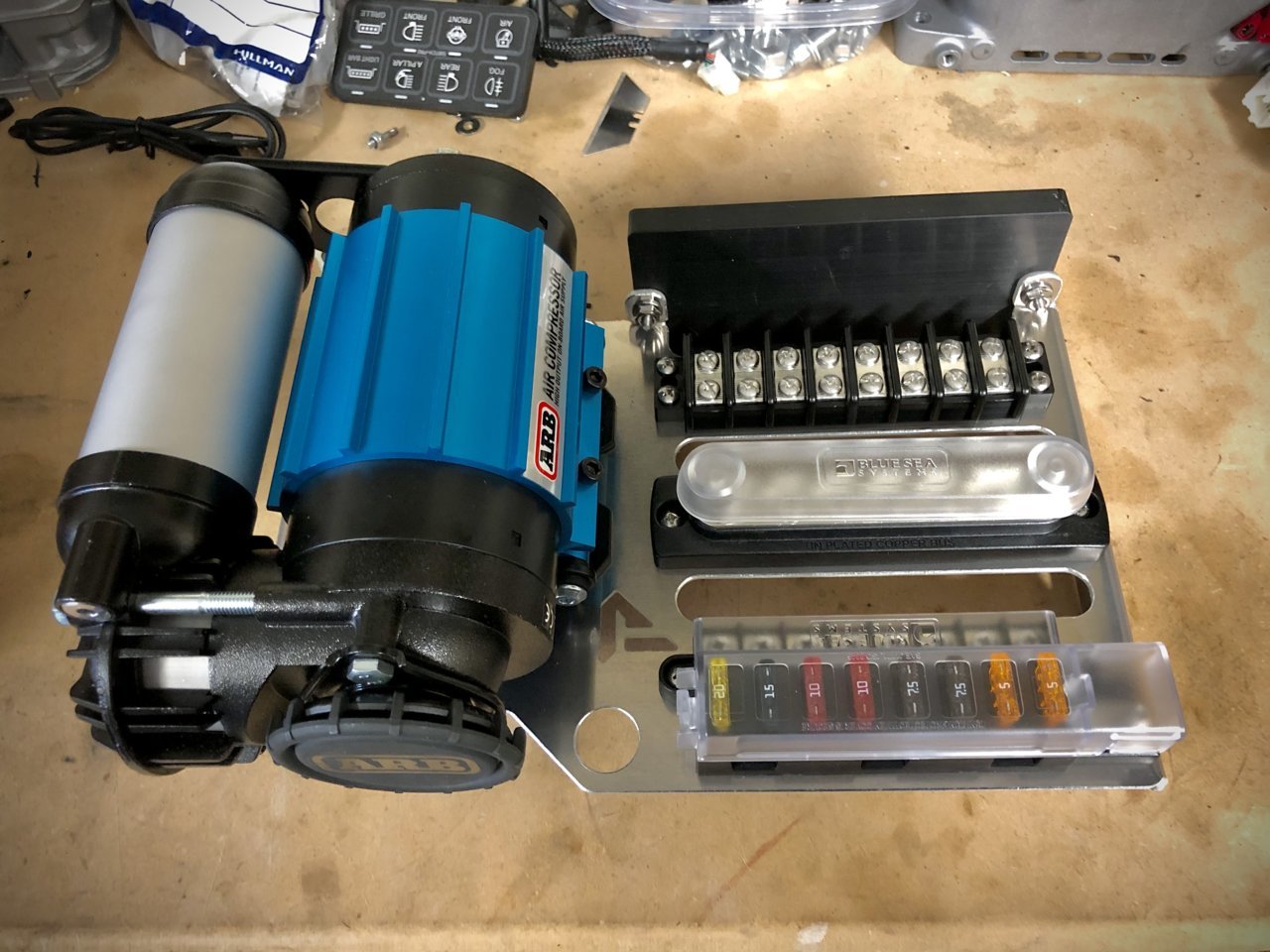

    Just need to get a 1/4npt t-fitting and I’ll get the compressor plumbed and it’ll be ready to install...

    I like that power setup, really clean!
    I had an RTMR on my Tacoma, wish I would’ve kept it for the GX but oh well.

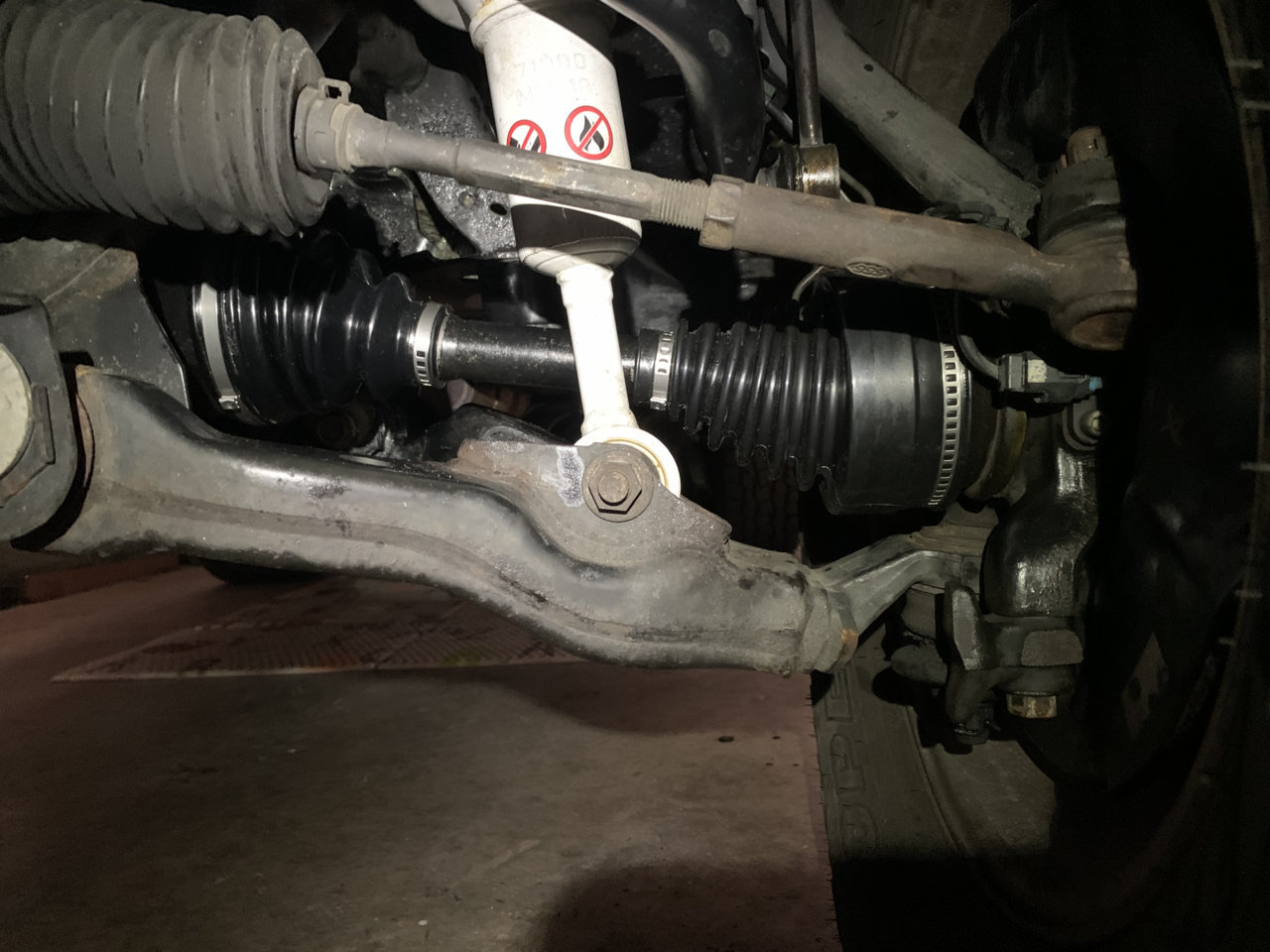

    Just rebooted my CV with the All poo kit. I guess I was sort of confused at first as I though the 930 boot was for the inner like how it’s usually advertised but alas it was not.
    First time pulling a CV. Wasn’t super fun. Replaced the diff seal as well as the seal at the hub. The old one was falling apart. Luckily had both already on hand.
    Anyway. Everything look good to go here?

    Looks good from here.
    Most important is torquing everything to spec. Including the axle nut.
    Diff fluid usually leaks when removing an axle. Even if minimal, I recommend topping off the front diff with fluid. Or drain and fill.

    Thank you for the feedback!
    Got everything torqued to OEM spec. Hub nut was way easier than I thought! And happened to have leftover 75w90 in a sprayer bottle and topped off the diff.
    The 2” pvc pipe to drive the diff seal worked fantastically. Used the old hub seal to drive the new on on that end like I saw on a diy video.
    Here is to hoping the pass side boot doesn’t take a crap too soon lol.
