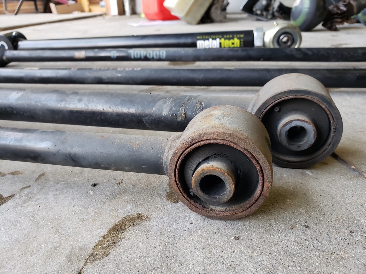

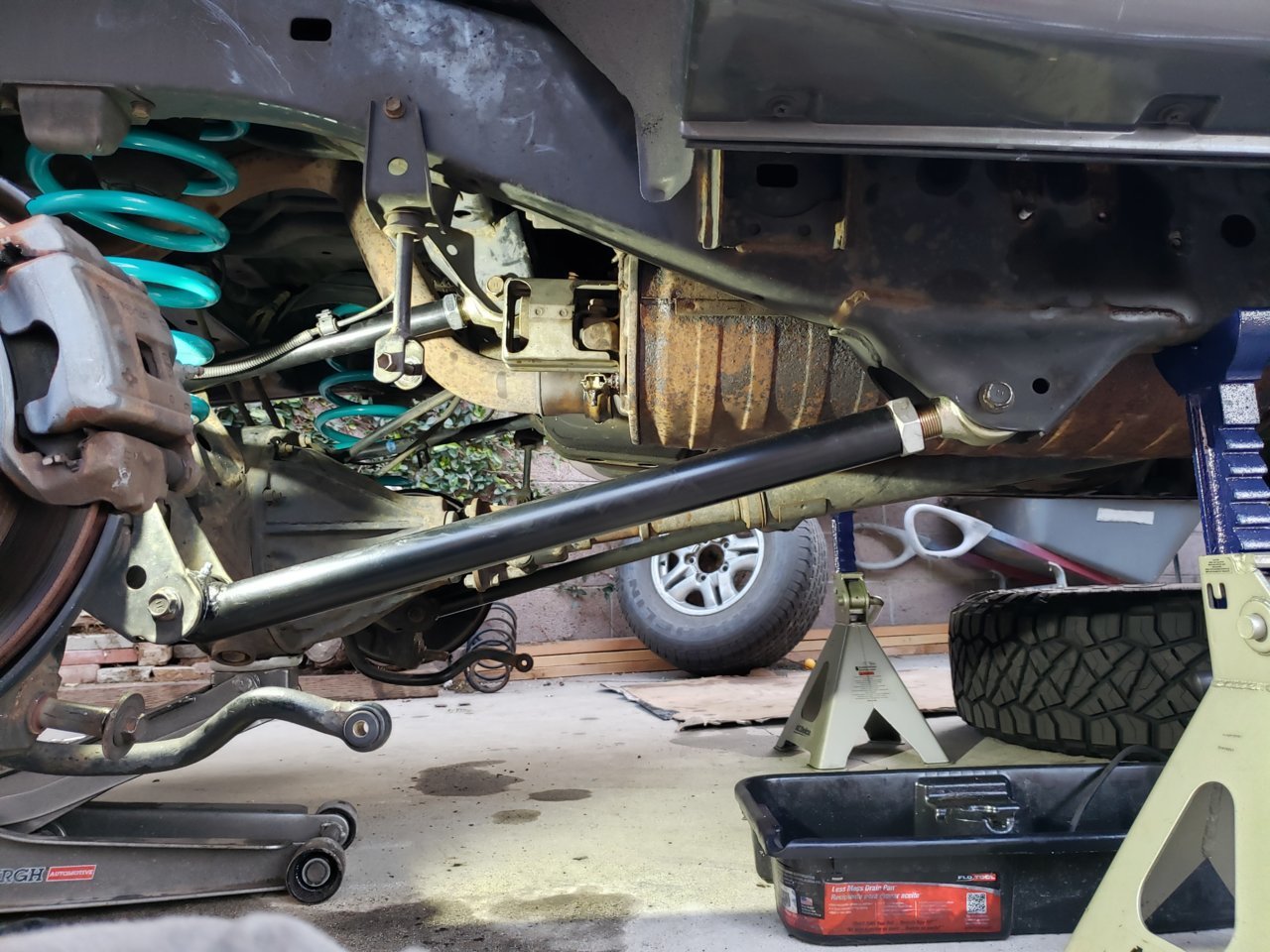

    Replaced all that on a 100 series for an ih8mud member. If you can afford the metaltech4x4 or similar links, I'd go for it.

    the metaltechs are nice but I don’t think I need the adjustability. That’s just one more thing to need to mess with.
    I was thinking more along the lines of just pressing out the stock bushings and replacing with whiteline. Dunno. Off to do more research.

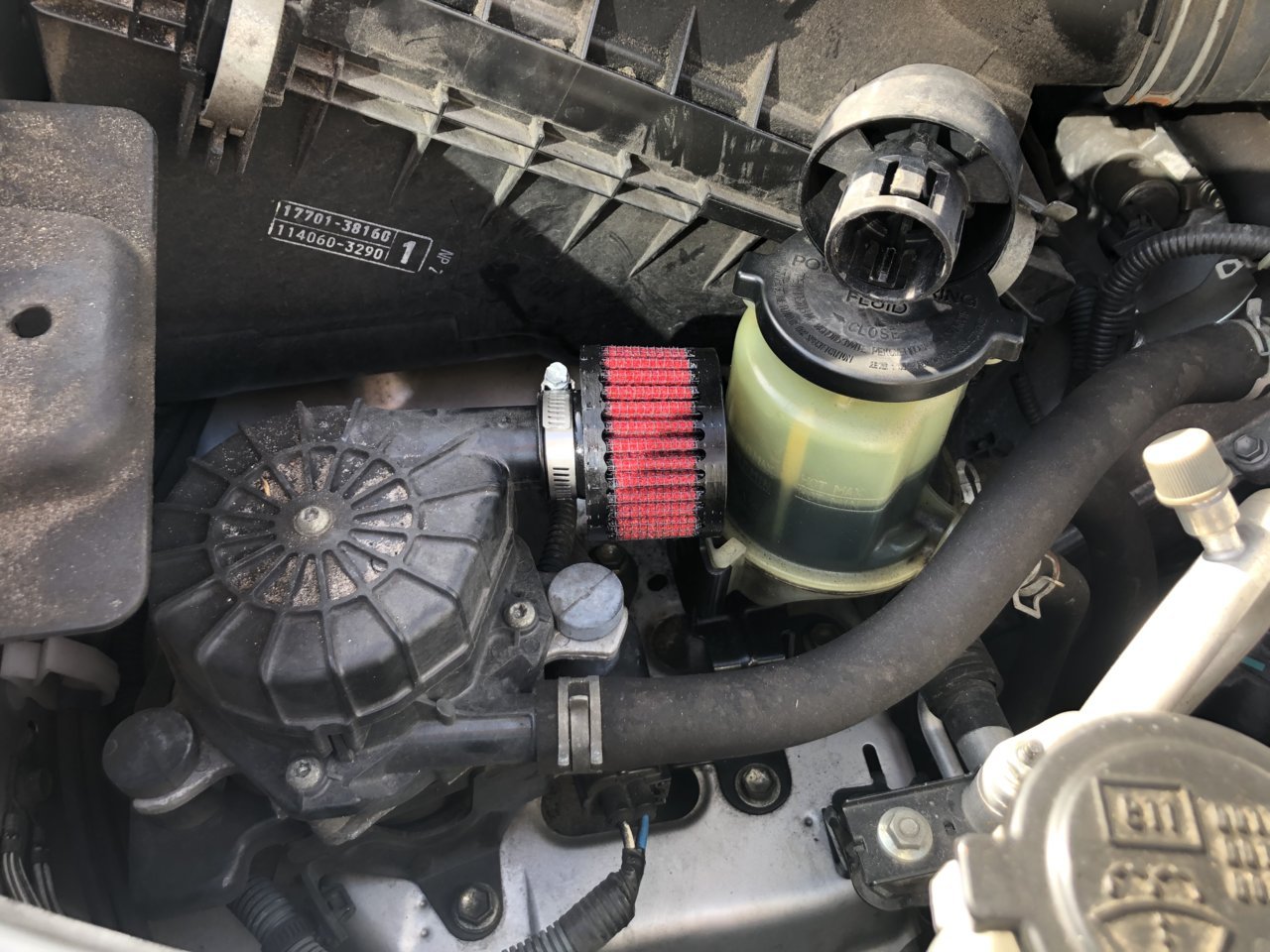

    I did the secondary air intake pump Uni filter mod, BUT there was no trace of any foam in the factory filter housing. Zero. Do I need to be concerned about this?
    And yes I changed my power steering fluid, via turkey baster method.

    wouldn’t worry about it. If it was sucked into your engine you’d know it by now.

    Thanks! Should get me all kinds of mall points! Still have to get the alignment worked out and install the Dobinsons rear panhard bar to bring the axle back in line. And of course clean the headlights, install front door tint, get the windshield replaced, order and install DD yellow fogs, install my upgraded headlight bulbs, etc etc etc

    You on ih8mud? And I need an adjustable panhard bar for my 100. Axle is clearly to one side haha.

    you really need a panhard correction kit for the rear end, adjusting the bar side to side is a bandaid...you really need the panhard bar to be more parallel on a lifted vehicle as that will correct your roll center...on a lowered car you can get away with just an adjustable bar, but to do it right on a lifted truck you need the correction kit...and seems you have a good welder already.
    https://eimkeith.com/buystuff/pck/
