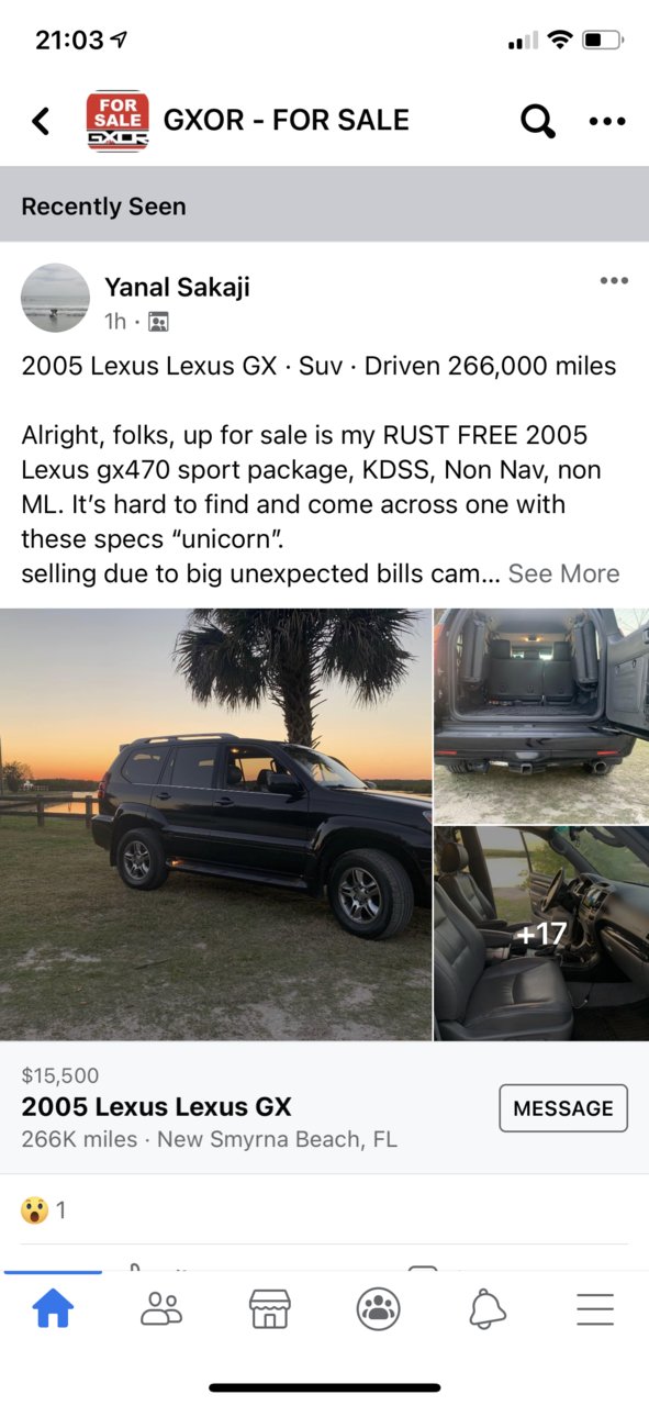

    :eek::eek::eek:
    FS: 2006 unicorn. Has less miles than this piece. $19k. No lowballs. I know what I got.

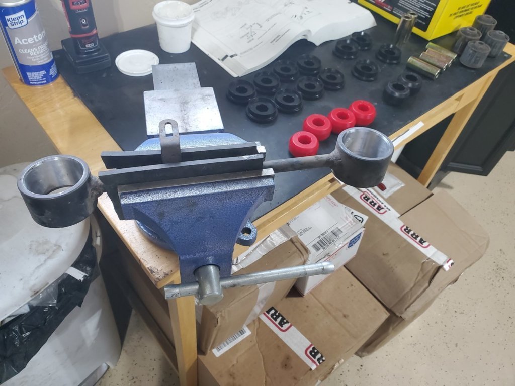

    I bought a kit from Energy Suspension. I have a press and all the tools, but they sent the wrong parts. The kit was cheap, but wasn't worth returning IMO. Decided to just get all new rear upper and lower control arms instead...
    I ended up buying OEM rubber bushings for the front and rear sway bars. I can get you the part numbers if you need.

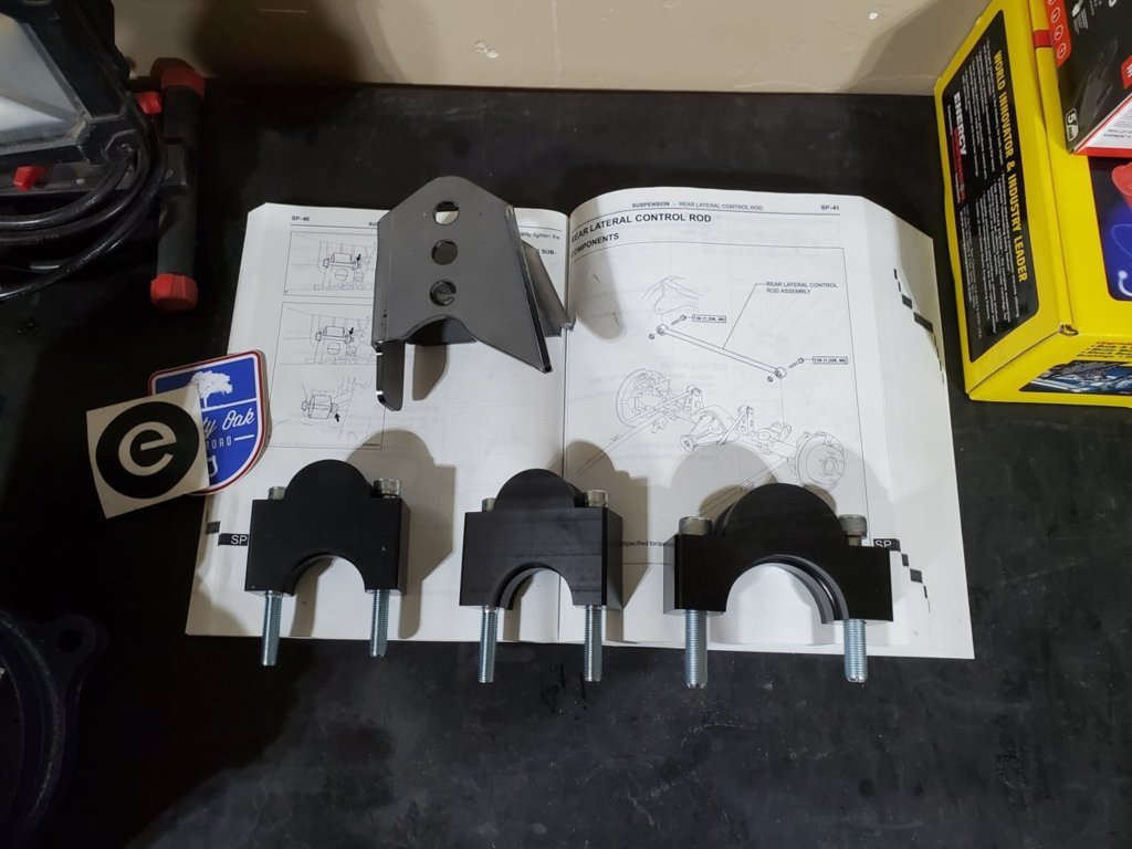

    Ended up picking up the KDSS spacers and @eimkeith PCK as a package from Treaty Oak. Will report back with results post install... (*waiting for @Bubbles to ask about KDSS spacers and skid plate compatibility)

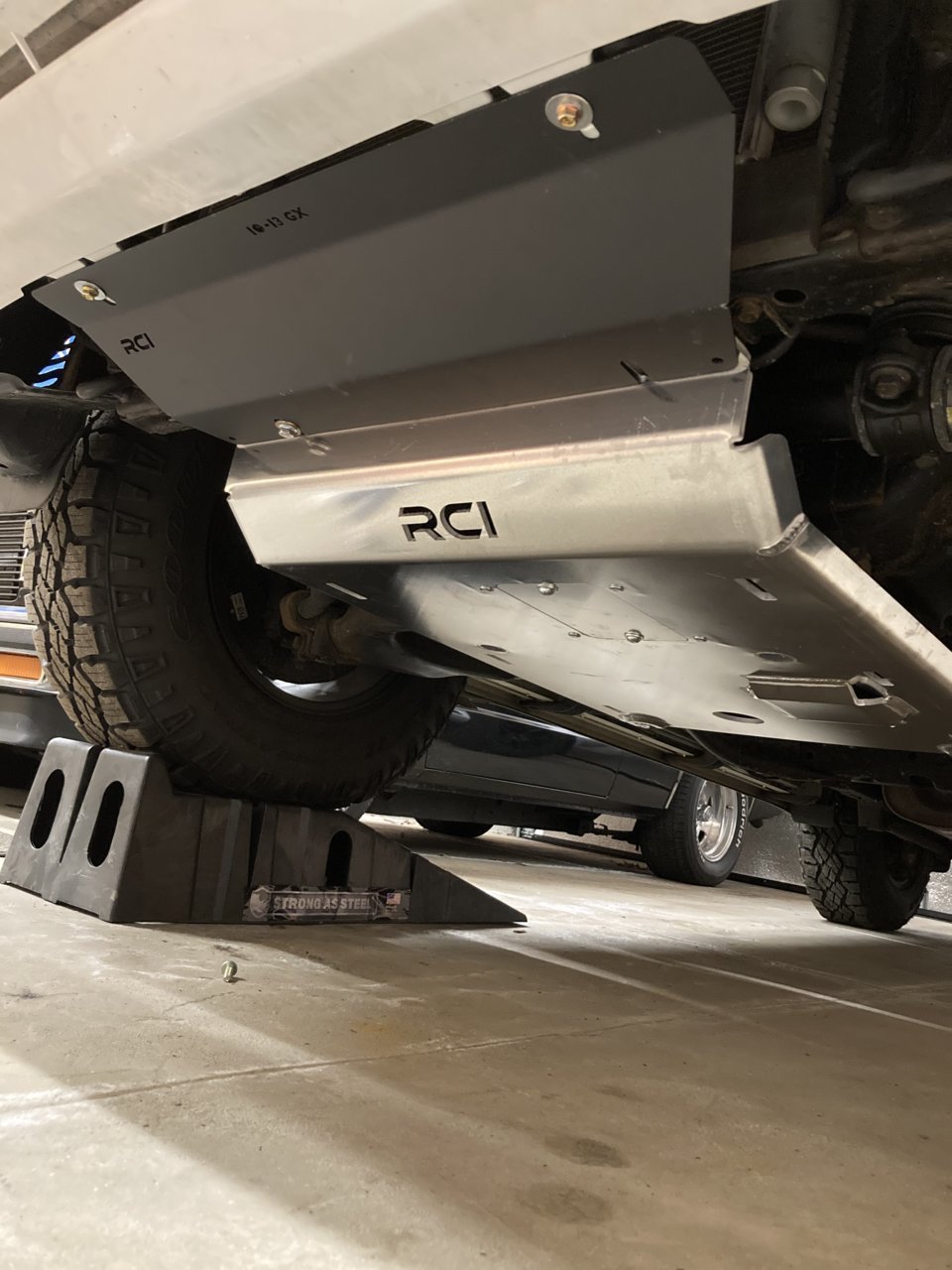

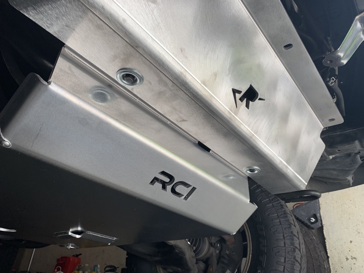

    Got my RCI skid and mini skid deflector thingy on my 460 tonight. PO must have sheered one of the two old front most bolts off... so I got it on with 5 of 6 bolts. It’s really sturdy though. I’ll mess with it some other time. Will probably drill it out and put a bolt/nut through. Feels good enough for now. Plus I’m a degenerate piece of garbage and I’ve had skids partially held on with zip ties in the past and had no issues wheeling fairly hard

    I had the same issue for the front mounts. Also drilled out the holes and just thru mounted a M8 bolt with an oversized washer. Luckily there are preexisting holes on top of the support that let a bolt through.

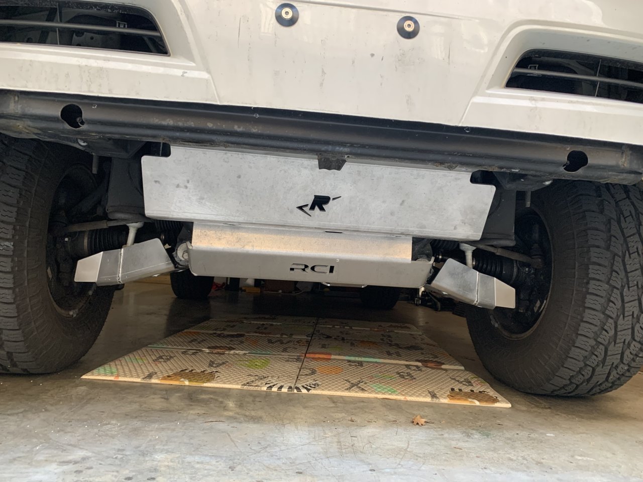

    Threw some ricochet LCA skids on. They don’t cover the cam at all since they were meant to go with the ricochet IFS skid that covers the cams. I know for the most part LCA skids are useless but I wanted to try these out for their extra height and somewhat protecting the CVs/boots/lower shock or whatever. They look nice at least lol.
