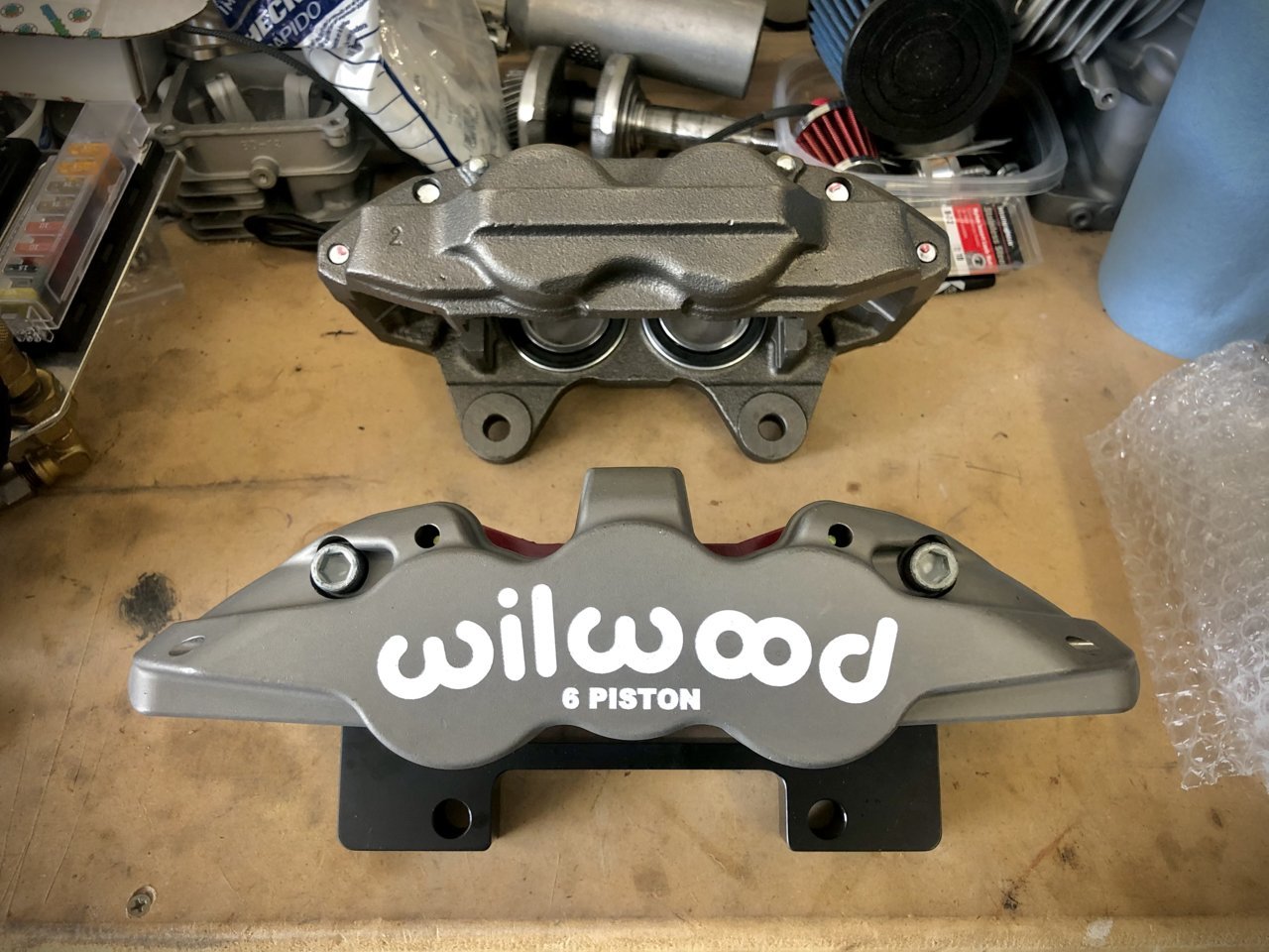

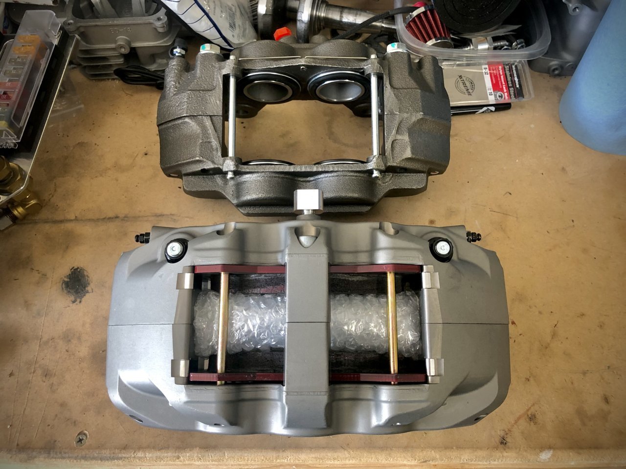

    not needed. Per the owner of RR Racing:

    Interesting. So my stock front brakes are perfect! :D Does Wilwood want you to get matching rear brakes as well to help with bias?

    Some other company makes one; but really not worth the premium. It’s more expensive than the fronts were.

    the Wilwood actually has about the same piston area (I think that’s the correct term) as the stock 470 brakes, so while yes it is 6 piston they are smaller and the surface area of the pads is almost identical to the stock 470 pads.
