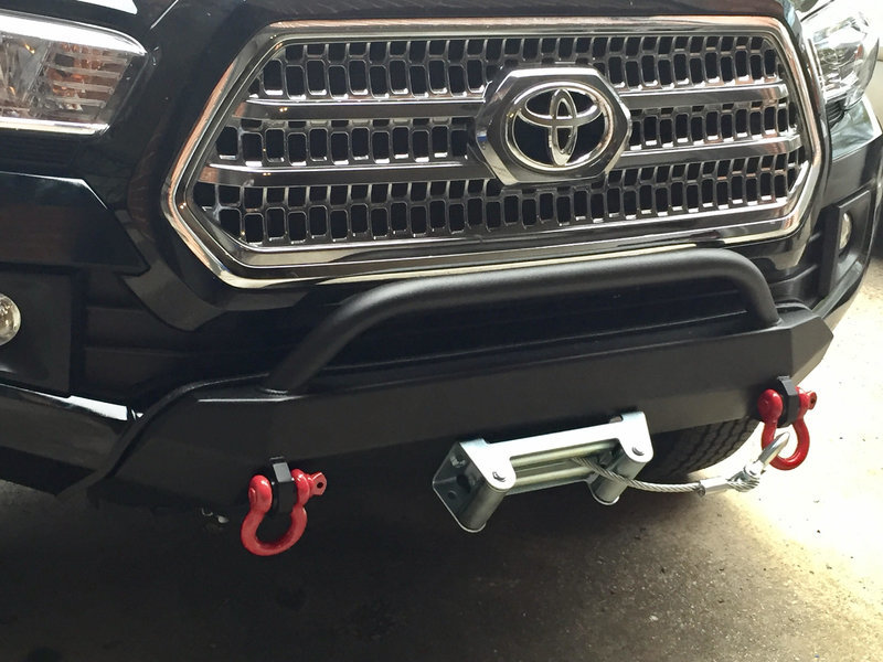

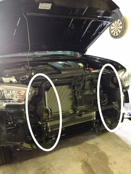

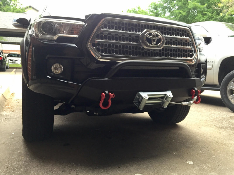

    Here are some thoughts/photos regarding the installation.
    Overall, very good write-up of the install! Thanks, @SouthernStyleOffRoad.
    Couple of points that I noted during installation:
    - Dremel tool was great for cutting and I followed lines as precisely as possible, however still ended up with minor gaps on the corners of the bumper. Not a big deal, but I would certainly recommend studying the lines of the bumper and making your cuts accordingly. Measure twice, cut once. Use 1" painters tape.
    - I did not remove the plastic air ducting as bumper was able to fit without any bending or cutting of air ducts. IMHO removing the air ducts will reduce airflow to the engine enough to reduce MPGs.
    - Reinstalled OEM recovery point just to have another option if needed.
    Overall thrilled at how the bumper turned out. A new black hawse fairlead is on the way too...

    No, you shouldn't have any issue with the pro grill. Those photos make the bar appear deceivingly close to the grill, so unless the pro sticks out an additional 2"+ you should be fine.
