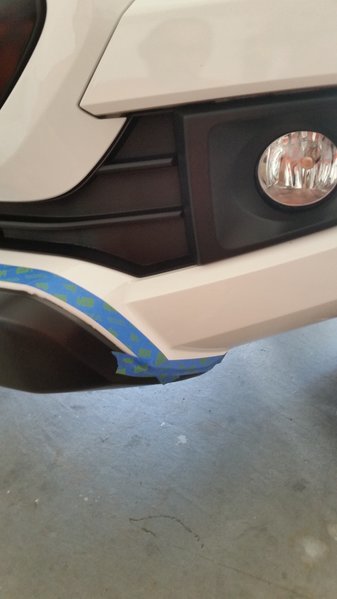

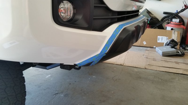

    bumpertape.jpg bumpertape2.jpg bumpertape3.jpgGetting ready to start cutting ,how do my tape lines look ? trying to leave a little extra. Any help from someone who has cut already how does it look????

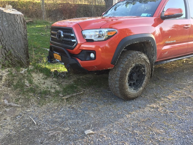

    This is what I did because of what people were saying about gaps at the edges. Worked good tapering forward just past the hoop.
    Edit:
    I could have cut less but it's really not that bad.

    I found out to late, you definitely want cut way less then instructions state when you go downward after the straight top piece. I cut a little less then the instructions said around the corner edge but you can even go alot less 1/2inch less or even more .I went a 1/4inch less and still have a huge gap not real happy about it.t2.jpg

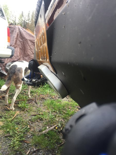

    How did you mount your license plate?

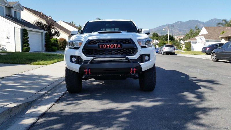

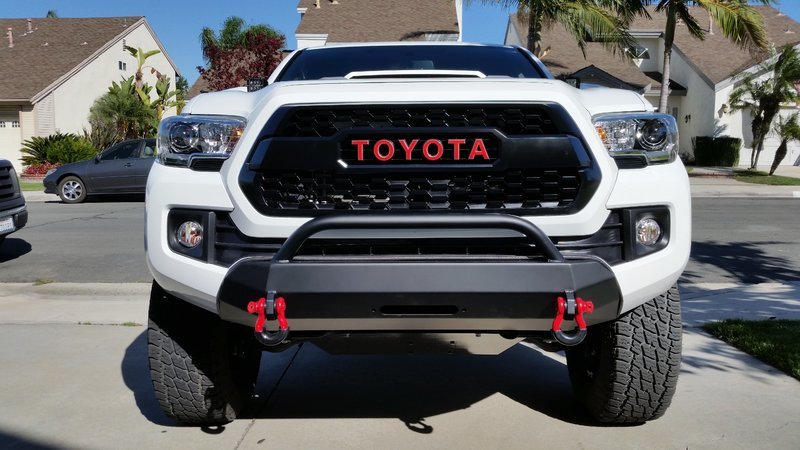

    (I posted this in the another thread as well but wanted to re-iterate the previous comments in this thread about the gap if you follow the instructions)
    Got mine installed and a buddy's over this past weekend. Overall these bumpers are awesome, and the install is relatively straightforward. The bumper packaging, customer service, and product are LEGIT. I do want to point out something that I think SSO should probably address. I am always lurking on the forums and not doing enough sharing of my own experiences that could probably help a ton of others, so here's one:
    Here's what happens when you follow SSO Instructions, at least in my experience: a gap that I don't really care too much about by I know many might have an issue:
    ...and here's what I recommend instead, as I successfully executed a cut line modification and achieved a "gap-less" install on a friend's truck (simply taper the cut line about 1/4" back from the SSO instructions on each side of the lip before it angles/curves down to the ground as shown by the black marker:
    Some completed pics:
    Overall we were both stoked with the installs and more than happy with these purchases!

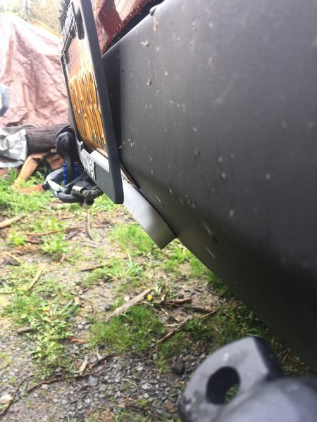

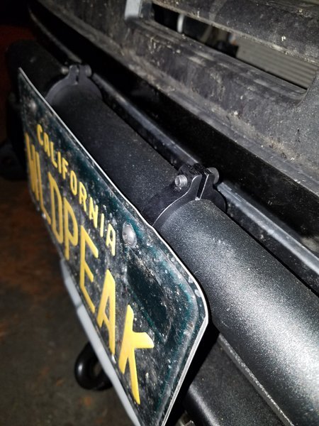

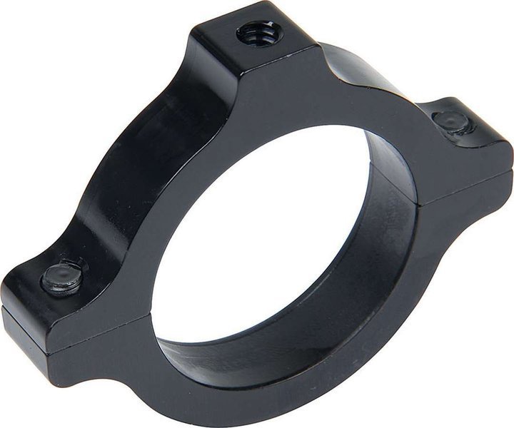

    License Plate Mount I used:
    I bought two of these clamps:
    Allstar Performance ALL10460 Accessory Clamp, 1-5/8"
    https://www.amazon.com/gp/product/B00JPBAE6U/ref=oh_aui_detailpage_o07_s00?ie=UTF8&psc=1
    I also had to buy longer bolts, Qty 4x of 1/4"-20, to make these clamps work because the powdercoating was so thick on the 1-5/8" tubing. I used the existing holes in the license plate, but the license plate covers up the 20" light cutout by a few millimeters, so I may re-position the license plate upwards by drilling new holes in the license plate. Overall I don't think this is the best solution, especially for the price of ~$42 for two clamps. Furthermore the grill is more difficult to remove now because there isn't much clearance between the clamps and the grill to move the grill forward and release the clips at the bottom.
    Nonetheless my infamous [FALKEN] WLDPEAK plate is mounted, and I'm a happy camper.
