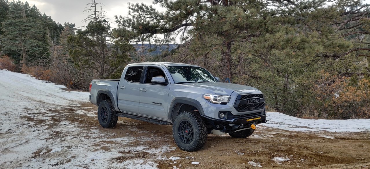

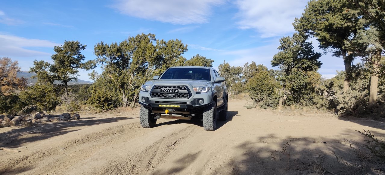

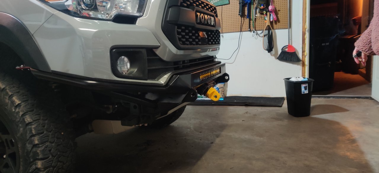

    Finally got this thing installed and I'm quite pleased with it. Personally I think it's the best looking bumper for our trucks. I like how the fog lights are retained and keeps most of the aesthetics of the design. I think I'll be in the market for a larger tire size in the near future.
    One thing I noticed is the mounting location to the frame. It doesn't seem very stout. I know other manufacturers offer reinforcement brackets. Will @SouthernStyleOffRoad come out with anything for this in the future? Is it needed?

    Hi there. We'd have to disagree with you on the strength of our bumper. We've never had a failure of the mounting location from the thousands of bumpers we've fabricated, for good reason. For starters, we use 3/8" US made carbon steel that bolts directly to the frame horns and wraps around the lower radiator mount using all grade 10.9 hardware. Because we've engineered this for simplicity and strength, no other brackets are required. This allows for the safety features of the truck (crumple zones) to work as intended from Toyota. We HIGHLY discourage using the brackets that completely remove the crumple zones like other manufacturers have had to come up with as a band aid to their designs. If you'll notice the other manufacturers designs, they chose a cheaper, thinner steel (1/4" or thinner) as the mount which necessitates the additional brackets. Most manufacturers don't even tie in the lower radiator support as is required for ultimate strength.
    Not only is our design simply the strongest from the get go, but we also offer a LIFETIME limited warranty on workmanship and material defects. I hope this information sets your mind at ease!

    I wasn't implying your bumper is the weak link. I was referring to the frame horns that the bumper mounts to. I firmly believe the bumper is more than adequate in terms of strength.

    No offense taken. The frame horns are weak, you're right. THis is why we use the 3/8" steel and wrap it around the lower radiator mount. In order to pucker the bolt locations at the frame horns, it would have to bend the 3/8" steel first. While not impossible, this feat would require approximately 8 tons of force just to bend the steel at it's narrowest point without even considering the grade 10.9 nuts and bolts that are also providing 150,800 lbs/in2 min tensile strength each.
    For comparison it would only take 3 tons of force to bend 1/4" steel, everything else equal.
