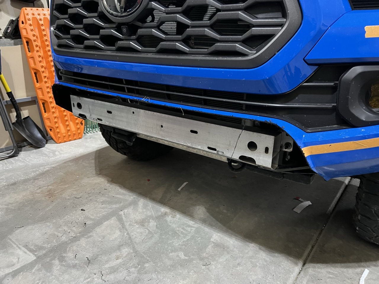

    2020 Tacoma OR DCSB Voodoo Blue
    KDMAX Pro, RCI sliders and skids, CBI overland bars, 255/85R16 Geolandars, Bestop Supertop 2, ARB Drawers, Uptop Bravo rack

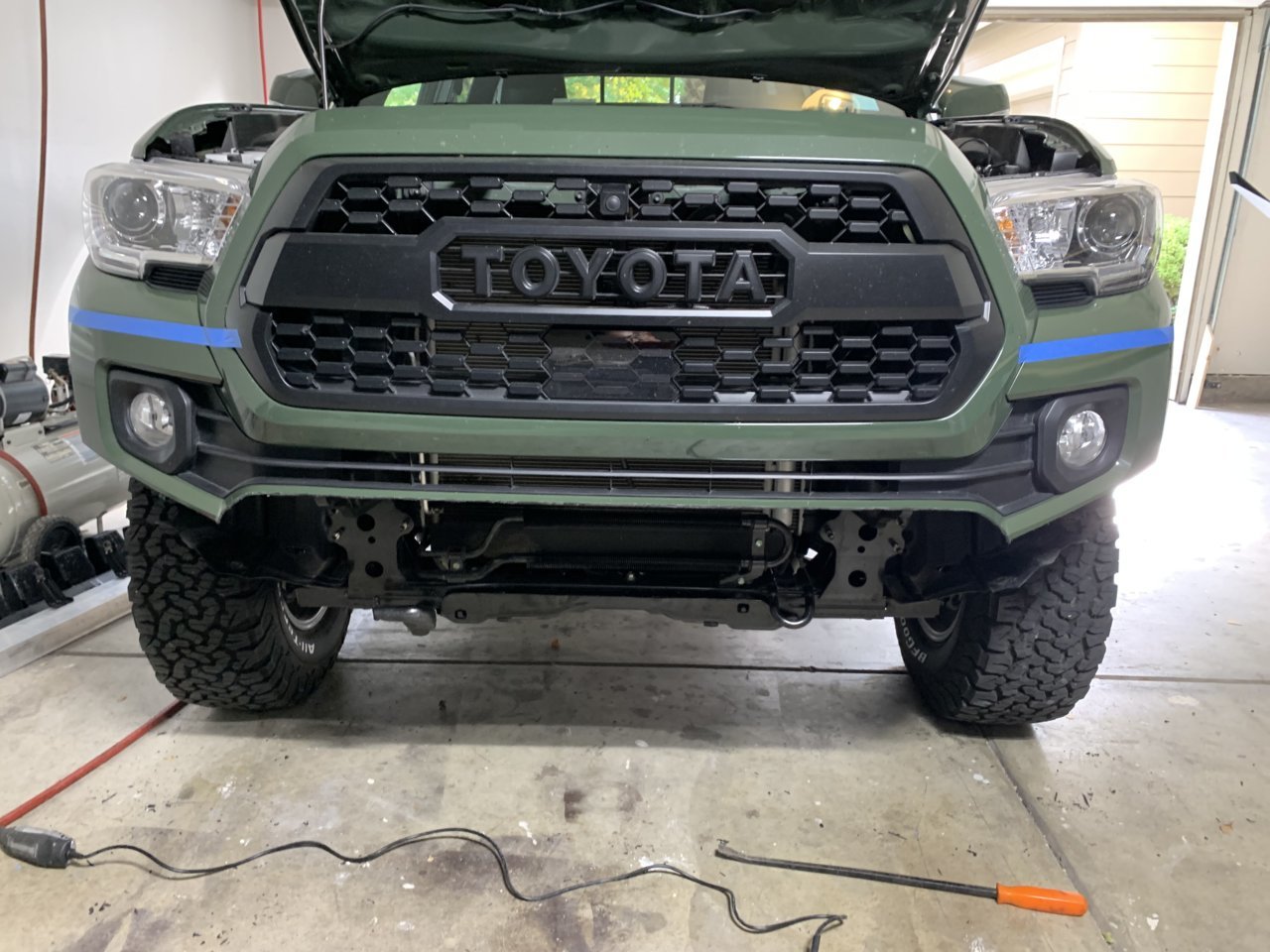

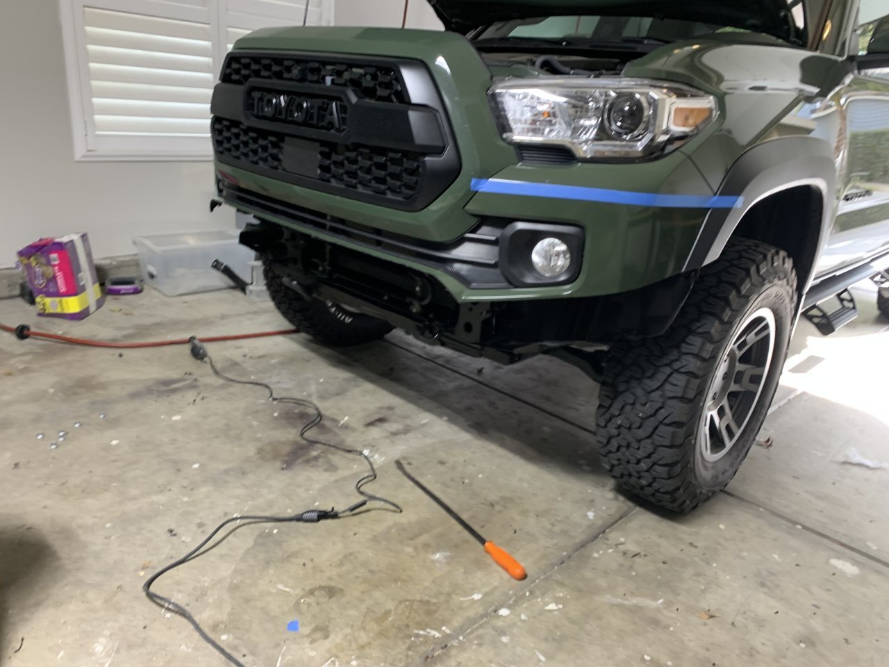

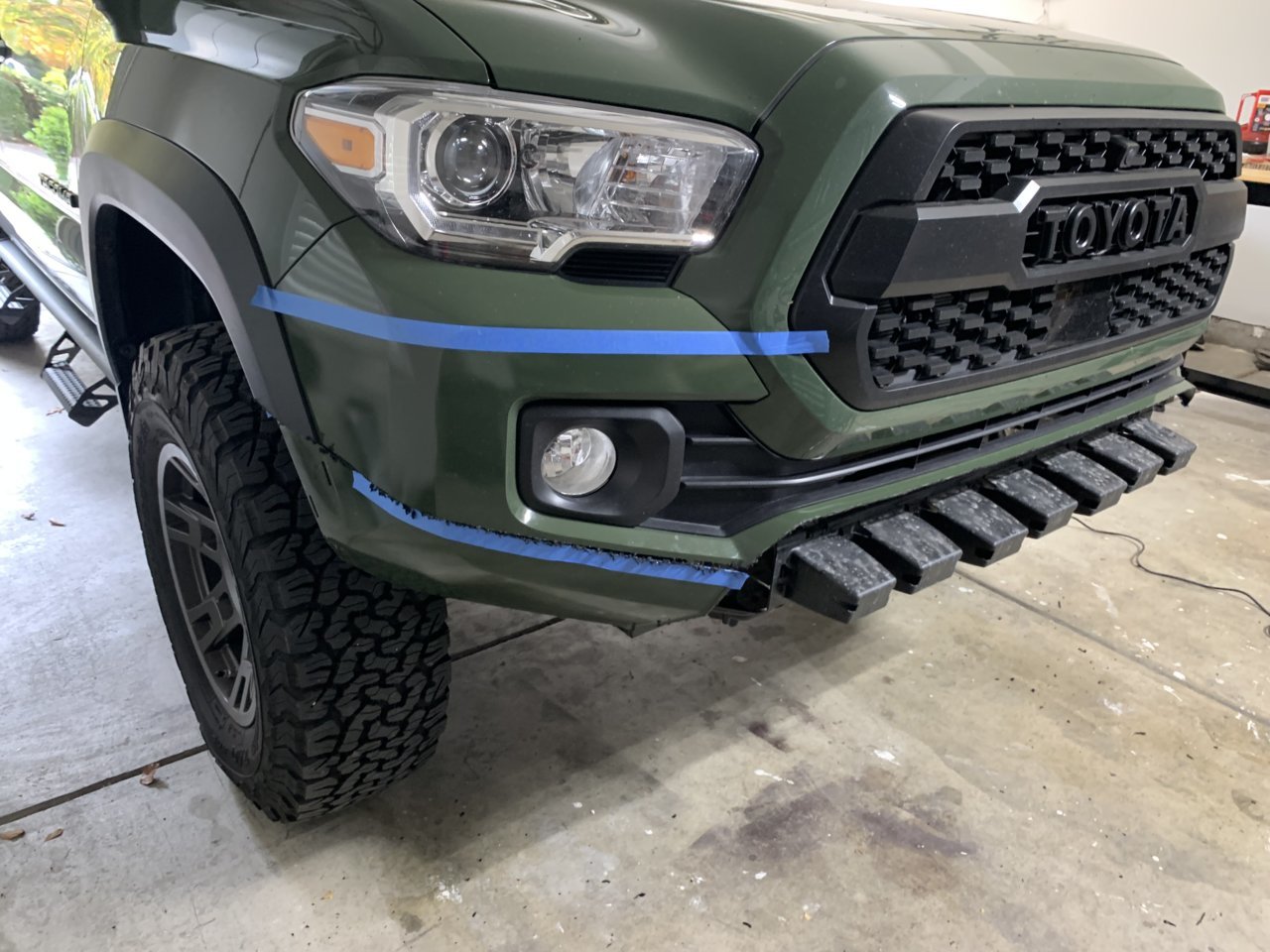

    This is the best I have. Before I cleaned up the cuts (sanded with dremel).

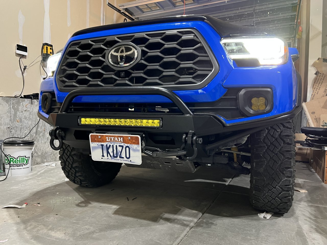

    Has anyone fit an 18” Diode Dynamics light bar in the 20” spot on these bumpers? All I have seen is comments on the 30”. I’m curious if this extra inch gap on each side looks bad?

    I have the 20" version and put some Bajas in there. I would think the inch void on either side would be pretty noticeable. I wouldn't do it. That's just me though.

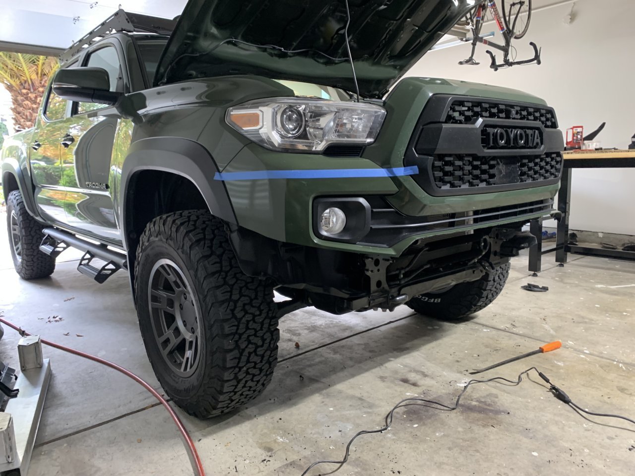

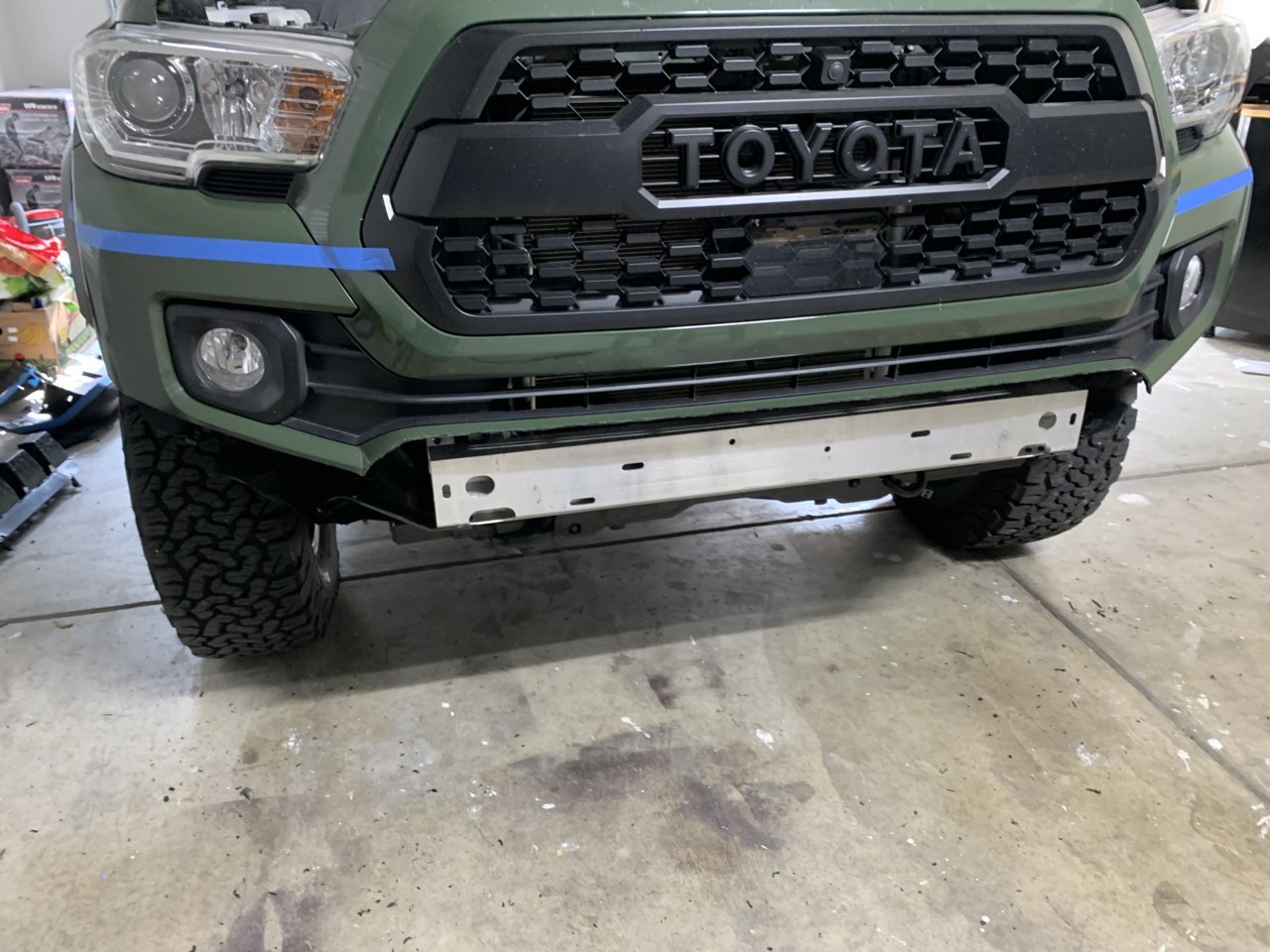

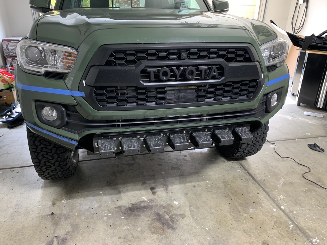

    TRD Lift, FN (f)X Pro Gunmetal 17x8” wheels, 275/70 R17 BFG All Terrain T/A KO2s, Pace Edwards Ultragroove Metal retractable tonneau cover, Prinsu Cabrack, Southern Style Off-road slimline full plate bumper, Heiss 20” LED, Warn Evo-10S winch, Inno ski/board rack, Diode Dynamics SS3 fog lights, Billie Bars Mid-Rise 17” bed rack

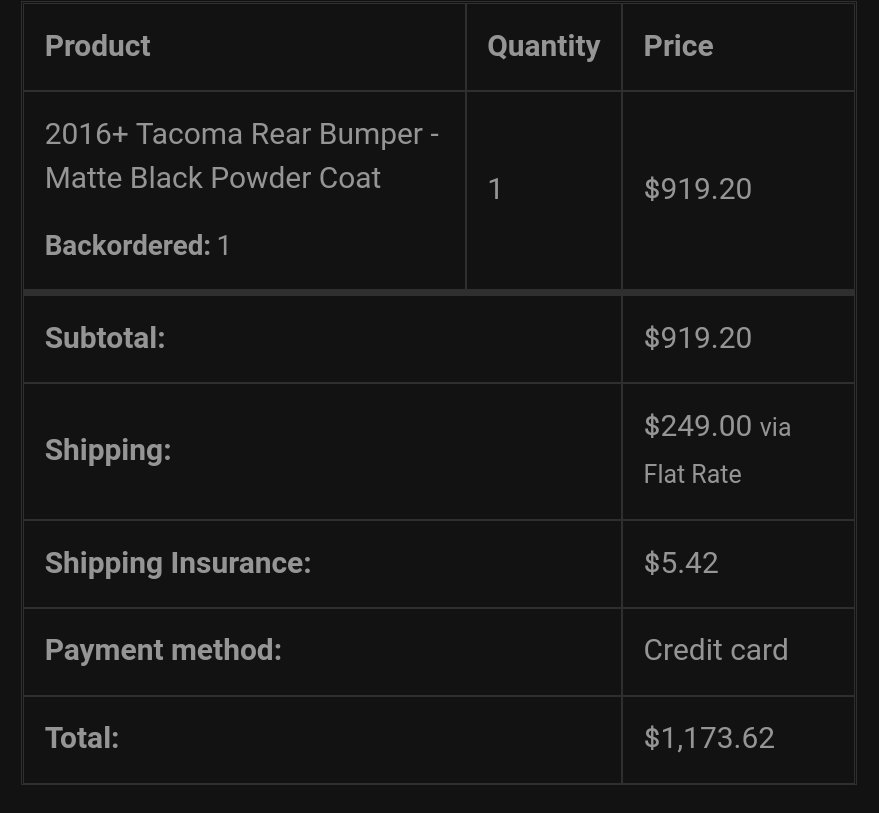

    Very exciting to get those order updates from SSO. It’s rad that the process is so transparent even if it takes months. Hopefully bearings weeks away from shipping

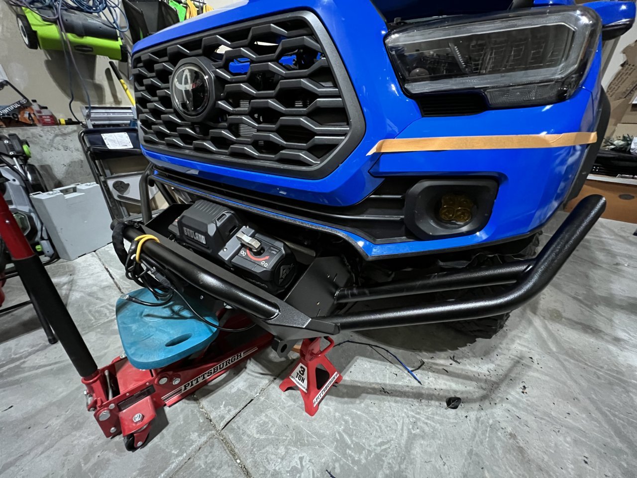

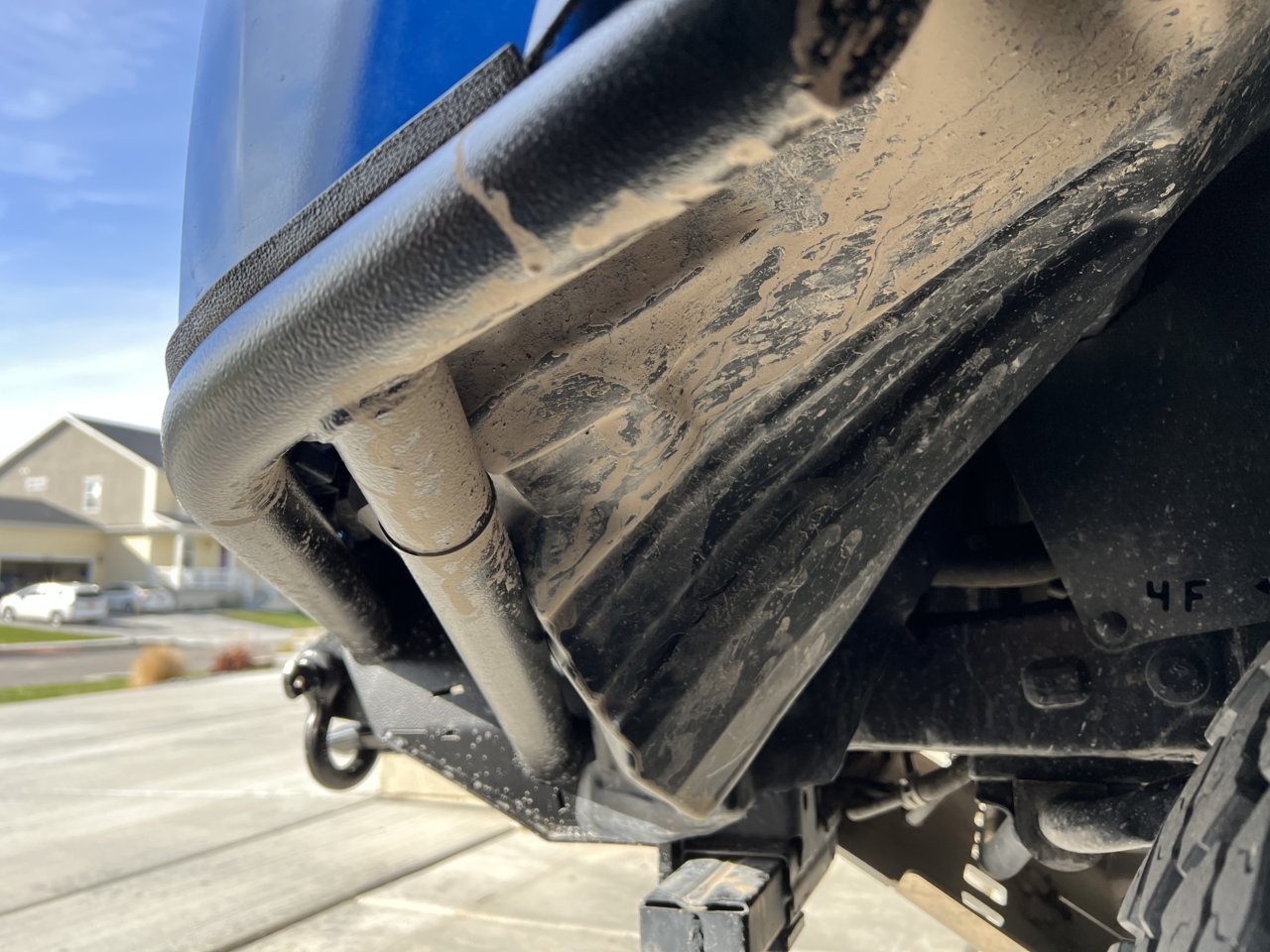

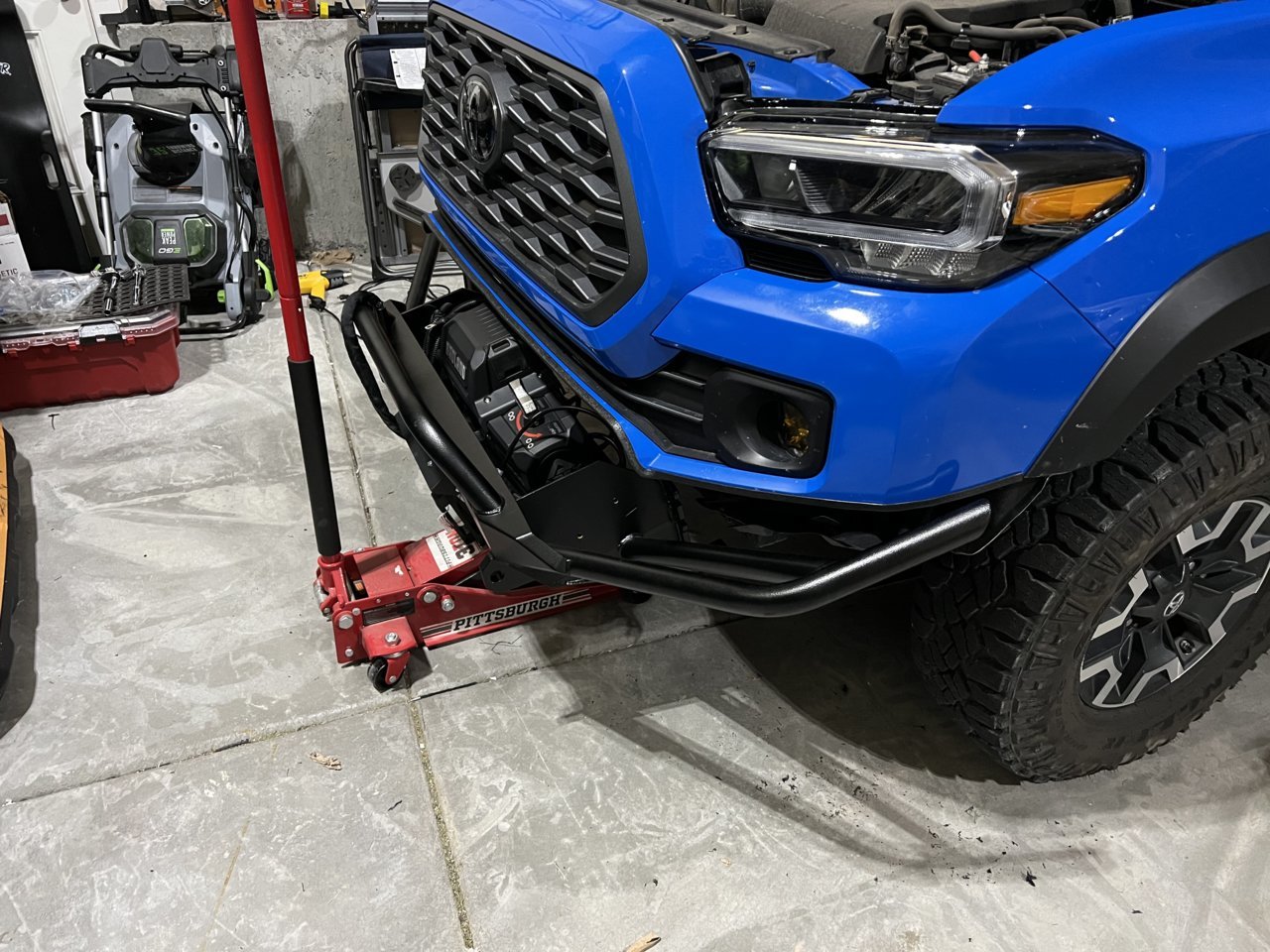

    2022 MGM TRD-OR Tacoma
    DV8 Roof Rack, Leer camper shell
    @SouthernStyleOffRoad

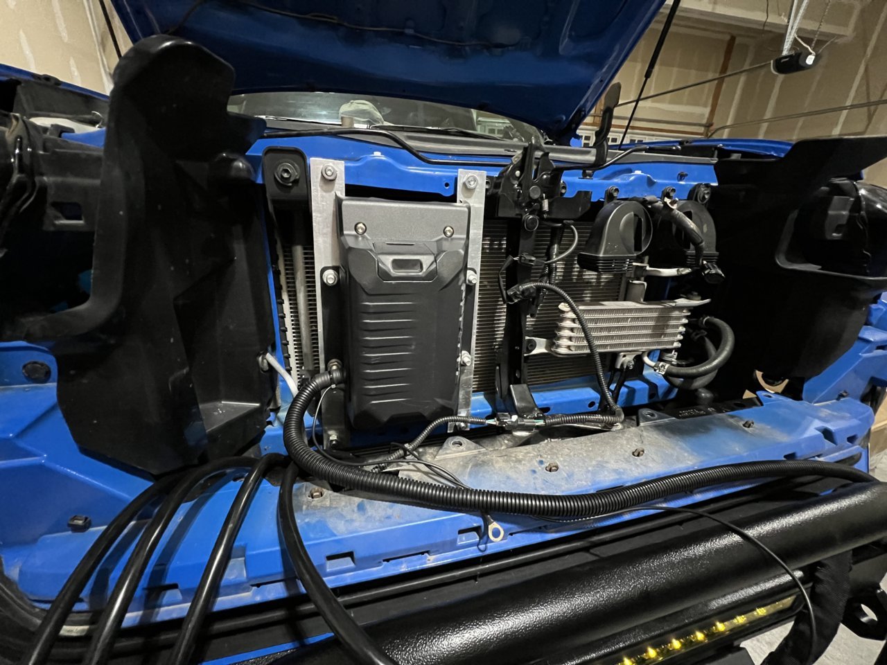

    Will the Badlands Apex 12,000lb winch work with the Slimline tube on a 2022 Taco?
  11. Jan 18, 2022 at 11:14 PM
    #431
    codemancer
    codemancer Well-Known Member
    Mar 9, 2020
    #321735
    274
    Northern Utah
    It will but you will have to relocate the control box. I tried for a weekend to get it in without relocation and even went as far as to trim a significant portion of the radiator support. In the end I figured it was just simpler to relocate. You could probably make it fit if you completely cut out the radiator support that gets in the way but it will still be very bad to angle it in correctly because in order to clear the bumper under the grill you have to lower the bumper but once you get clear of that you are up against the frame horns and so there’s very little room to maneuver. So I would either go with the Smittybilt which lets your relocate to the side or prepare to rig up a mount for the Apex box. I couldn’t pass up the $400 deal on the Apex so I went that route. Here’s a few pics of my install.
    B3F1489E-D83F-4A91-A010-4B265F07F341.jpg 829D13D3-3193-4CEB-859B-437267494465.jpg E1A7F50B-3C49-4D6A-B8CB-A2A5B88C96BC.jpg C9CA2A8B-38E1-435F-A358-842AC1269EF5.jpg 34A224A9-029C-43C0-9F4A-F0C041FFB3F4.jpg
    Last pic to show how I moved the fender liners without cutting.

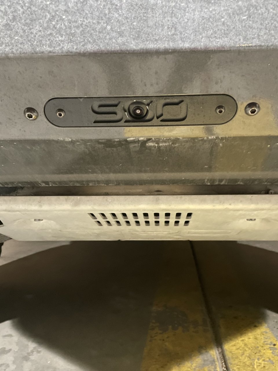

    Just wanted to share my tid bit . My front any time camera mount solution .upload_2022-1-19_18-35-59.jpgupload_2022-1-19_18-35-59.jpg

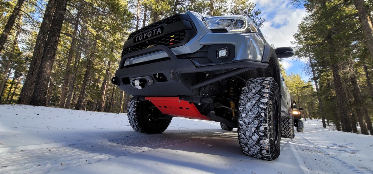

    184
    19 Cement TRD Offroad

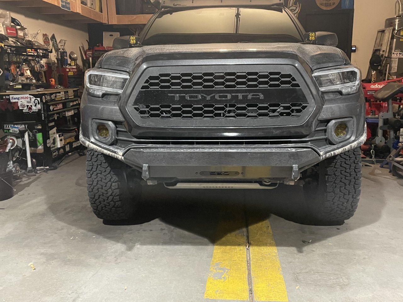

    No issues running any of the front skids... this is a pic with the rci skid
    jgr81, PNWWanderer and BobbyTacoTRD like this.
  17. Jan 20, 2022 at 8:41 AM
    #437
    BobbyTacoTRD
    BobbyTacoTRD Skewps Ahoy!
    May 29, 2021
    #367117
    810
    2021 TRD Off Road
    Thanks for the image! That looks real, real nice! :cool:

    That's a pretty slick place for the camera. I assume you can't see any part of the truck in the image. Does that make distance judgements a little tricky?

    I kept the lines for distance . I haven’t really gauged them . I didn’t have a big enough step drill bit to make the whole wider . You can see a small edge of the hole I cut out but no way does it interfere with the camera and what your looking at .
