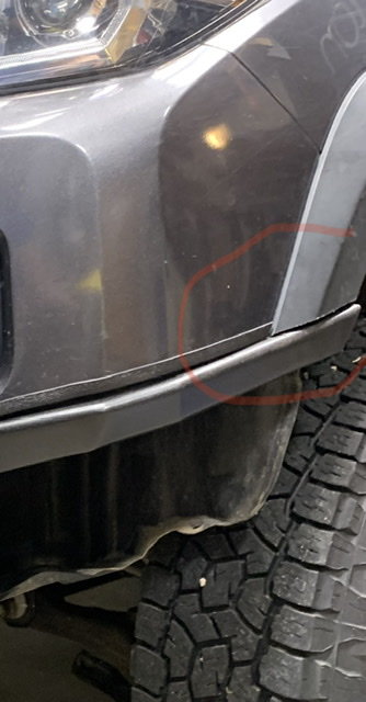

    16 Tacoma TRD OR Access Cab, 03 4runner v8
    I just had to go back and recut the last 4-6 inches or so from the wheel well. The rest was fine. I need to go trim a bit more from the fender flare. I was able to cut it again without removing the bumper and sliding the trim piece off from the back and was able to replace it ok. Would be wayyy easier without the bumper on there but I didn't want to wrestle that thing off again by myself :)

    Maybe the best thing to do would be measure and cut like they recommend to start off with, throw the bumper on to see where you are at. It would suck to take too much off right away and have a big gap, I'm sure each truck has small differences. I would've done that but I put it on by myself carefully without help with a floor jack and jackstands and wasn't going to do it again. If you could have a friend help you lift it on and off it would be so much easier to just get a baseline and cut more from there. Either way I'd mark it out like they say, and perhaps take a little more off just at the fender flare area to the first crease...
    This area I circled is what I had to retrim, you can see it's right up on the bumper
