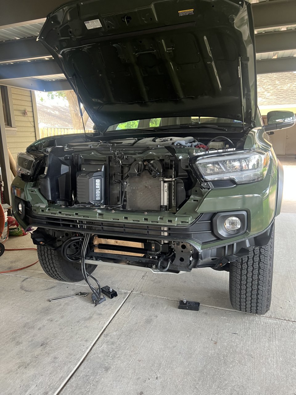

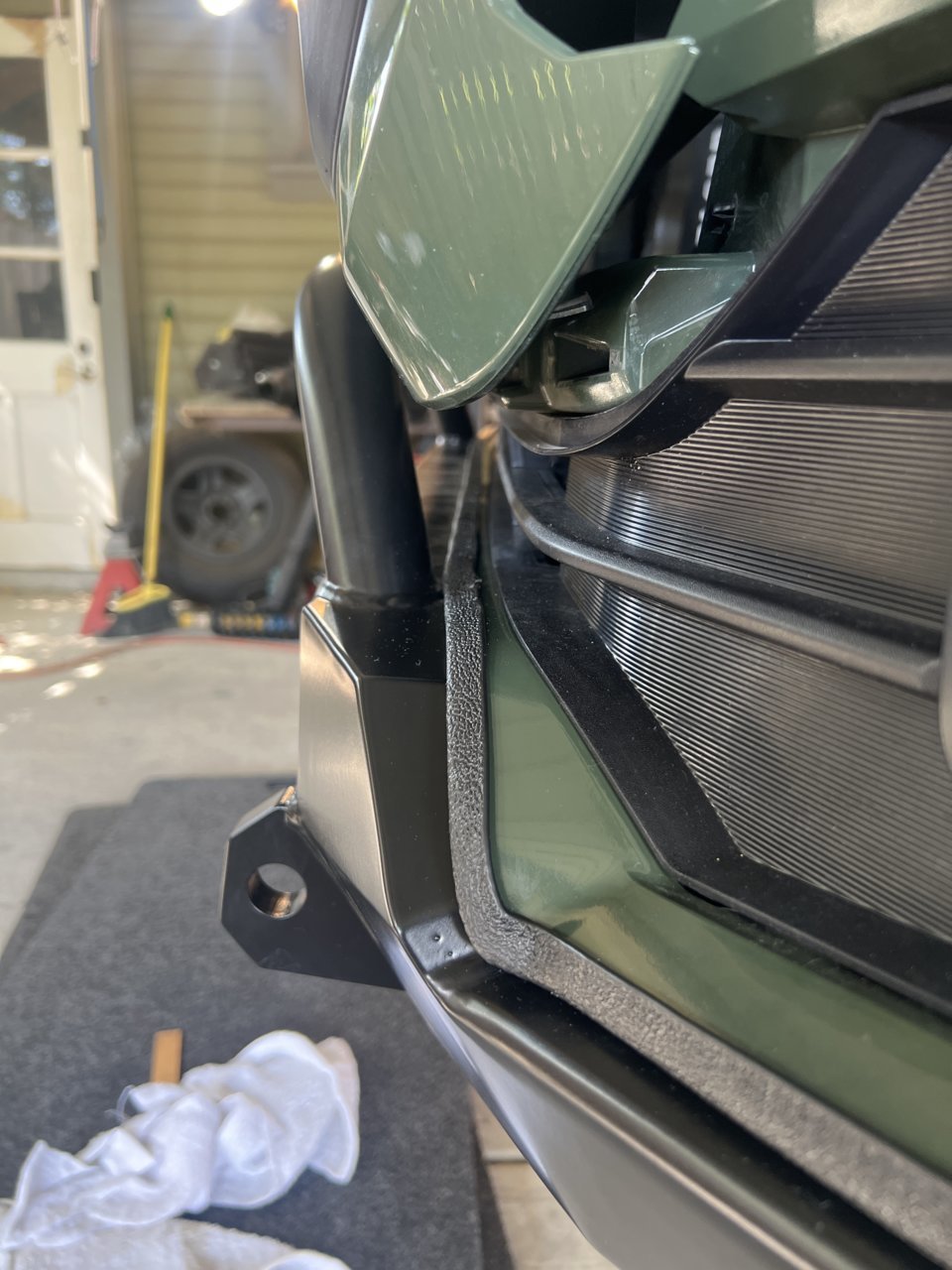

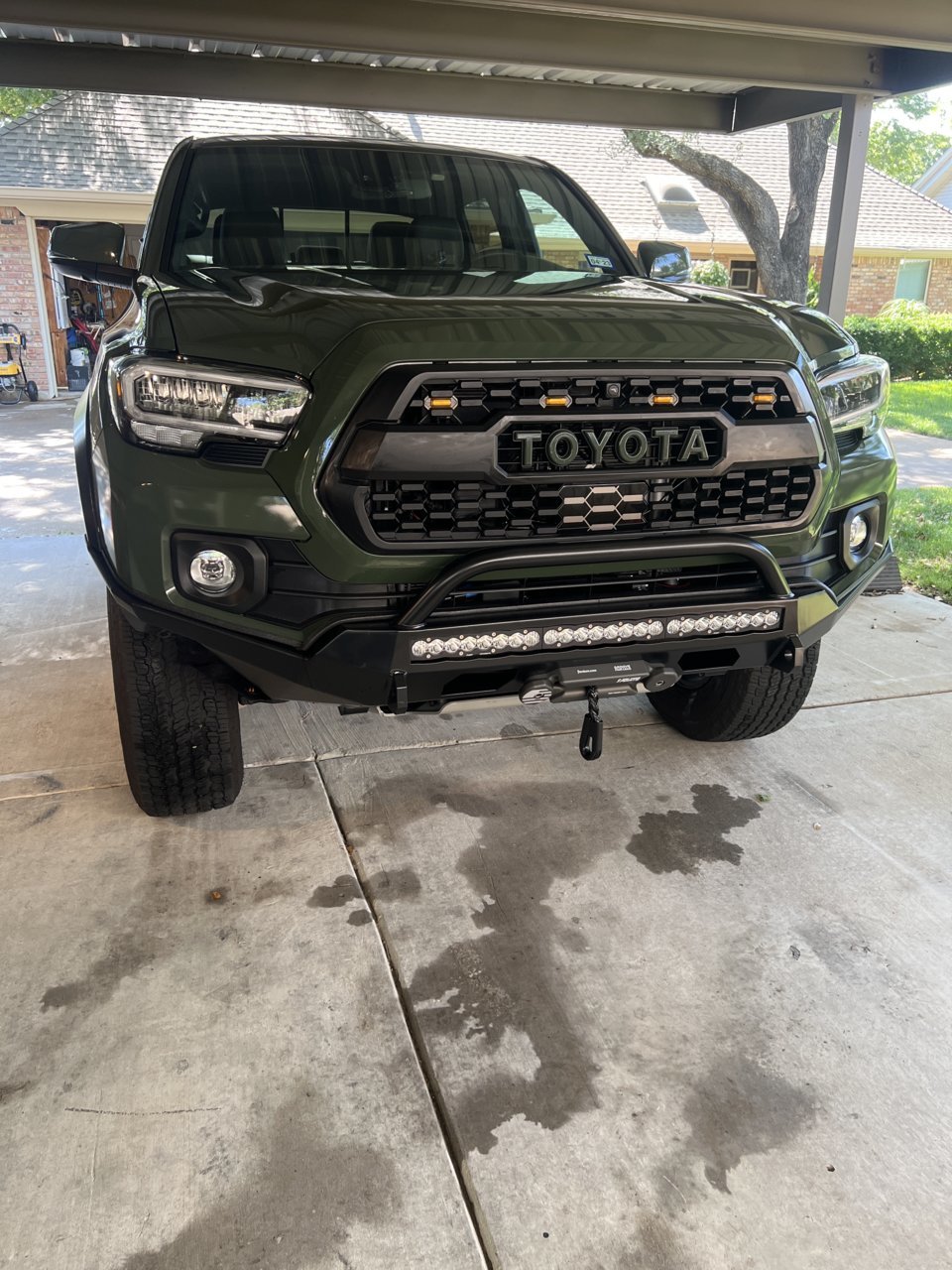

    If I put the bumper on will the Bull Bar keep me from putting the grill in? Anybody know? BTW I have a Pro Grill now.
  5. Jun 19, 2022 at 11:41 AM
    #505
    bryanb76
    bryanb76 Member
    Sep 2, 2021
    #376032
    11
    Concord, CA
    21 TRD OR Voodoo Blue
    The bull bar will not be in the way, you'll have plenty of room for the pro grill to go on last. :)

    For me... the bumper prohibits removing the grille surround. You need to drop the bunper to remove or install the grille.
    I have the SSO slimline with a bull bar. No wings.
    I know that the BA bumper with a bull bar does not conflict with the grille removal/install. This is because the bull bar sticks out further from the grille.

    I kept my wheel well cuts at maybe 1 7/8 from center of the bolt. I didn’t have to cut twice. I think it will be good. Thanks for all the help everyone.
    Looks like it’s going to be very tight squeeze on the the Pro grill. I’m not ready to put it in yet so I’m not sure.

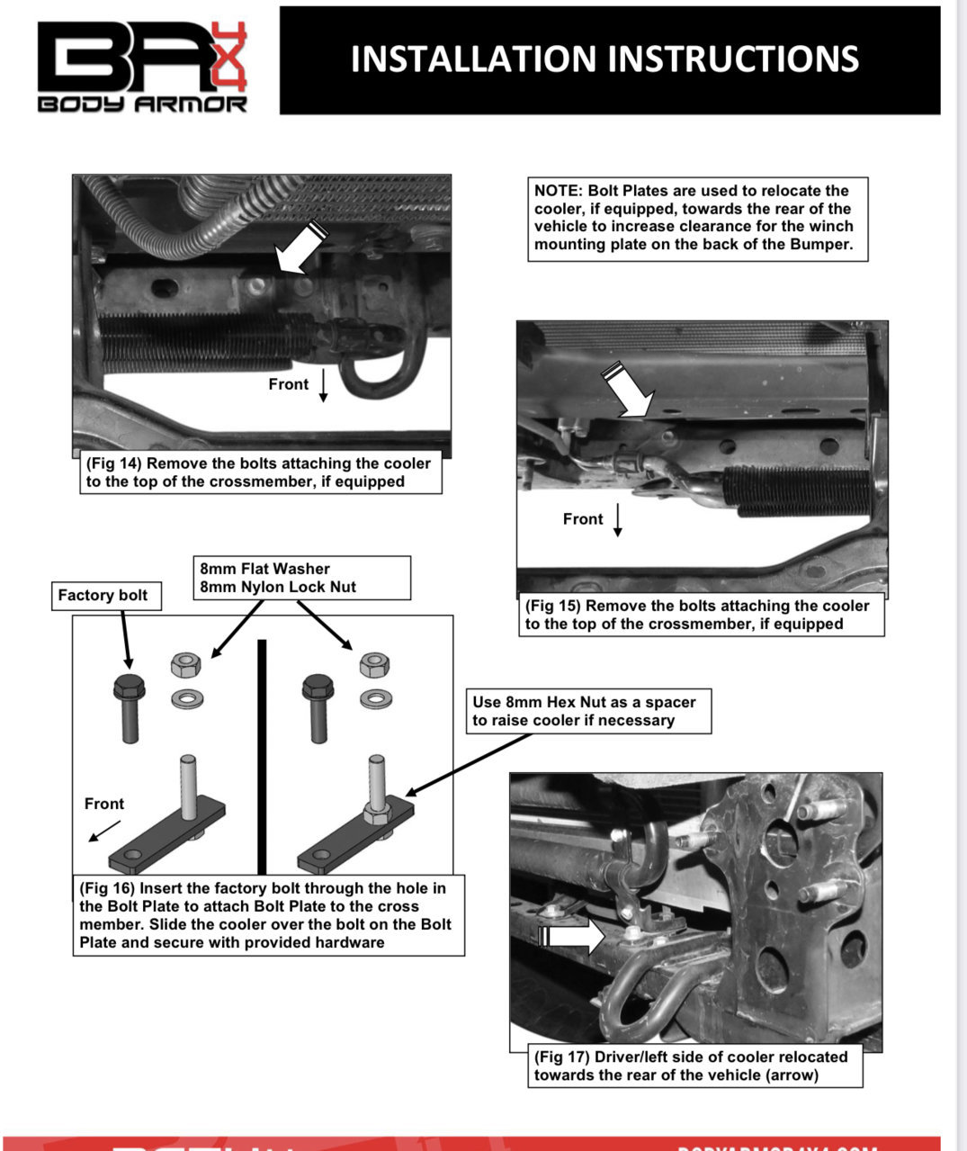

    The Body Armor bumpers instructions have a relocation kit for the transmission cooler to move it back a few inches.
    The SSO bumper instructions doesn’t show this at all.
    Anyone had to relocate the transmission oil cooler back on the SSO bumper install

    Nope... your trans cooler stays in the factory position.

    Interesting. Wonder what is different that you don’t need the relocation? Almost all of them do. Victory4x4 etc etc

    All back together and working winch. I didn’t have to take the bumper loose to get the Pro Grill back in but I did have to take the five push pins out of the grill section right below Pro Grill. By doing that I could push the lower part of the grill back enough to put Pro Grill in. Be sure to put the push pins in before you fasten the top part of your grill or else you won’t be able to get to the push pins on lower section. Hope that made sense.

    If your taking the grill off with the Bull Bar type bumper, take the two screws and two push pins out of the top off the grill. Lean the grill out as far as you can so you can get to all the push pins right under it. 5 I think. After you get those pins out you can push the lower part of grill in toward the motor and gentle wiggle the long arms on the bottom of the grill out and up. Don't even think about taking the bumper loose
