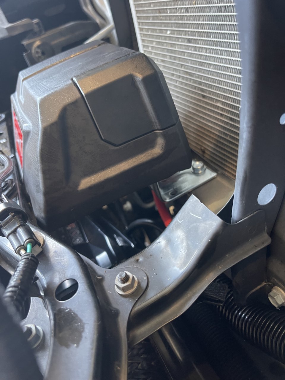

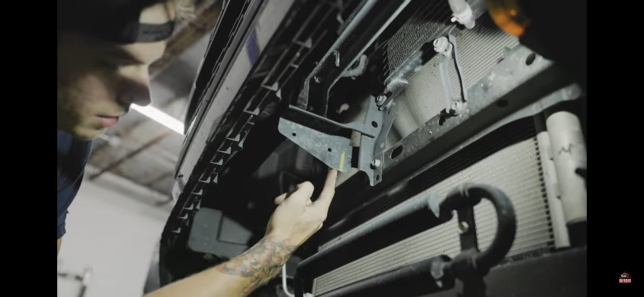

    did you relocate the Warn control pack from center or did you bend this bracket a bit like this SSO video says
    go to 8:25 mark
    https://youtu.be/7nDh4vvazH8

    I wish I had watched this video, from his perspective, the piece he cut, I Pried off the rivets and bent that entire bracket towards the passenger. It’s still plenty stable without it installed. I’ll eventually cut it out and add 2 brackets when I add the brackets to hold my SS5s for the grill.
    for certain the thing had to be moved, I needed 3/4” - 1” of area removed to fit it when we tried to slide it on. Tomorrow sometime I’ll go grab a flashlight and a picture.

    So it looks like if I do what he shows. Cut 1.5 inches straight up and then bend it over it should give me the clearance I need.
    I was thinking to bend it toward the drivers side instead of the passenger side like he suggests. That way it will sort of box in the bracket since it offsets to the passenger side. Get what I am saying?? Hopefully that was clear :)

    ** UPDATE**
    Even after I did the trimming to the bracket shown in previous post, the winch solenoid pack would not fit. So scratch that idea. Maybe a different Warn winch would fit but the EVO 10S pack will not.
    So I mounted mine like Classy Tacos

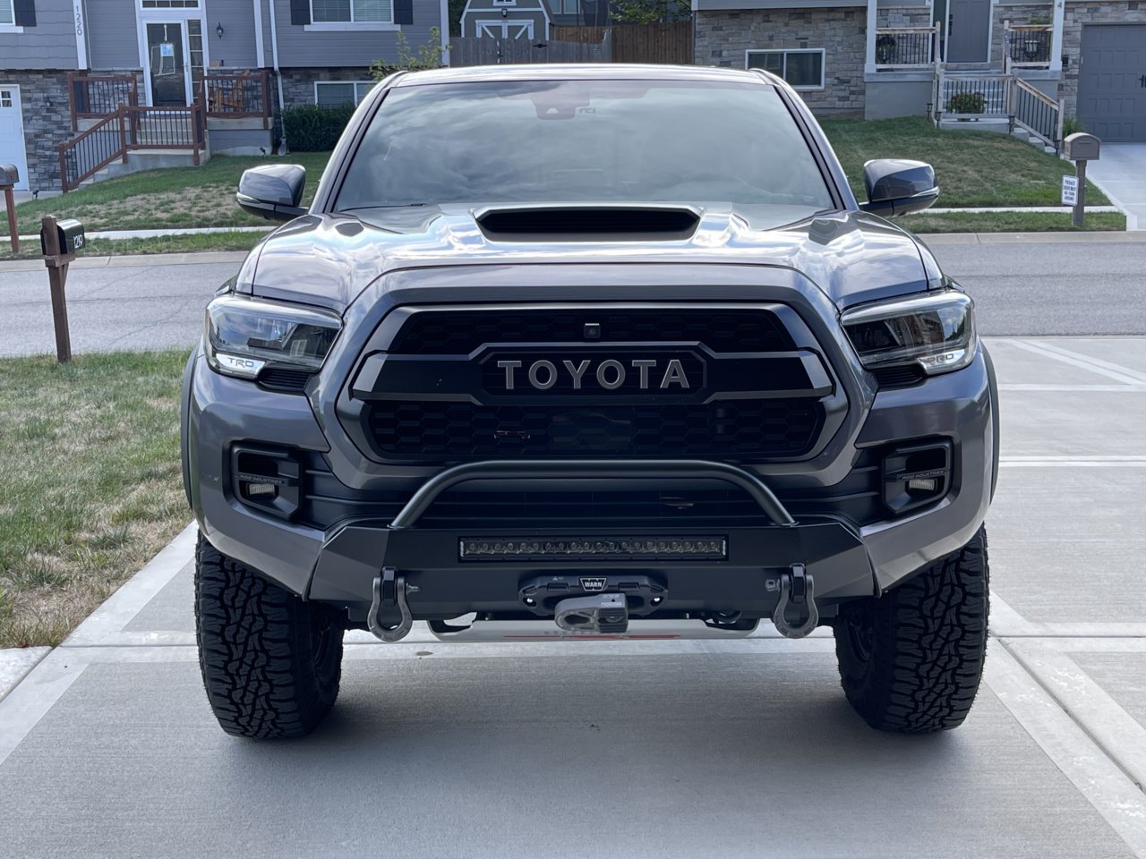

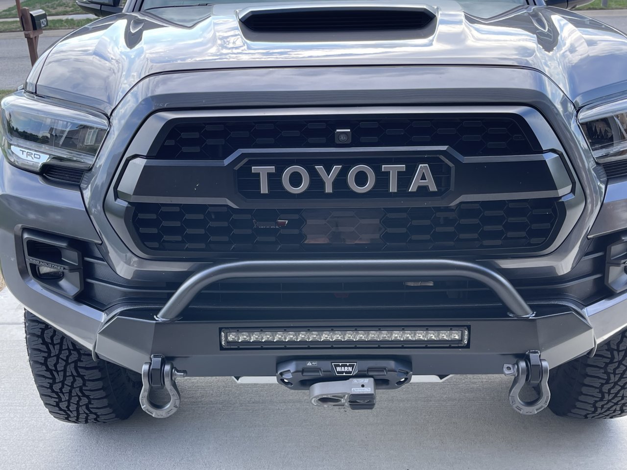

    Install done. Warn VR EVO10S, Warn Epic Fairlead, factor 55 flatlink e

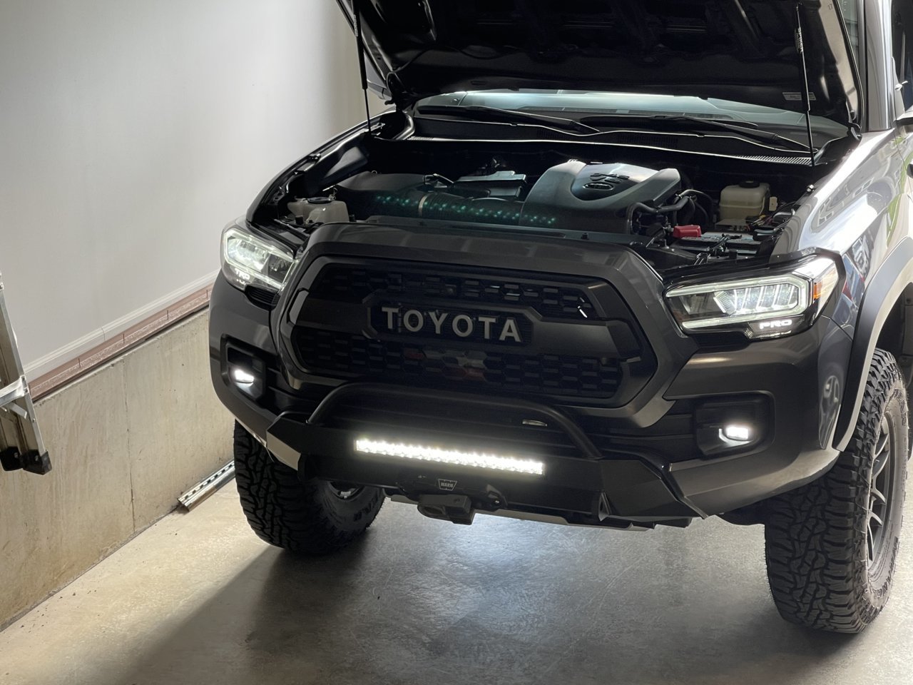

    Rigid 20” Midnight edition.
    light temp output matches the fogs and headlights

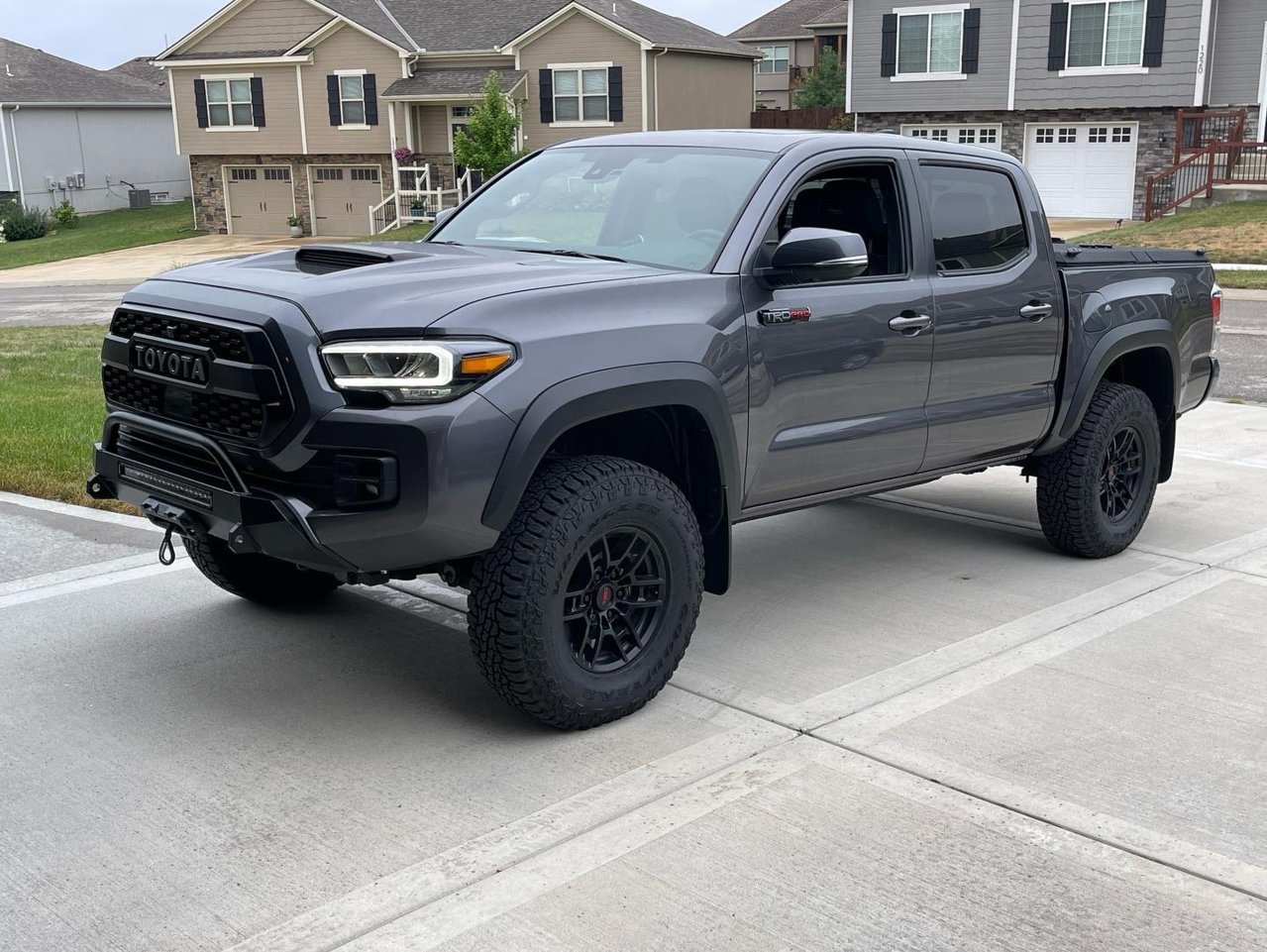

    Few more pics with the flatlink and warn shackles
