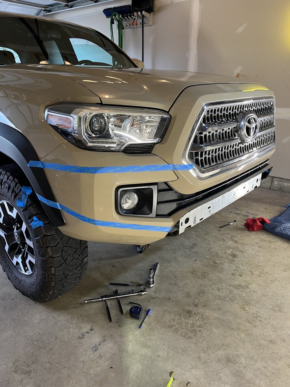

    Finally arrived and installed. Tube style with BD cutout.

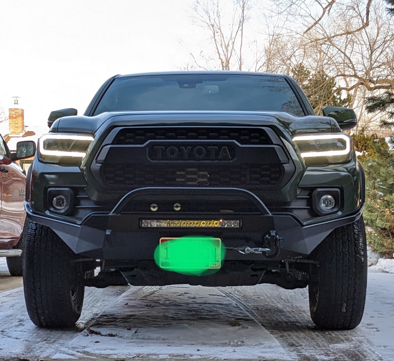

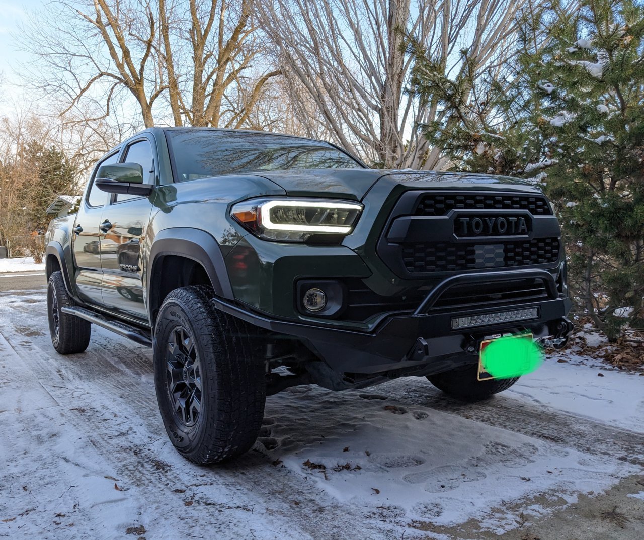

    Just got it done! Looks exactly how I wanted! Super excited to go winch some stuff :bananadance:PXL_20221218_222002195~2.jpg PXL_20221218_222025074~2.jpg

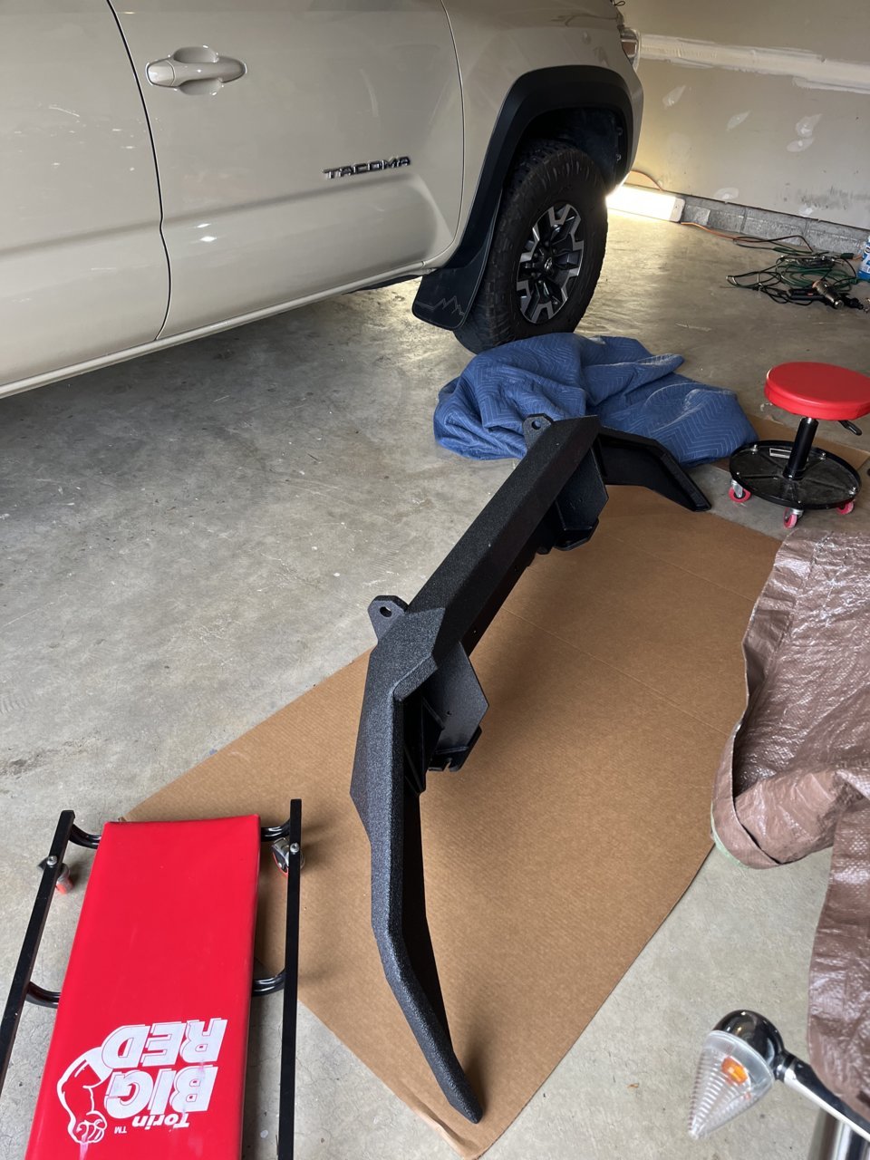

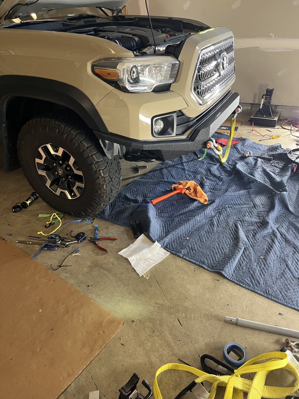

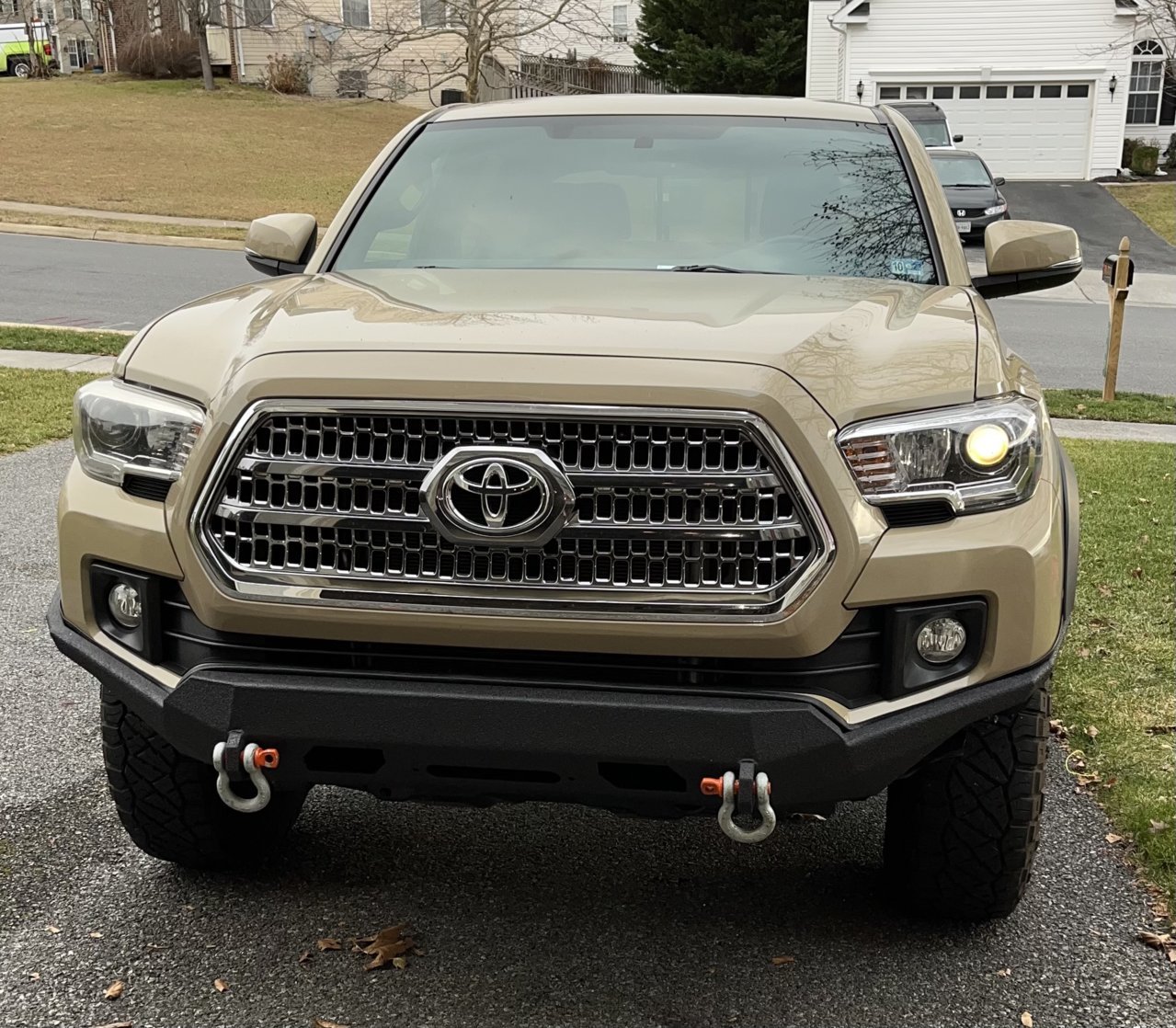

    Received my full plate last year just days before deployment... Back home and found time to install. Got it coated by Bulletliner. Very happy with the end result!

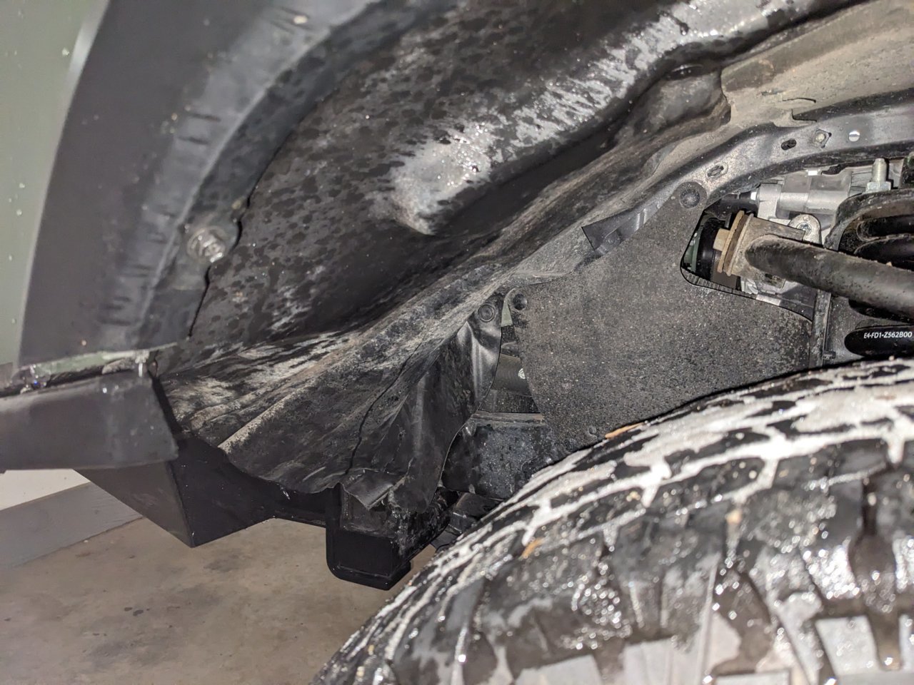

    To install the full plate with wings like that. What do you do with the fender liner when you cut over the flare etc ?

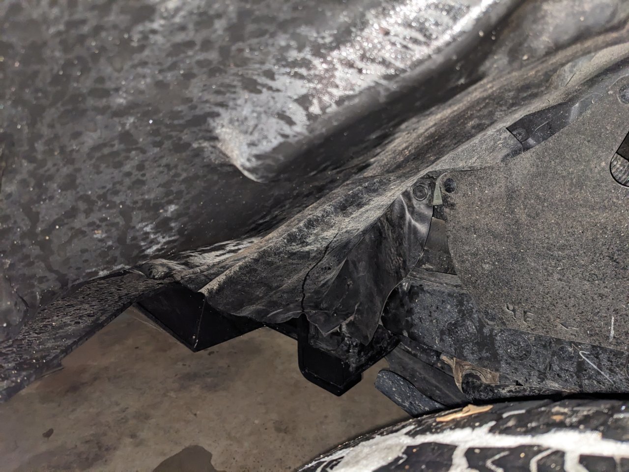

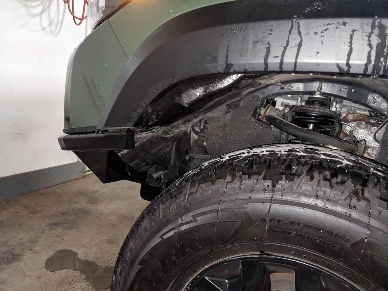

    I cut the bottom of the fender liner at the end, where it makes an almost 90. Then I used a heat gun to soften it up and and slowly mold it to fit. Then I tucked most of it into the bumper and zip tied the inner part to the inside of the wheel well. I think it came out pretty good. I could probably work on it a little more, but it's doing what it's supposed to right now.PXL_20221224_024211525.jpg PXL_20221224_024115125.jpg PXL_20221224_024039920.jpg
