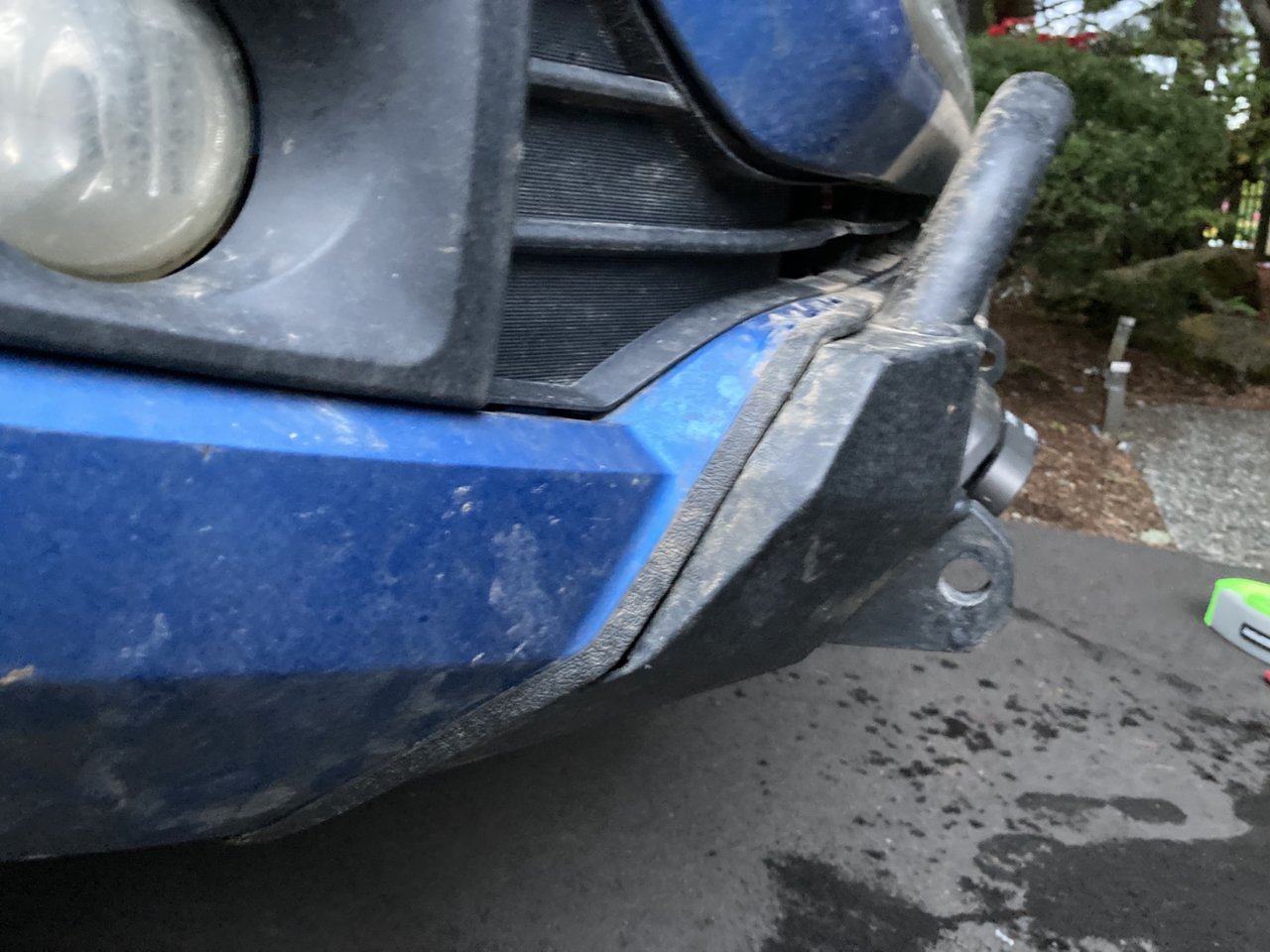

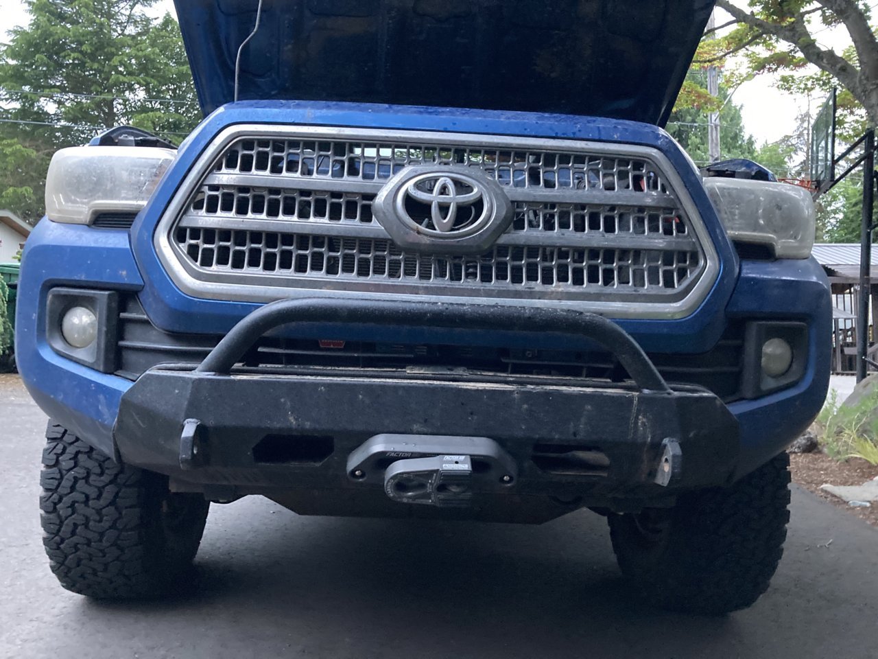

    Hey gents - I'll post photos when I get the truck cleaned up - but my install of the SSO Slimline Bumper with winch and access hole cut-outs (no lightbar) went fabulous - thanks to the OPs amazing instructional.
    I placed a Warn XP-S 9.5 winch with control box in the 'stock' location (side mounted) and did not have to move or cut anything with the exception of small relief in the grill/bumper support frame so I can access the hand control port for the winch. It looks amazing and this bumper is a work of art. I opted for Anderson connectors between battery and winch, so I mounted those connectors as well. Incidentally, I have a full set of steel Mobtown skids and there were no conflicts with the Mobtown mounting positions.
