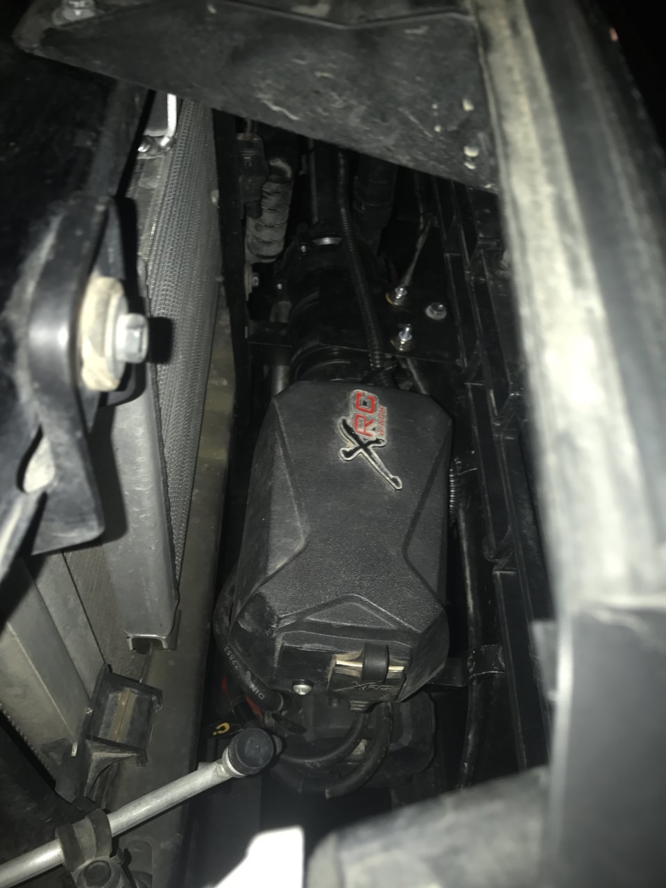

    Did you have to relocate the winch box? - if so where and how?
    Which winch did you install and what modifications did you have to do to fit the control box? relocation? where and how?

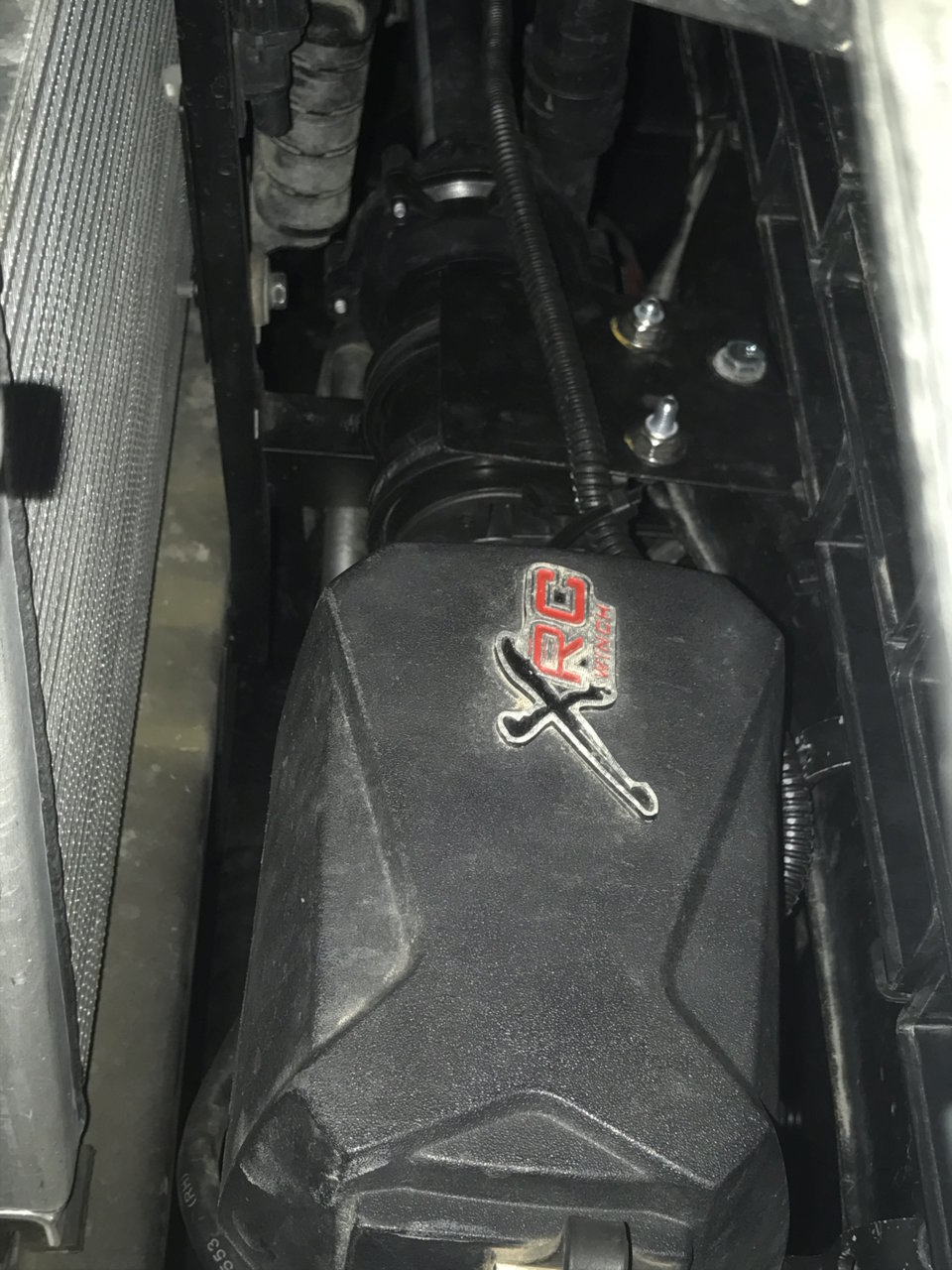

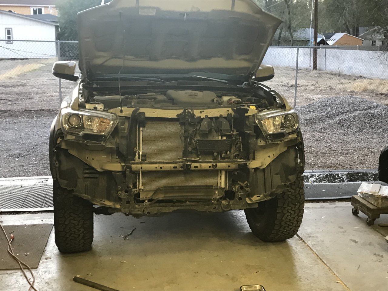

    @ramonortiz55 - I've switched back to a 2015 from my 2017, but its essentially in the same spot. I used those wimpy little brackets that come with the winch. i bent them into a "L" shape and bolted them to the bottom of the control unit (using the existing hex bolts that hold the cover on the control unit) and then bolted that to the cross member that goes in front of the radiator. I used 1 existing hole (on the left side) and drilled another. Its tight, but the cables will reach. Although I didn't like having to reach my arm down in to plug the controller in, it worked.
    The two top pics are my 2015. As I mentioned it'ss located in the same-ish spot, but now it is mounted to the front grill support.
    Smittybilt 9500lb winch.
