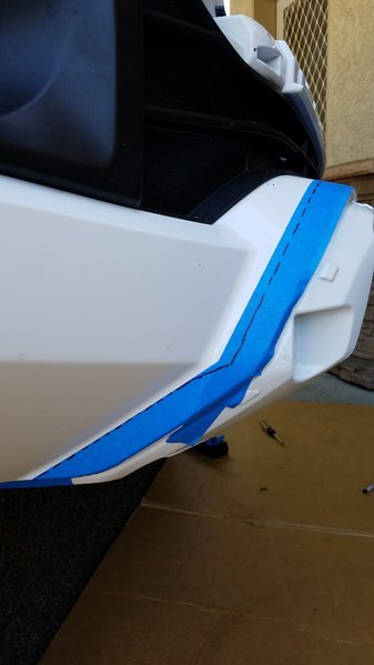

    The cut is nerve racking to start but with a dremel and a rip saw blade(i didnt try a cutting wheel because I've seen how much it melts plastic during other projects not on my truck and I didnt want to melt the bumper but actually cut it) its cuts very smooth and easy to do. My truck was only about 6 months old when I made the cut and it was my first cut into the truck. I was also a few beers in.:cheers: Just take your time and dont rush the cut and it becomes very difficult to mess up from my experience.

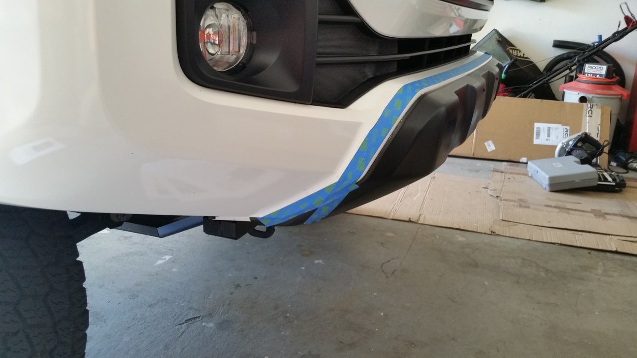

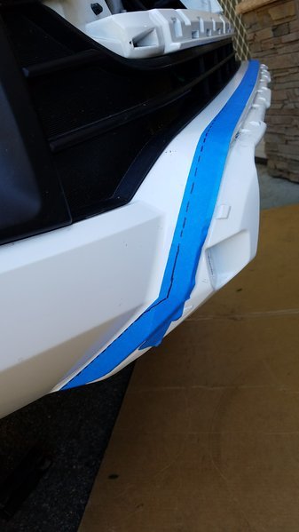

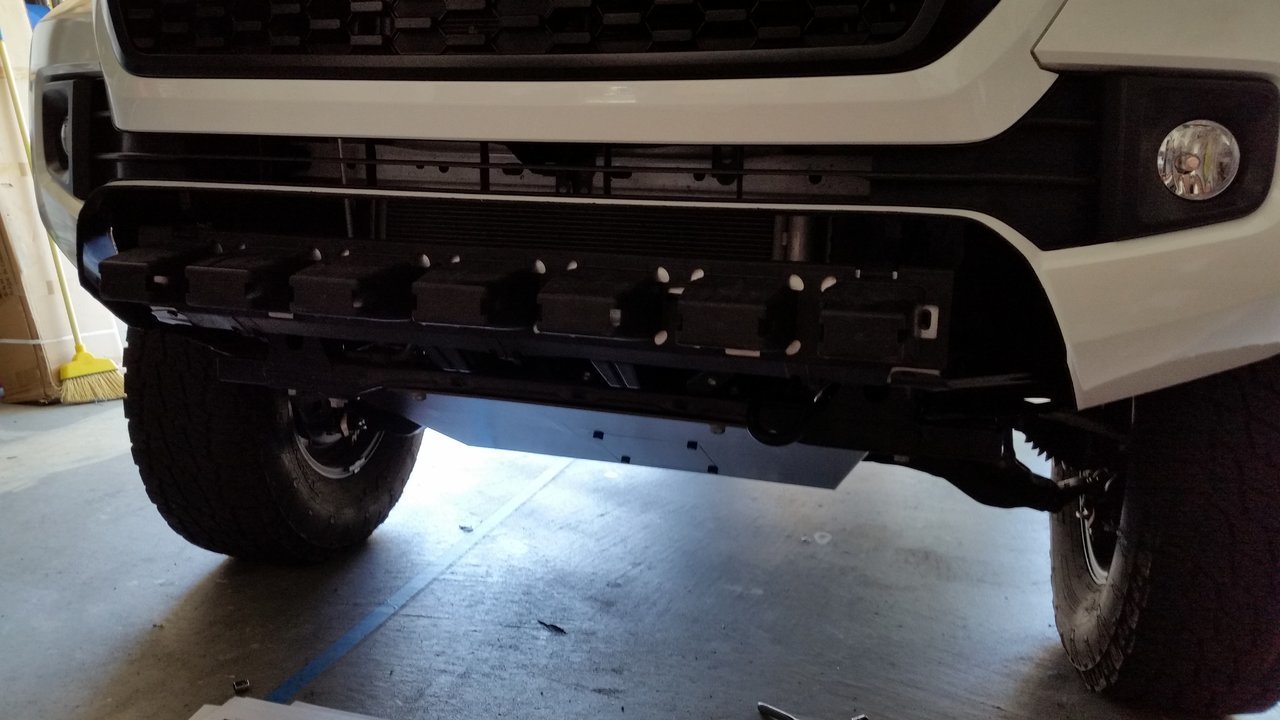

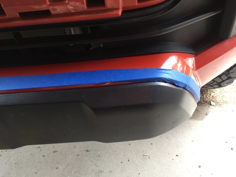

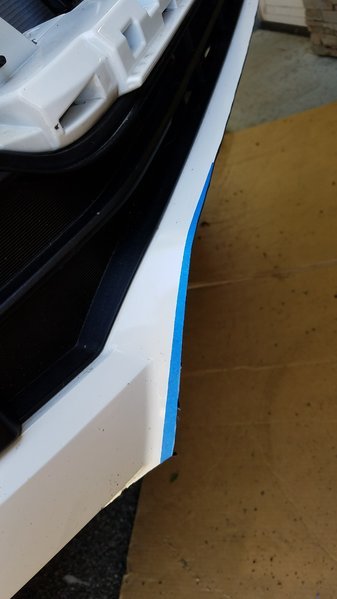

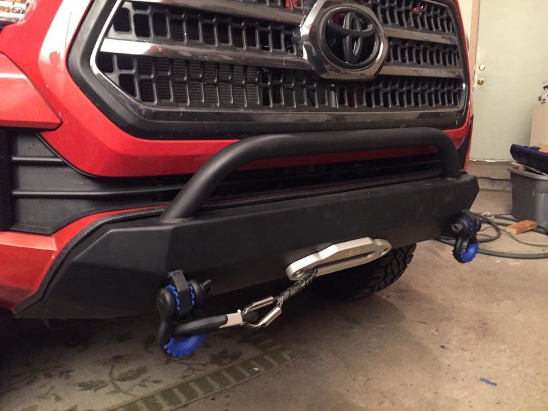

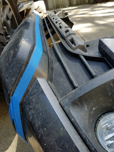

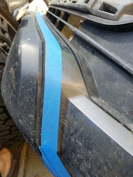

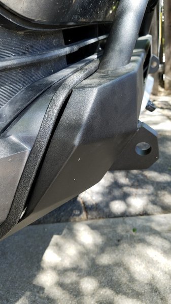

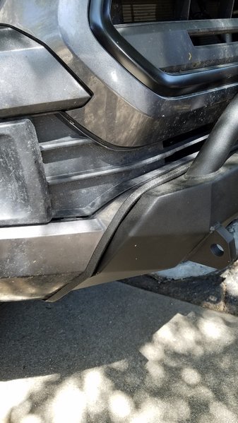

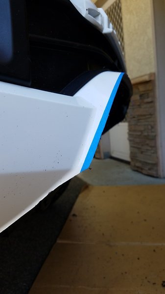

    Its not so bad, you just have to start!bumpertape2.jpg b1.jpg b2.jpg b3.jpg t4.jpg lic brac.jpg JUST DO IT!

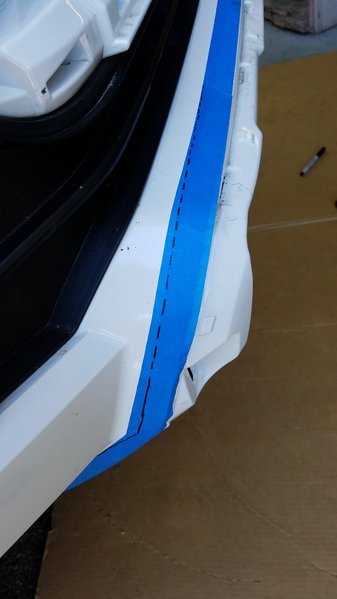

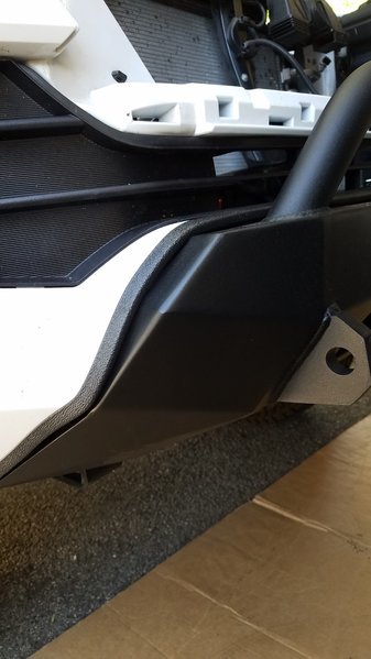

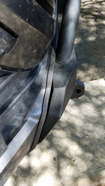

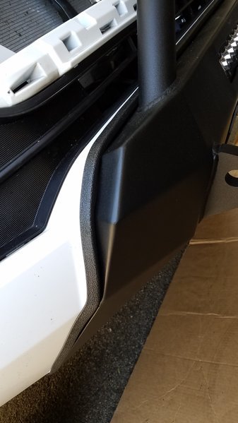

    Heres 2 posts from the last group by that show tapering the corners to eliminate a small gap. I would go this route vs the instructions because its easy to cut a little more but impossible to cut less without buying another bumper.
    Thunder Fist likes this.

    Thats exactly correct! Cut less at first test fit the molding and bumper for how snug the trim fits around the bumper, have someone hold it in place and check all along the cut line!
