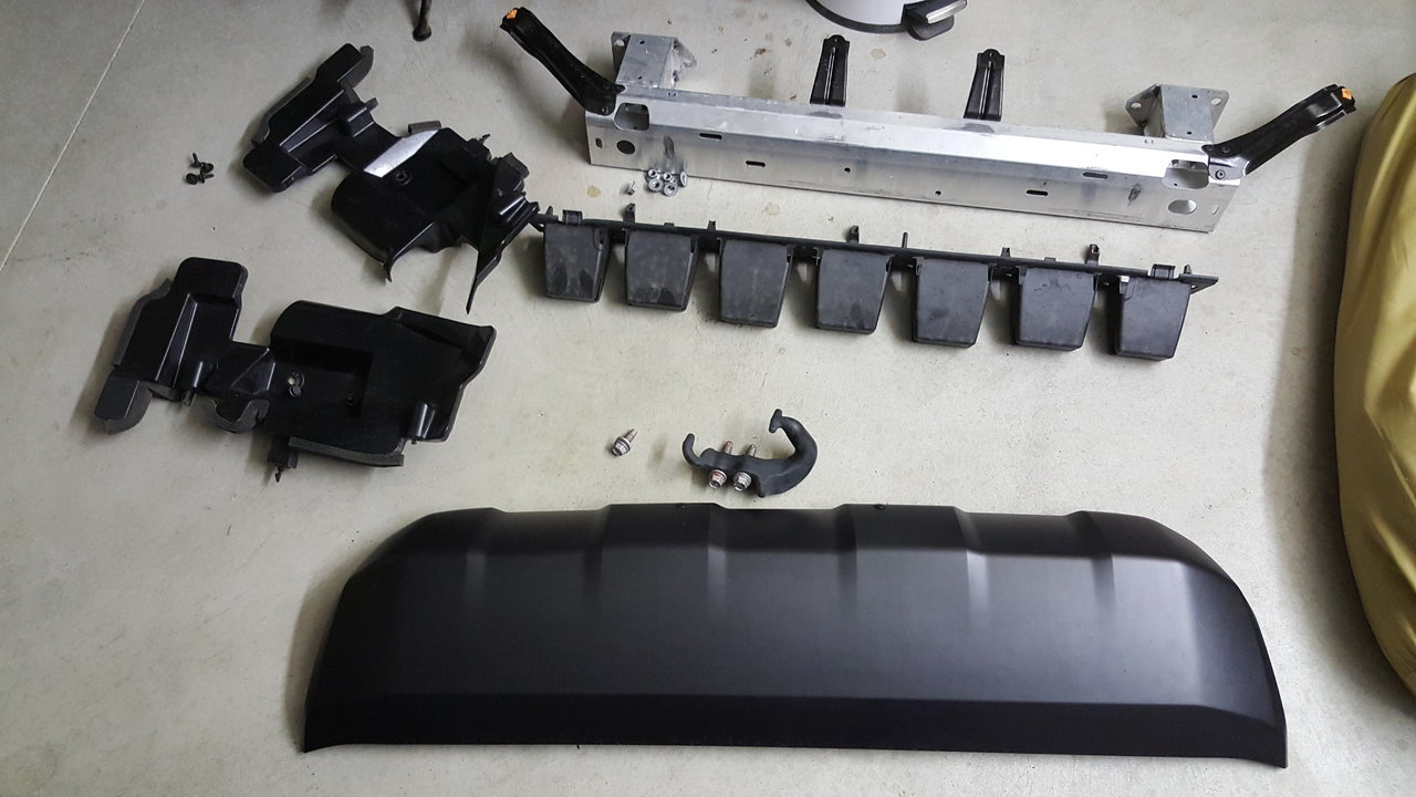

    20170806_202830.jpg I got mine on Tuesday. Started to install it today. Got the cutting done and everything removed from the truck that I needed too and nothing that I didn't, I think? See picture attached. Tomorrow I need to install my winch and light bar on the bumper and bolt it to the truck.

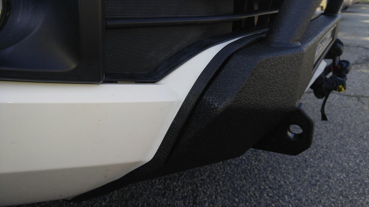

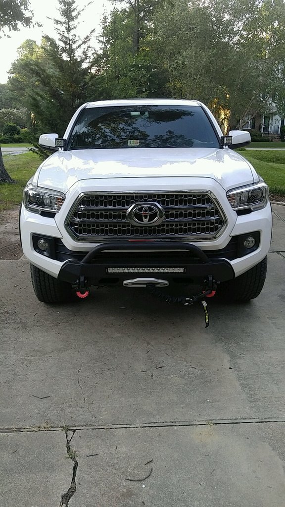

    The install went smooth.

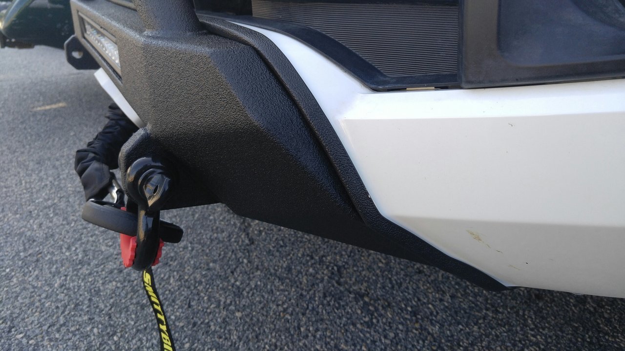

    Looks fantastic. How long did it take? How do the cuts on the original bumper look? Any gaps?

    Gaps are really good. Nice and tight. The trim definitely helps. I cut the bumper with it on the truck. Start to finish was 4 hours, but i was by myself and I had the bumper Line-Xed. So, getting the wing bracket screws into the holes was a pain.

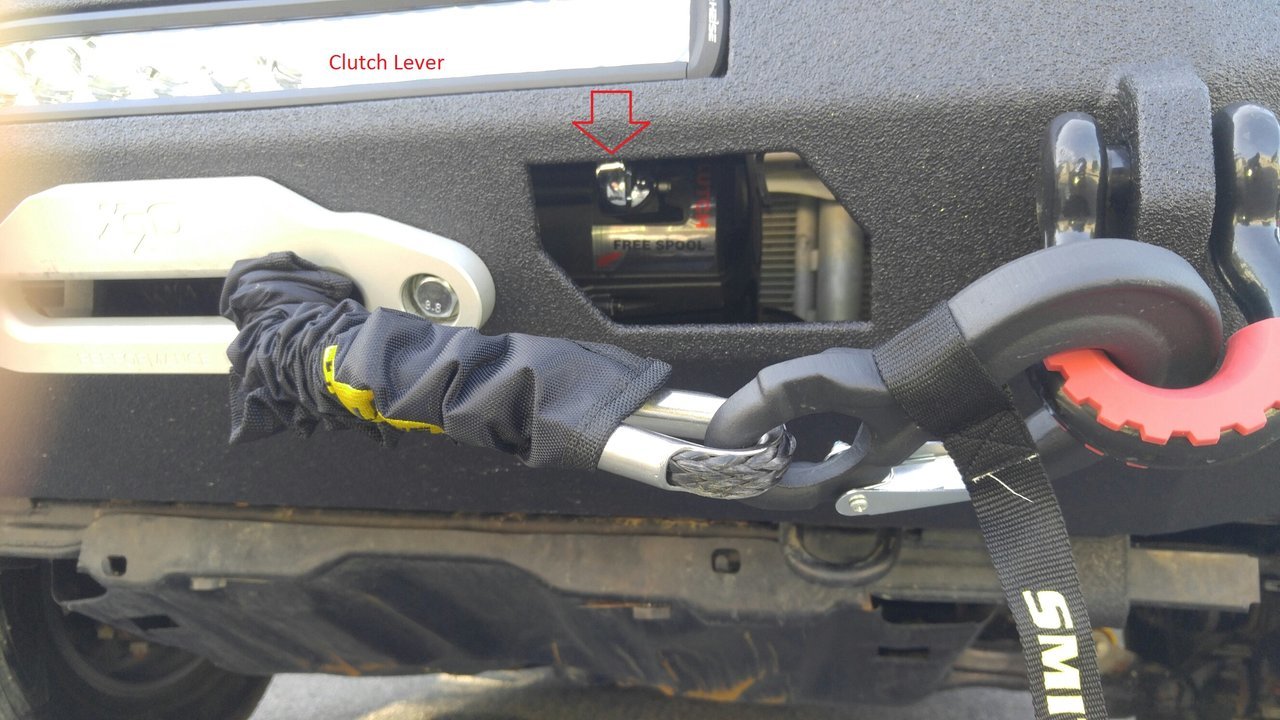

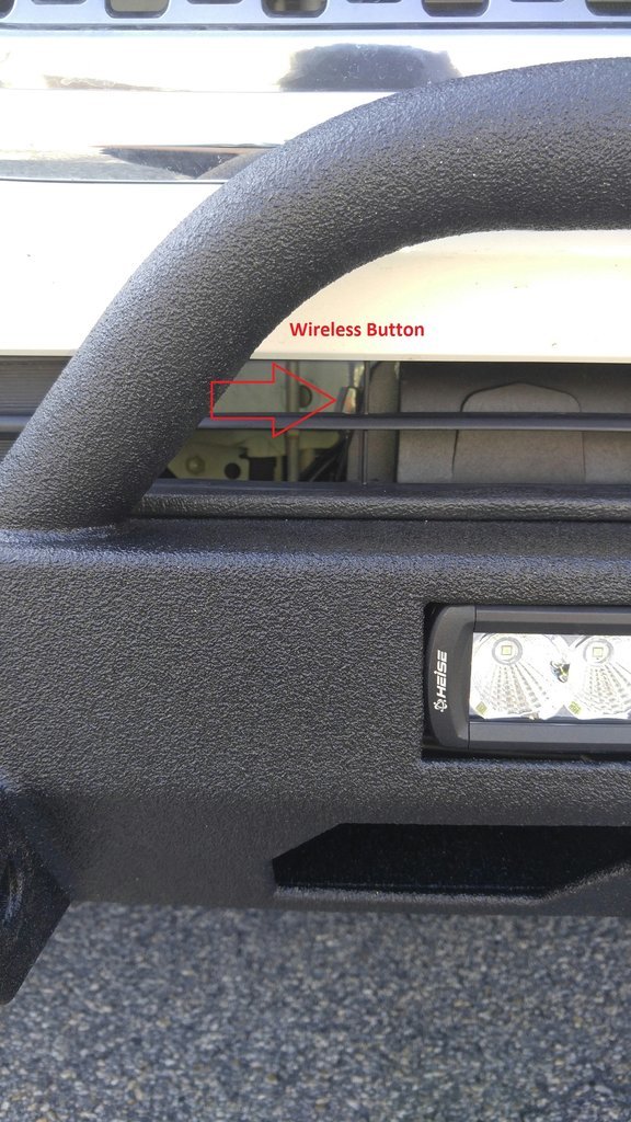

    For those of you using a Smittybilt X2O, I clocked the gear housing 90 deg to put the clutch lever facing forward. With the cutouts, this makes for easy access from the front of the truck. You can also reach the wireless switch on the control box with it mounted over the motor.

    Looks sick yoshi, in order to turn the clutch housing i assume u unbolted that side of the winch turned it and bolted clutch assembly back on?
