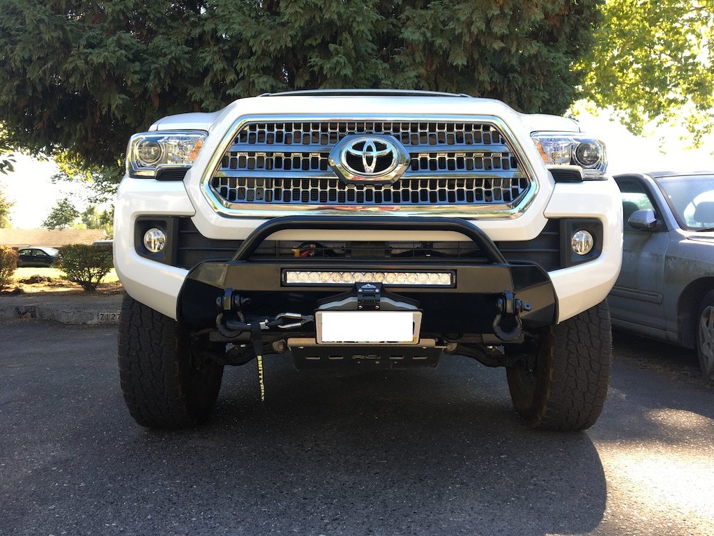

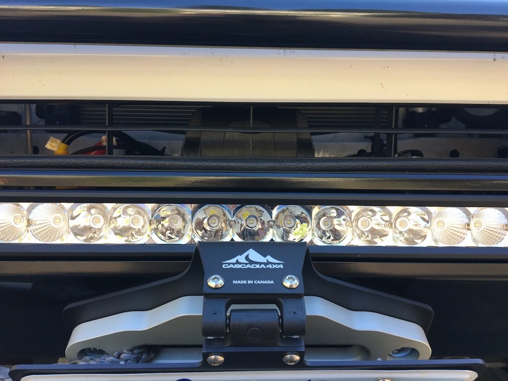

    Its unfortunate that the install cut line update just came out since I cut it last weekend.
    But on another note, I installed the bumper and winch, came out nice. Only thing I'm not stoked on is the license plate, I got the Flipster V2, but the bracket blocks the light bar slightly, anyone have some ideas on how to make it not block the light? Also, I'm in Oregon, I need a front license plate but anyone get around with mounting it to a different location in states that require it?

    I think I have the same plate mount but it mounts directly above the fairlead? I'll check when I try to install it tomorrow.

    Mine mounts behind the fairlead as well but it has channels that the bolts fit into and that's as far as it goes down if that makes sense. I was thinking of maybe trying it upside down? Not sure.

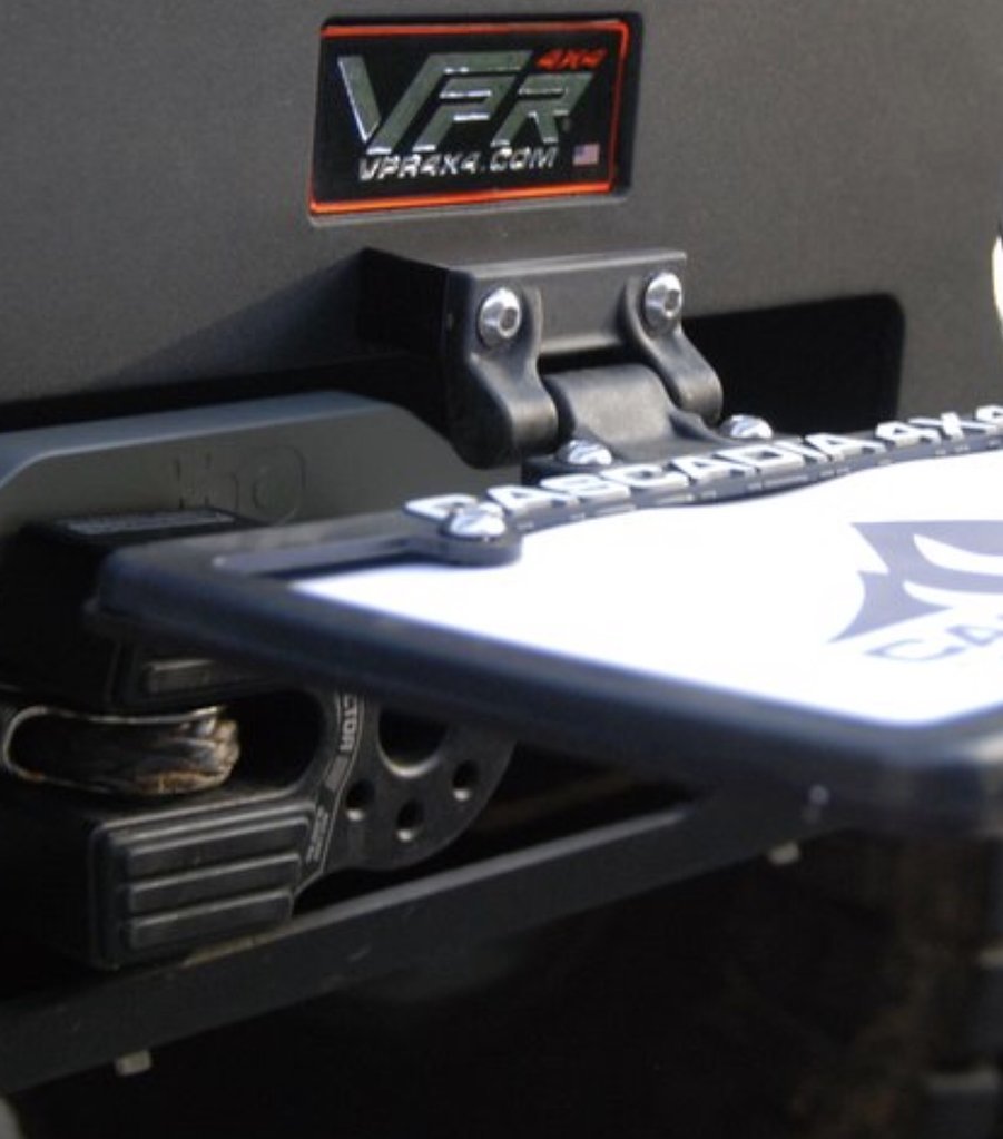

    Your setup has a rear backplate that mine didn't come with. Just a 2" spacer that mounts directly over the fairlead?
    Here's a pic from a Cascadia. I have this mount.

    Oh interesting, I have that spacer as well, I just assumed it was for big rollers or something. Your bumper just has holes in it, I guess I could drill some. Hmm.

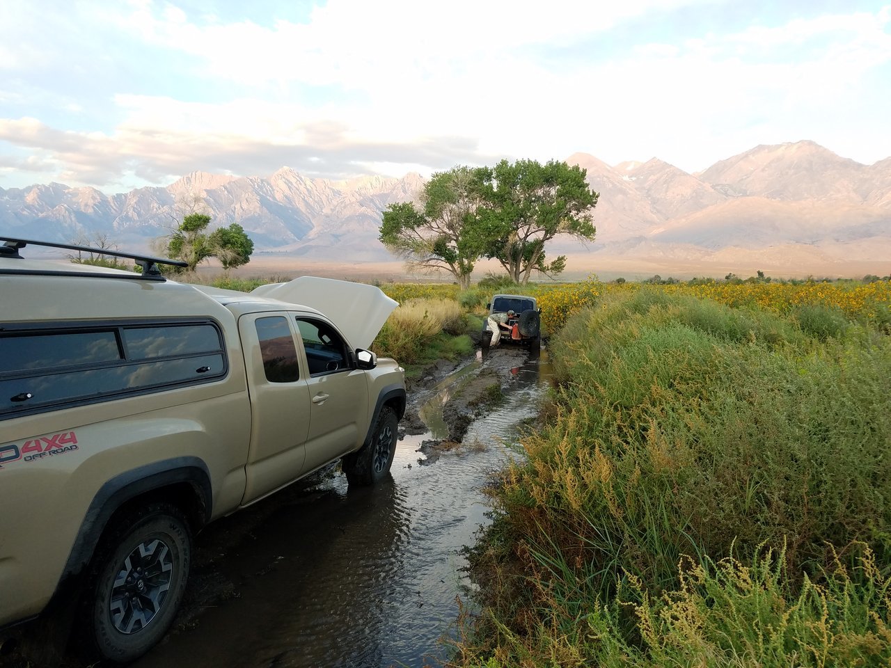

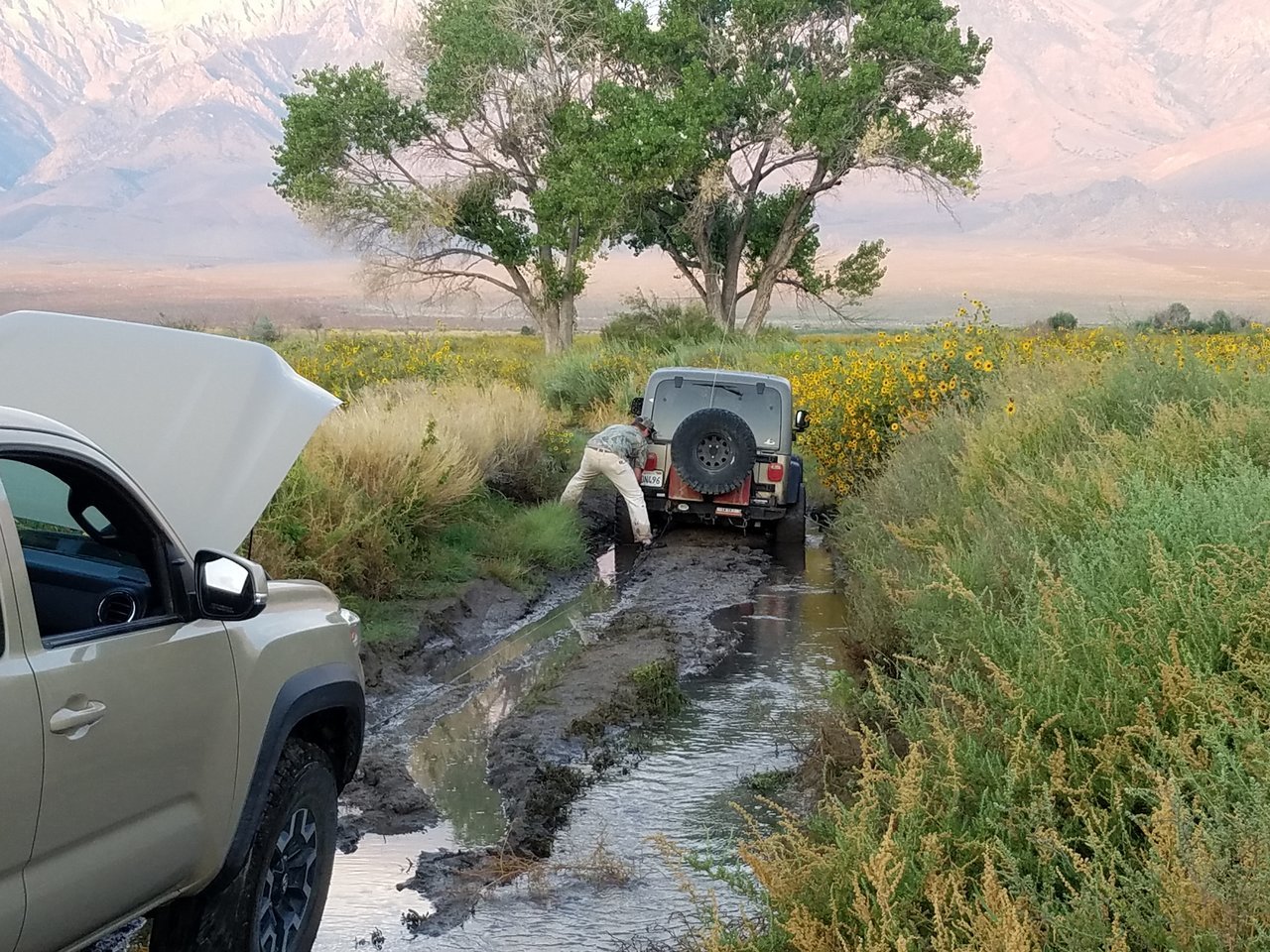

    My newly installed SSO Slimline bumper and Smittybilt winch came in handy yesterday as I winched out my buddies' Rubicon.
    Thanks Southern Style Offroad for the group buy!
