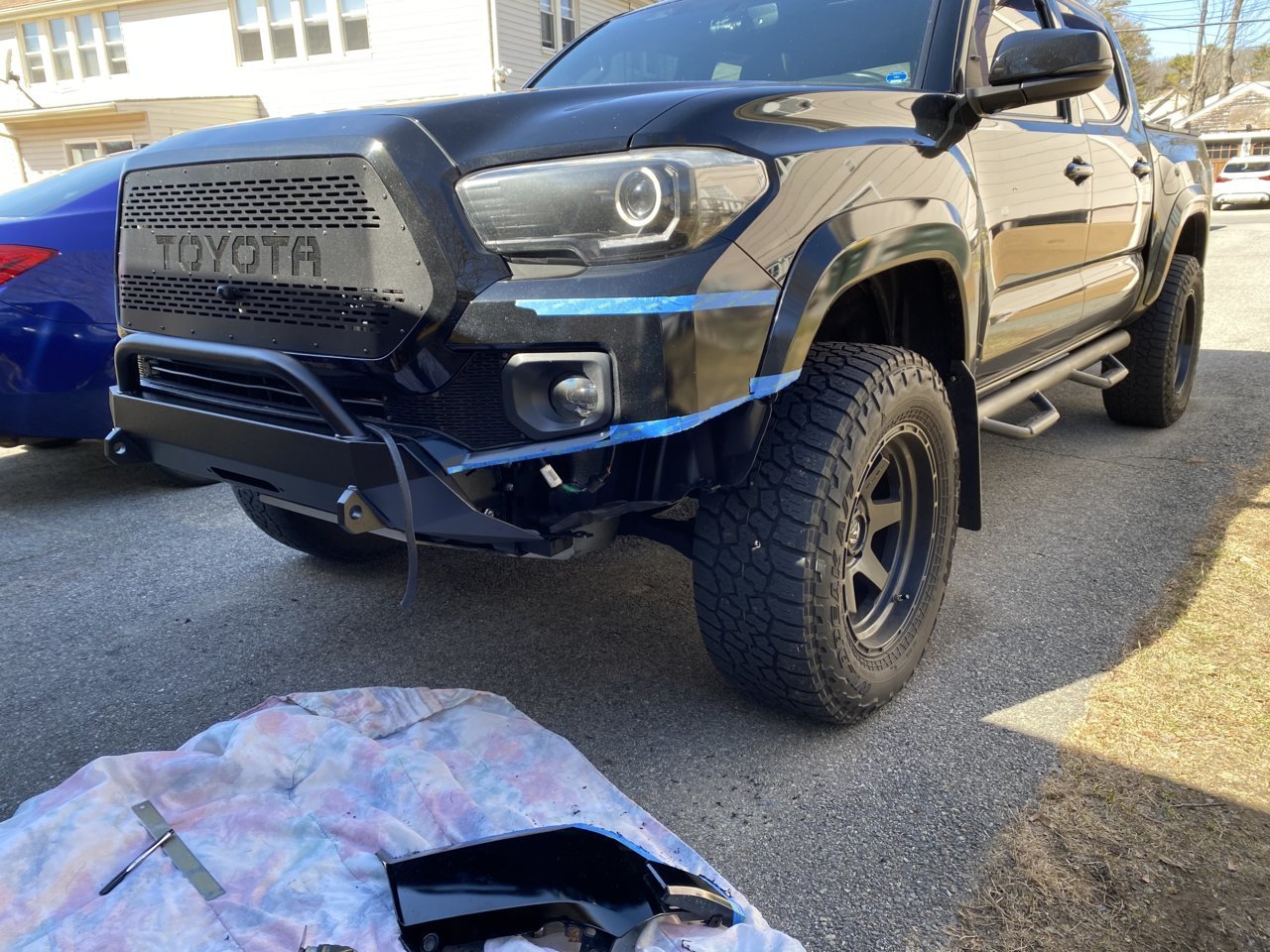

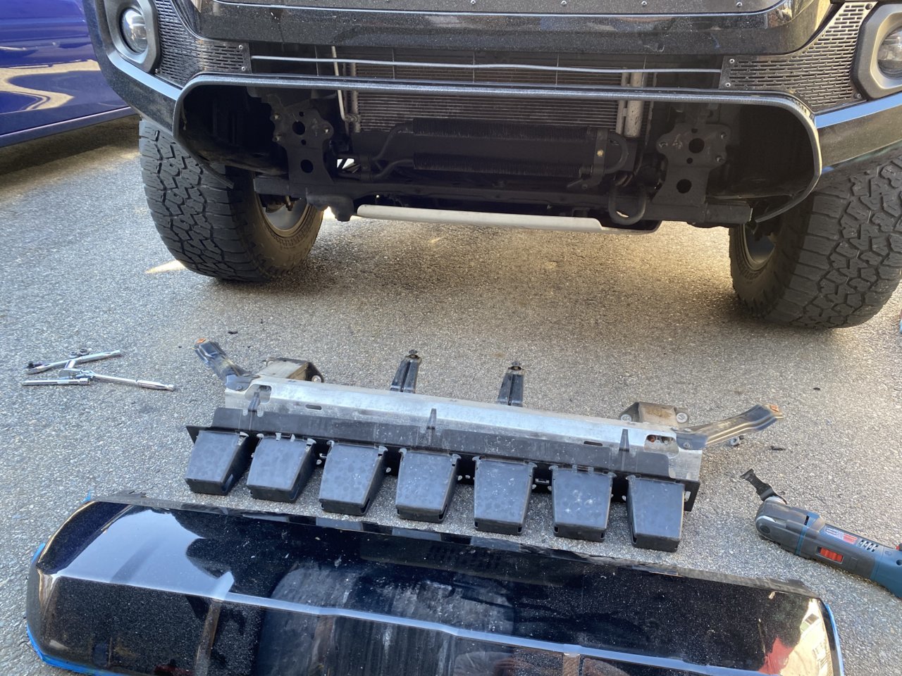

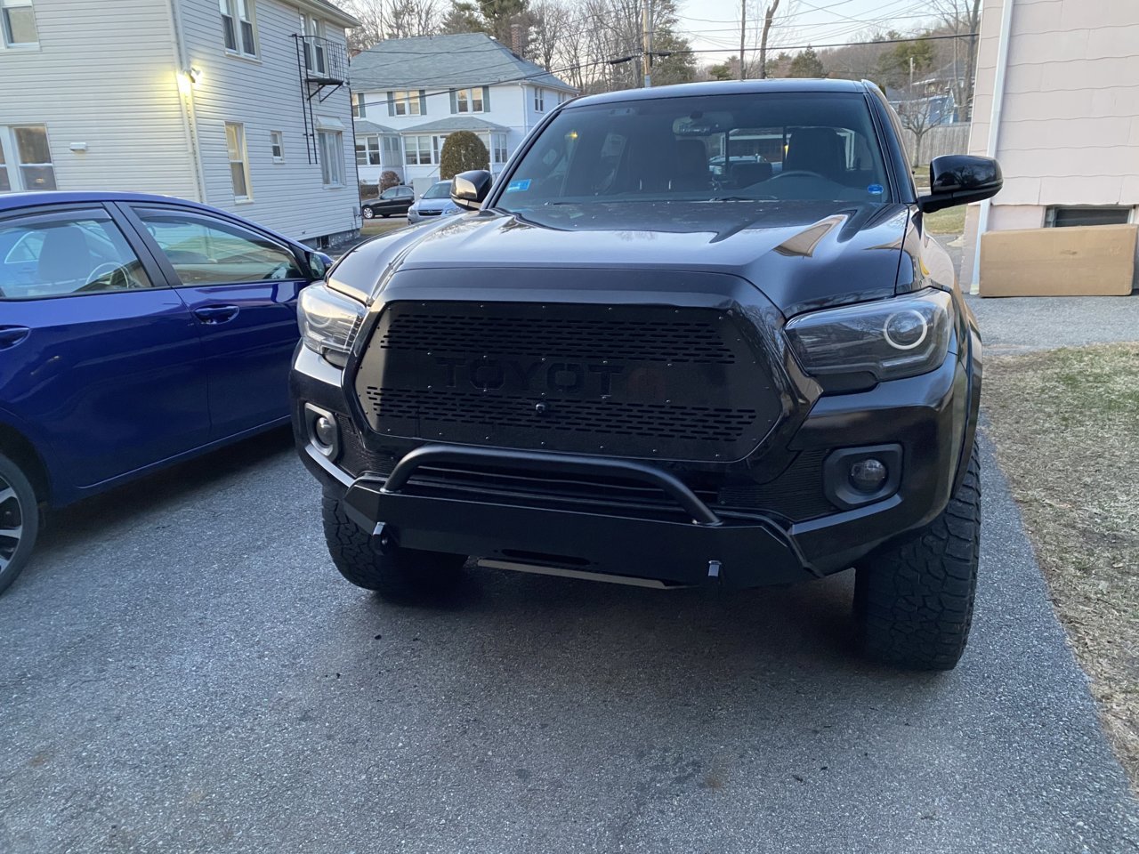

    I installed my SSO without removing the OEM one. Just ripped the black valance off and started cutting

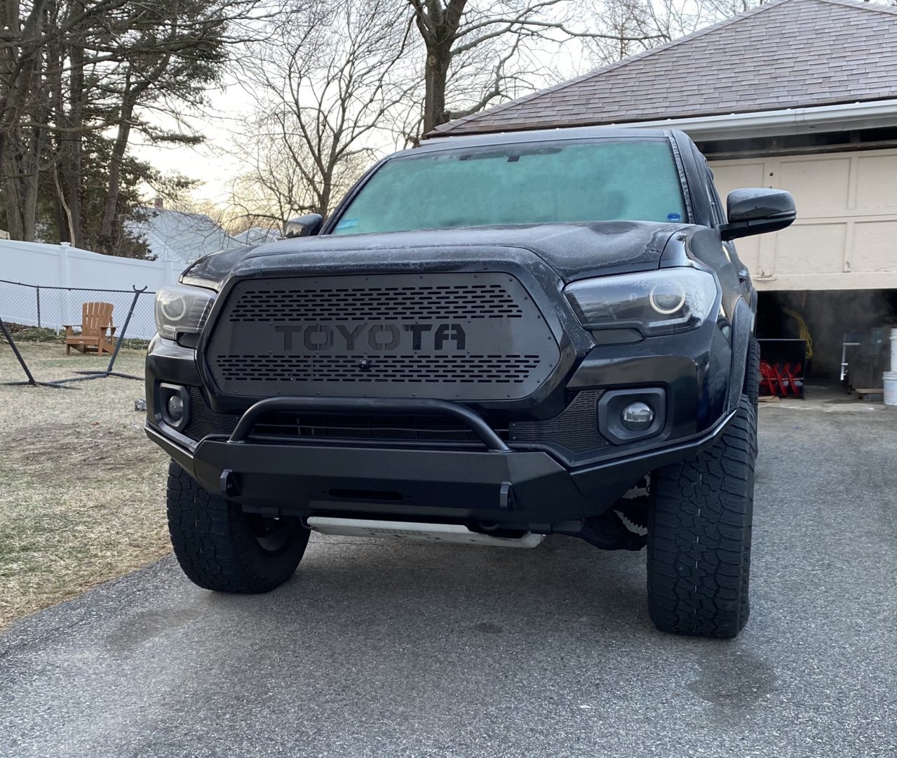

    This is all you need to remove for the SSO bumper:
    Extensions:
    danojeno, imjustabill1970 and Skydvrr like this.

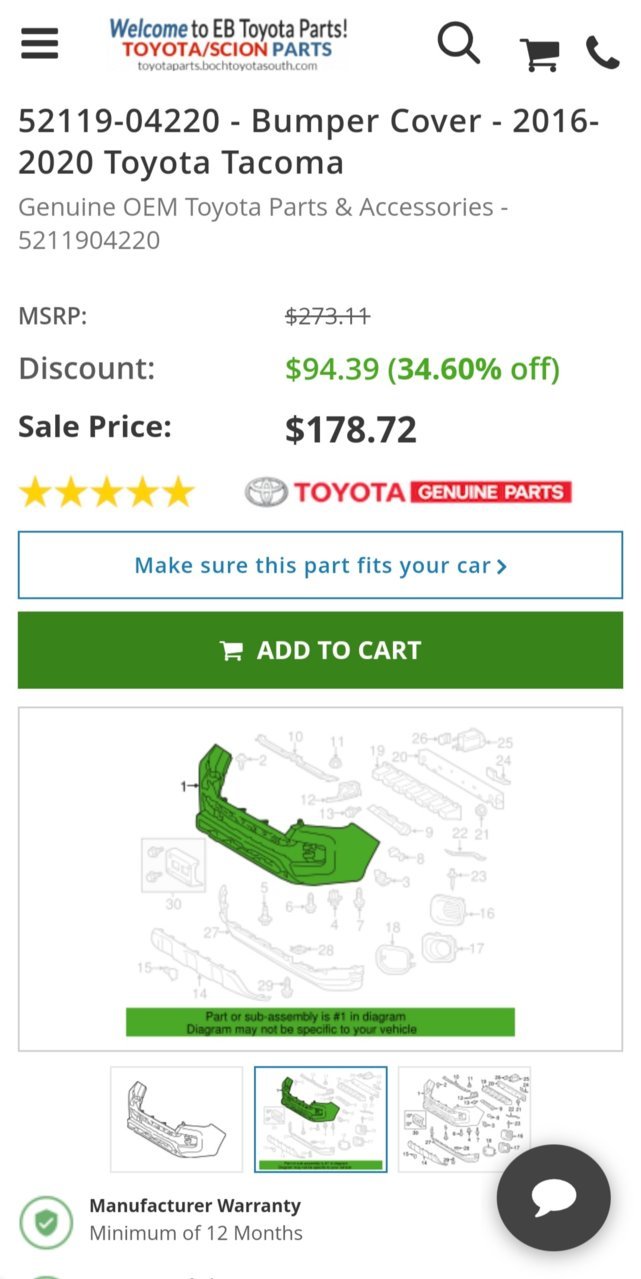

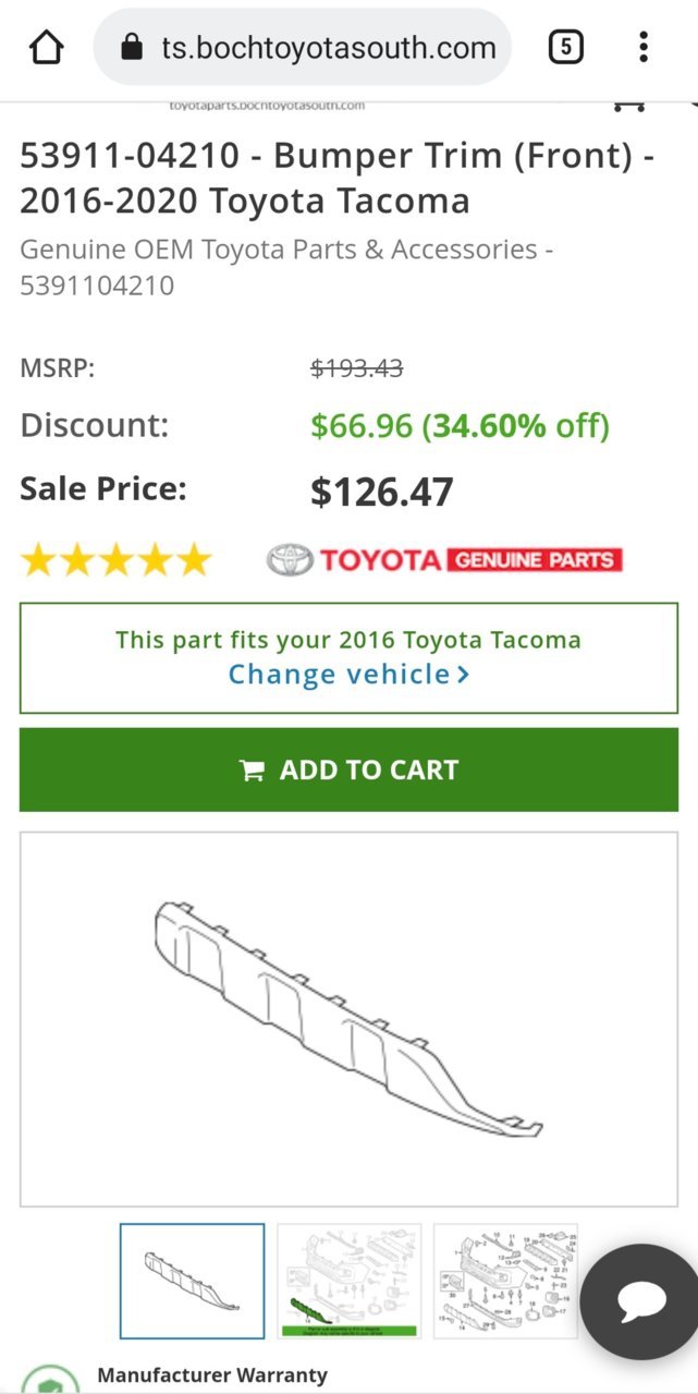

    That's the bumper cover.

    No. That's the valance or "trim" as Toyota calls it. The bumper cover is the entire plastic bumper cover that stays on the truck.
