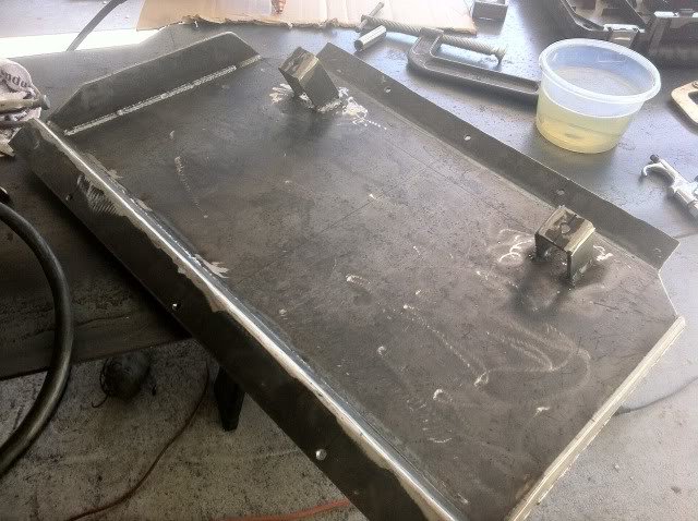

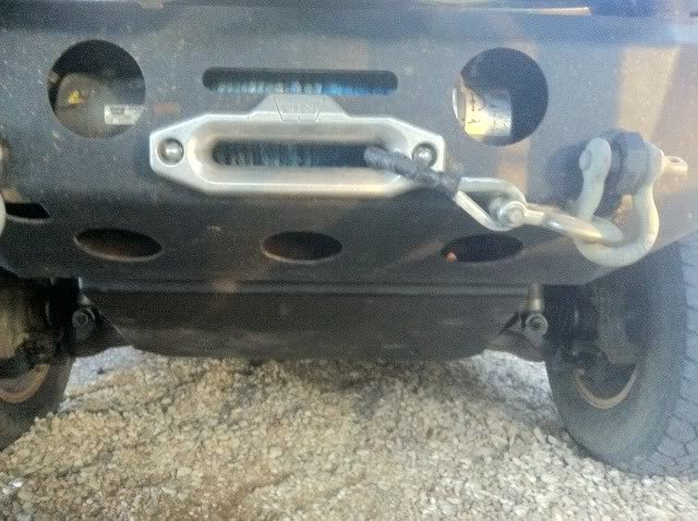

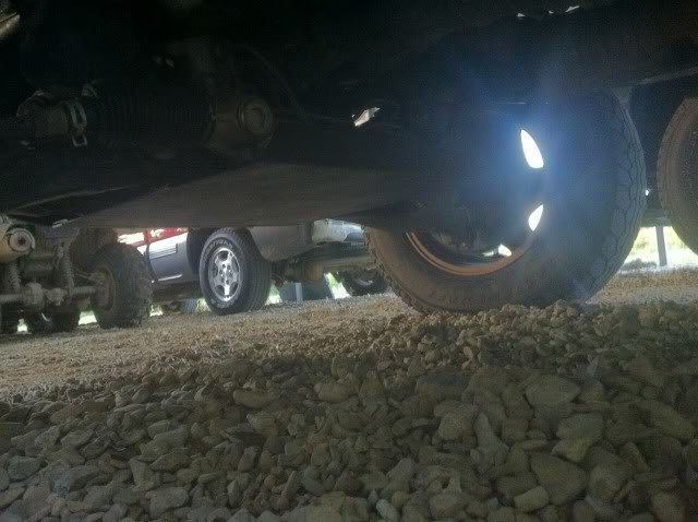

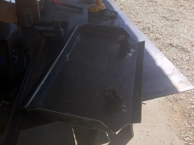

    Yea I might go to that. I was planning on going on memorial day weekend but going to RR will give me an extra 2 weeks to prepare.
    On another note, I finally got off my ass and started my skid plates. I'm just about finished with the bash plate. I'm going to try to finish it up tonight. Then do the oil pan and transmission pan tomorrow. Then next weekend, I will try to make the transfer case skid and beef up my gas tank skid. Here are some pictures of the progress so far.

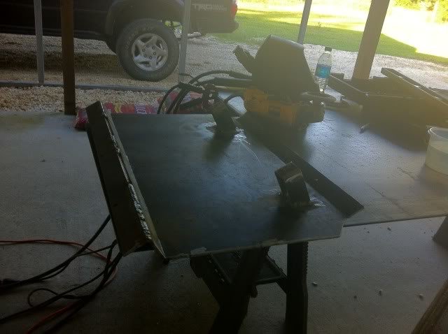

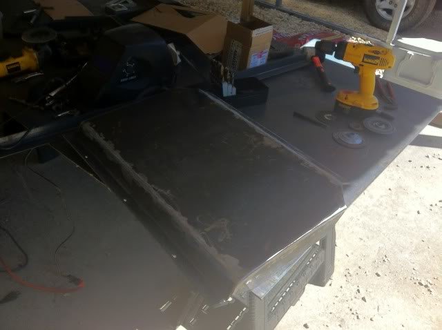

    Yea I can't make both either so now I just need to decide which one I want to go to.

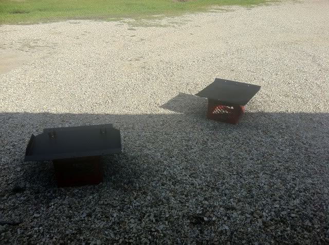

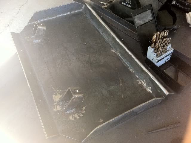

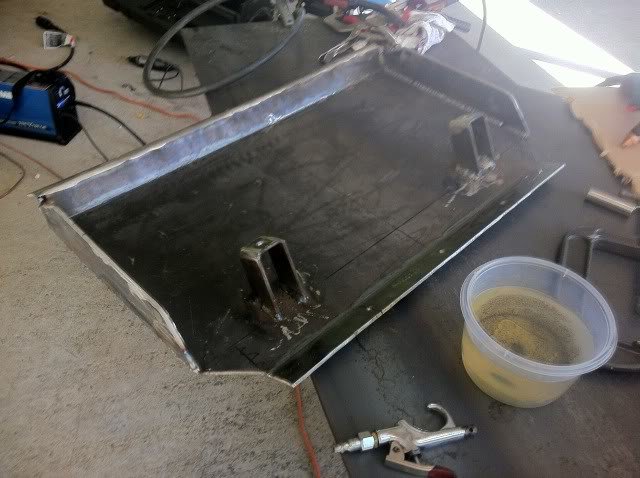

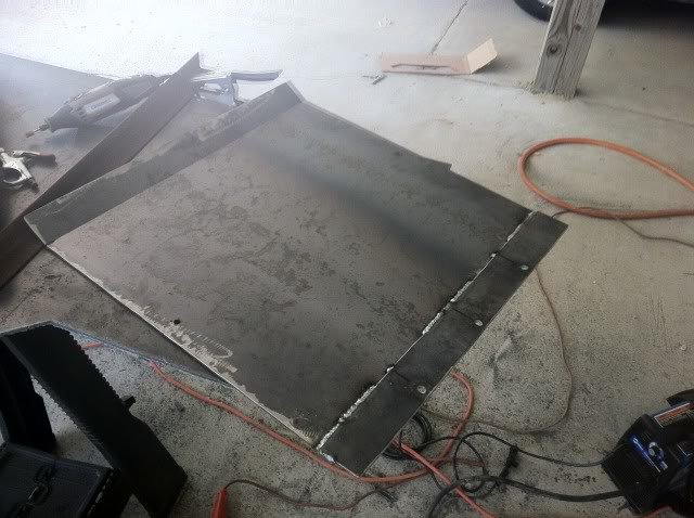

    I finished my bash plate and oil pan skid today. I didn't get to the transmission skid or the t-case skid. I think they turned out awesome. They are 10 times beefier than the factory stuff. On to the pictures.

    Dem skids look real nice! Well done my friend.

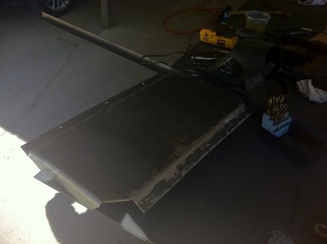

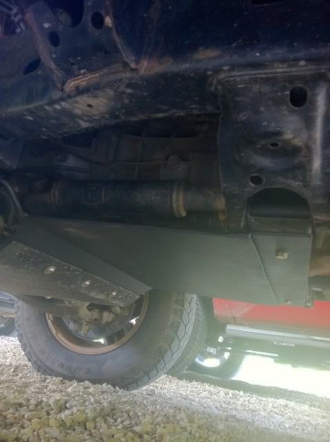

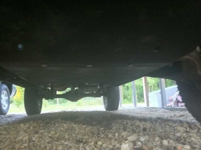

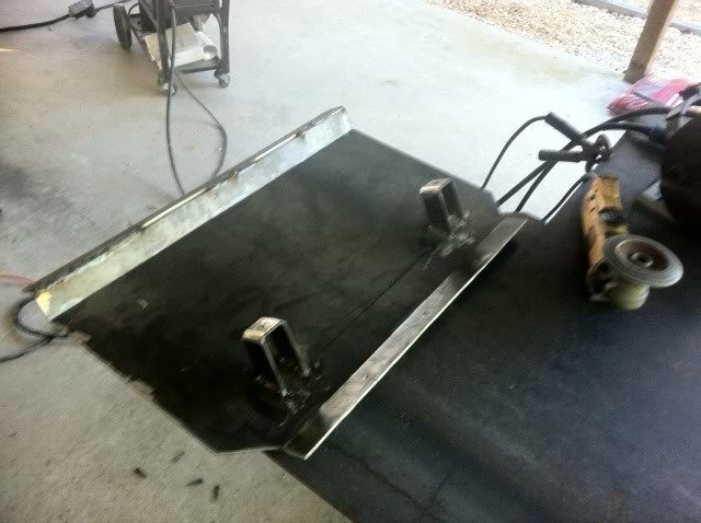

    I made my transmission skid yesterday. Now I just need to figure out a t-case skid crossmember design and make it along with a skid plate.

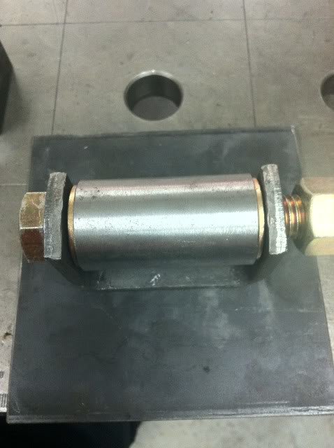

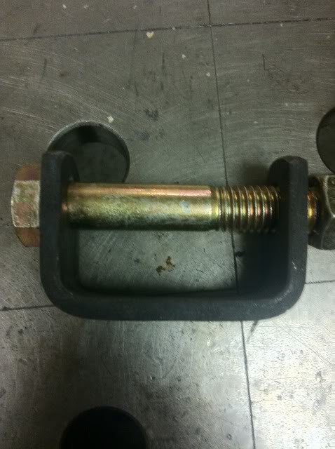

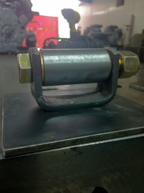

    So I started gathering parts together for my t-case skid crossmember. The U bracket is 1/4" thick, the bolt is 7/16" (I think), the DOM is really heavy, and I'm going to weld the U bracket to a piece of 1/8" thick flat plate that is cut 5" x 5" and weld that to the frame. The DOM is going to be the end of the crossmember which will probably be made out of 1" square tubing. Here are some pics. Does anyone see any problems so far?
