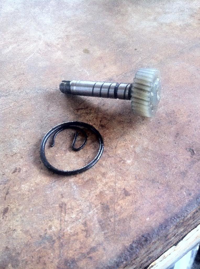

    Changed my speedometer gear to get my speedometer reading closer to correct.

    Lol it was a 5 minute job. It would have, literally, taken twice as long to pull my phone out my pocket and take pics lmao. Here are a couple threads that were pretty helpful though.

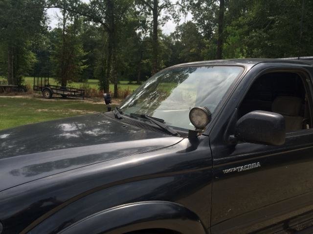

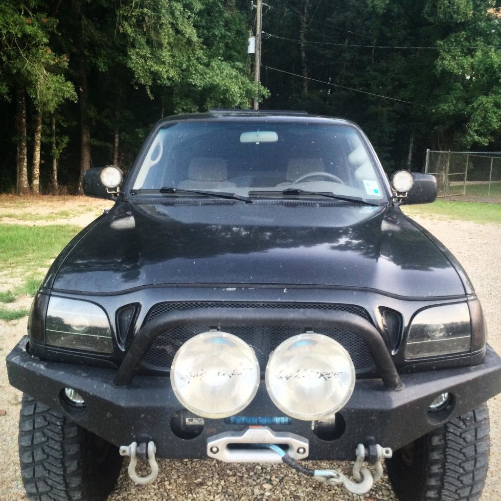

    Well, it's been a few months since I've updated this thread so here's what has been going on.
    I installed the CBI windshield brackets and moved my LEDs from the fog light holes in my bumper to the brackets and installed some 4" HID lights in the fog light holes.

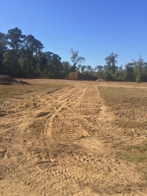

    One last picture that explains why this truck doesn't have the crappy ifs cut out and links, one-tons, dual cases and 42's installed yet.
    0C74E23D-0A50-40F8-9A4B-8621CE3966D3_zps_ef46441eb4e756bba863e0f9da5e461098065519.jpg

    Breakin' ground on the Maison de Sean, huh? Congrats.

    Yep. I'm ecstatic. I'm actually looking forward to being broke lol.

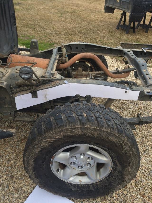

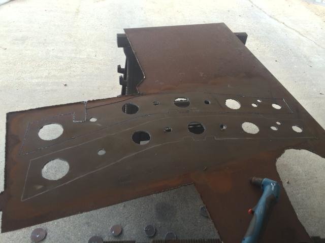

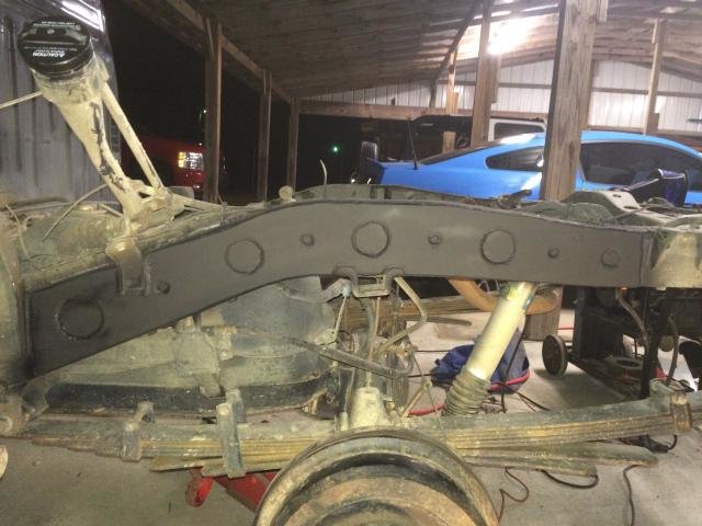

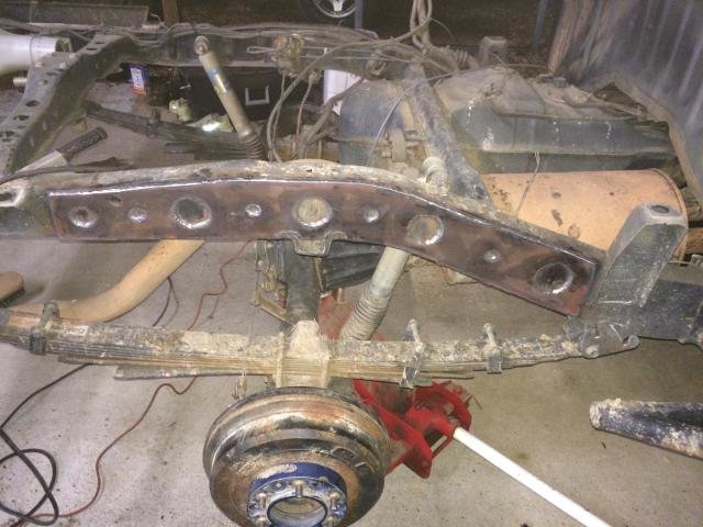

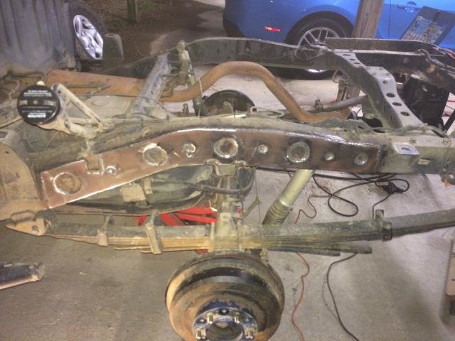

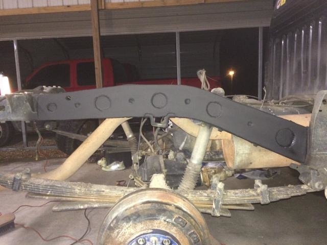

    The front wall of my bed started tearing, so last weekend I took the bed off and welded it back up. While it was off, I decided to make some frame supports. Tomorrow I'm planning on doing the clutch. I've got a stage 3+ comp clutch, LCE 38lb flywheel, and a Marlin Crawler short throw. Also doing the rear main seal and whatnot. As you can see it needs a bath, so that might happen as well.
