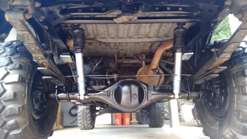

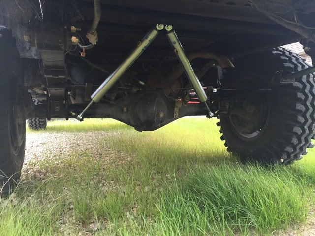

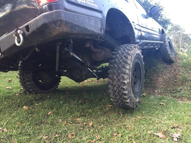

    I'll post a couple pics that I took right after I put them on. I'm not super happy with how they perform but they work good enough till I lift the truck up a little more so and get them more vertical. I'll have to check out your setup.
    Nice. I wouldn't mind getting my hands on one also. My girlfriend is wanting to buy a 1st tacoma after the first of the year but I might try to talk her into a 3rd gen 4runner.

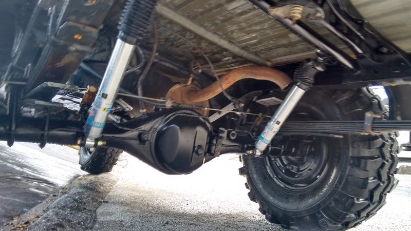

    Here ya go... I really don't have that many pic of them and I have flipped them over after it was pointed out to me I had them mounted upside down, but they work well...
    They're only 10" travel 5125s, but given they are mounted a bit more inboard than the stock locations, I think I'm getting pretty good articulation out of them. Really wish I could have left them mounted that way so the ugly ass boots were hidden up under the truck instead of on display.

    Oh ok. That looks awesome. That's how I would like to get mine mounted but I'm running the 14" travel ones. As far as the boots go, just cut them off. The boots are known for collecting and holding water and grit, anyway. The ones on my 5100's for sure held crap and I think that is what did them in. Do a little research before you do it but I know I've seen other people talking about cutting them off. On the other hand, I don't see where it hurts to run them upside down. They are sealed and charged so they should absorb the same no matter how they are turned.

    Hmm...Todd is running 12" 5125s with his 63s, same configuration mine. He seems to get damn good articulation out of it. I don't think he's bottoming them out at full droop, so perhaps 12s would be the better way to go to let you mount them straight? Maybe slap a set of 12"s on it and keep the 14"s for when you lift it more?

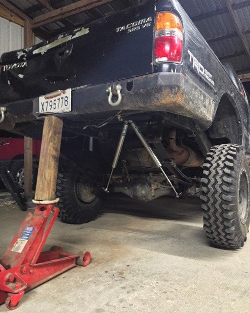

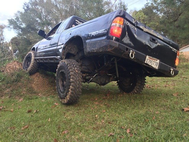

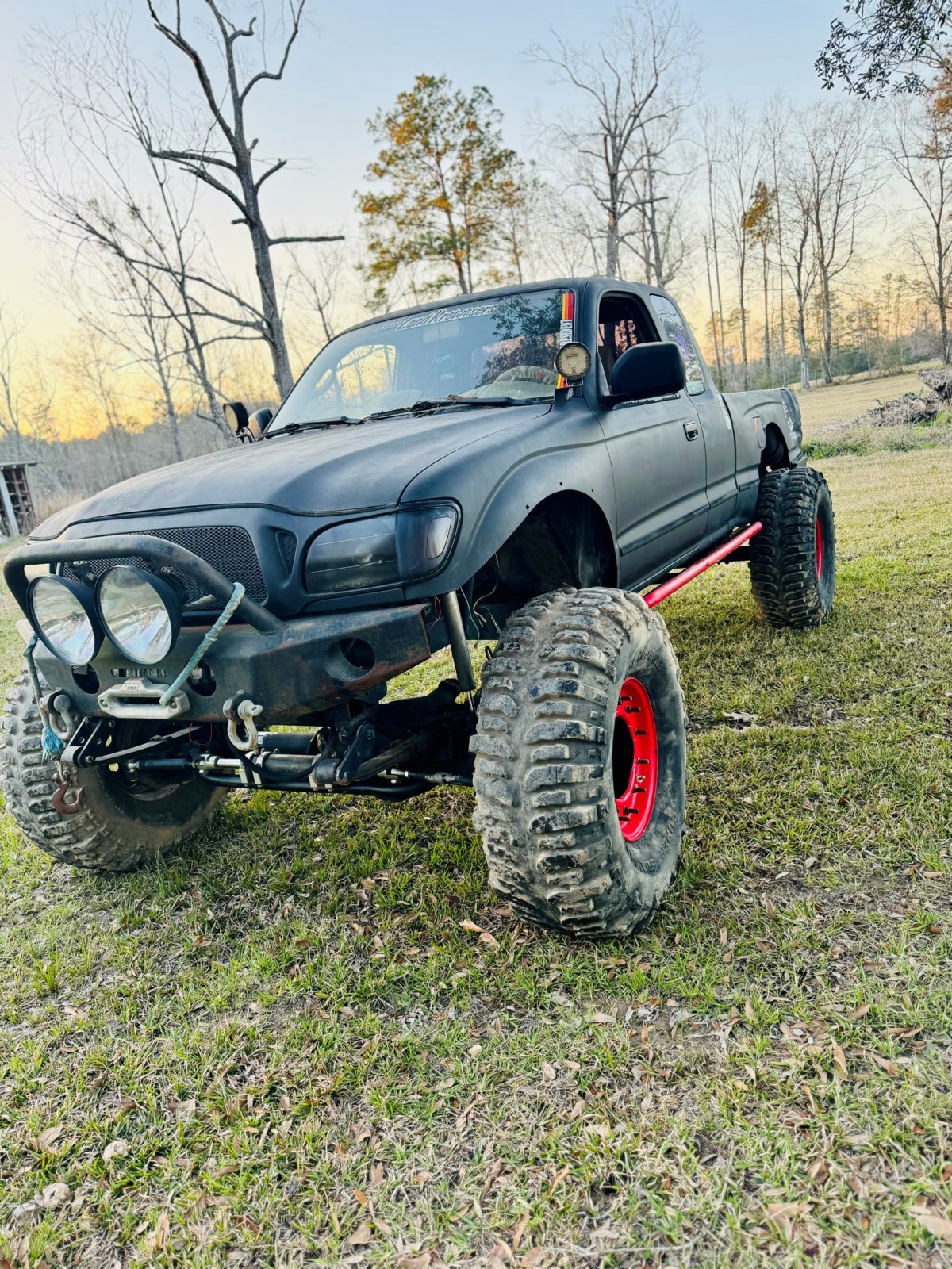

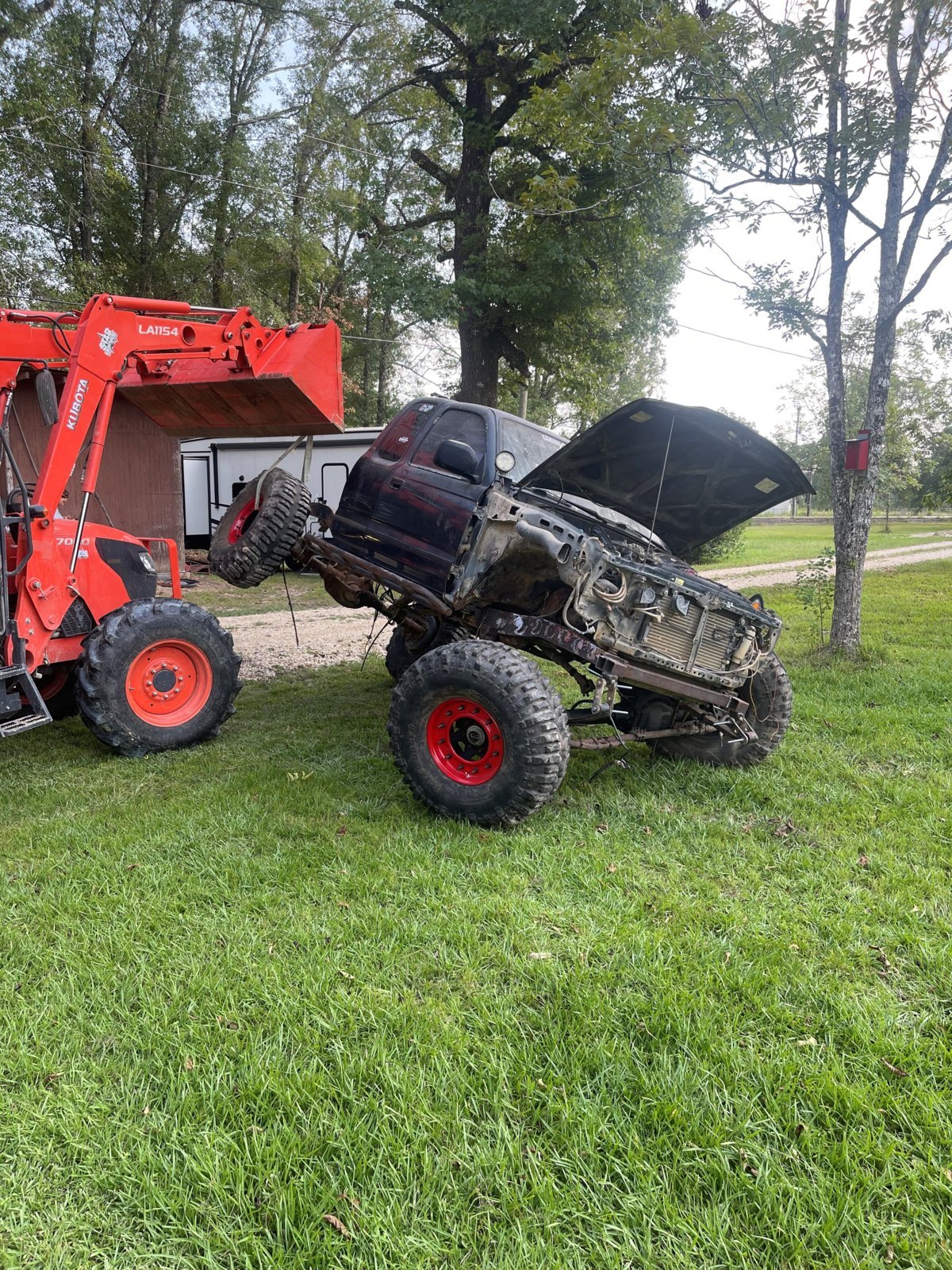

    In case anyone that was following was wondering, I'm still around. Some slight changes since the last time I was on. It's Acutally my wife's rig now....
    This is now my project/toy. I also bought another 01 double cab 4wd to drive back and forth to work.
