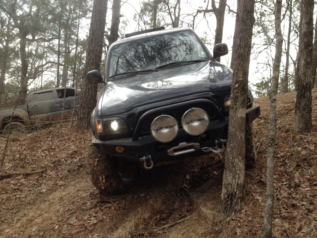

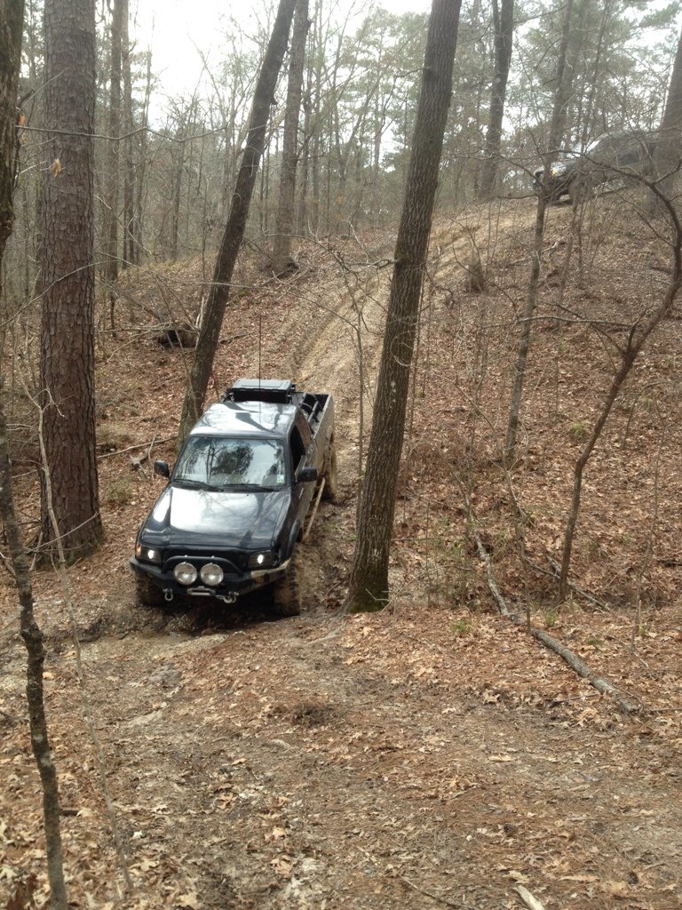

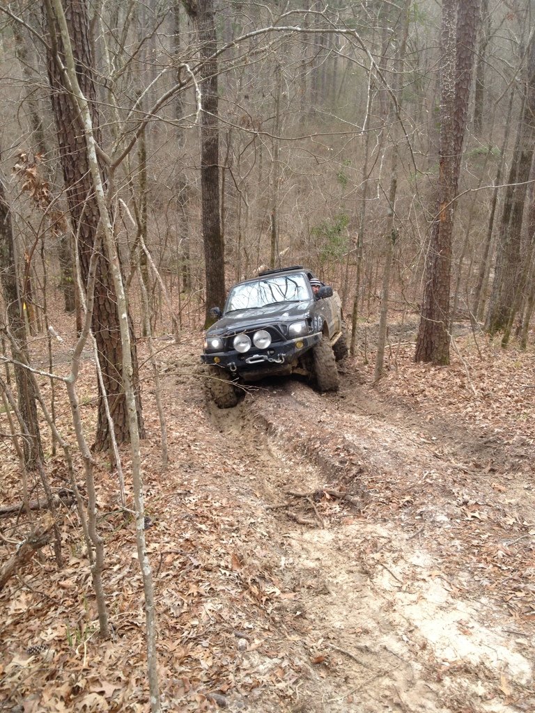

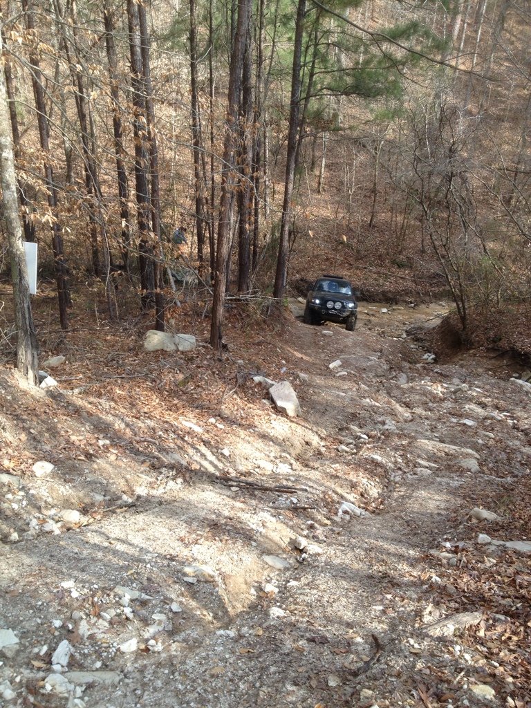

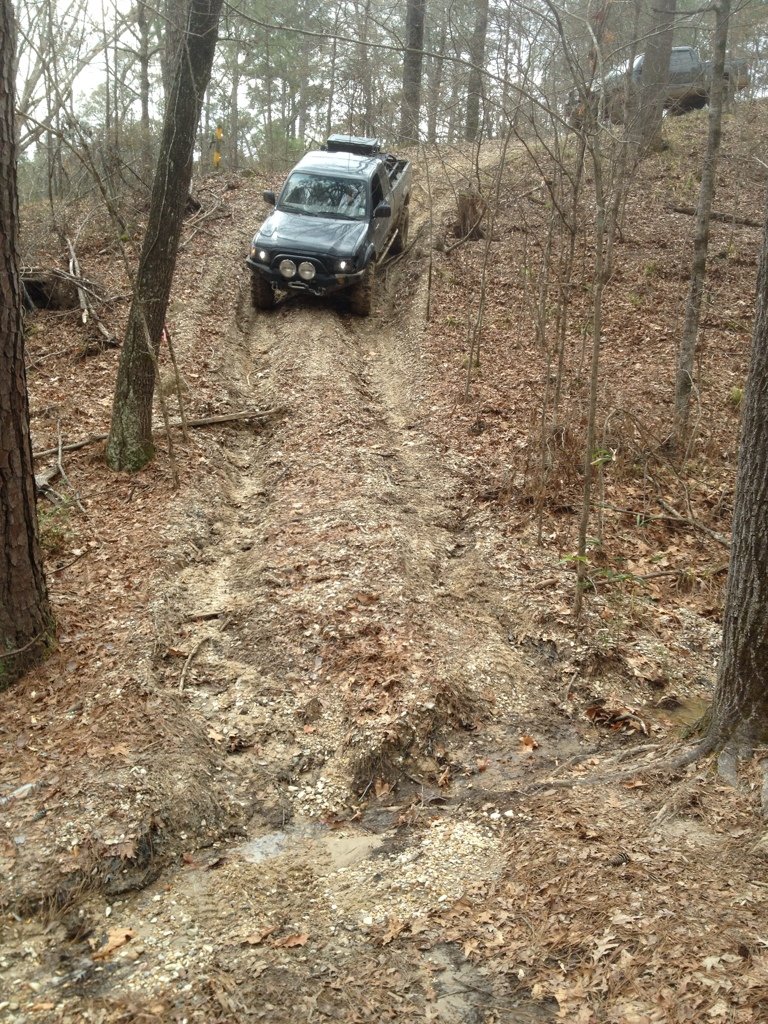

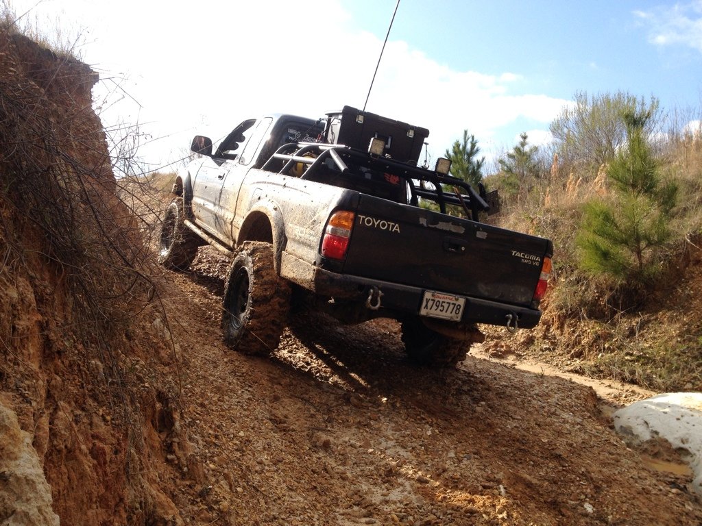

    Some pictures from this weekend

    That is bad ass. :taco:
  4. Mar 4, 2013 at 6:24 AM
    #164
    Southern01Taco
    Southern01Taco [OP] Well-Known Member
    Jul 20, 2010
    #40457
    1,954
    Sean
    Holden, La
    01 V6 4x4 Xtra Cab SR5
    Thanks Bowen.
    Yea it scared me when it first dropped in the hole but once I realized that it wasn't going over it was pretty awesome lol.

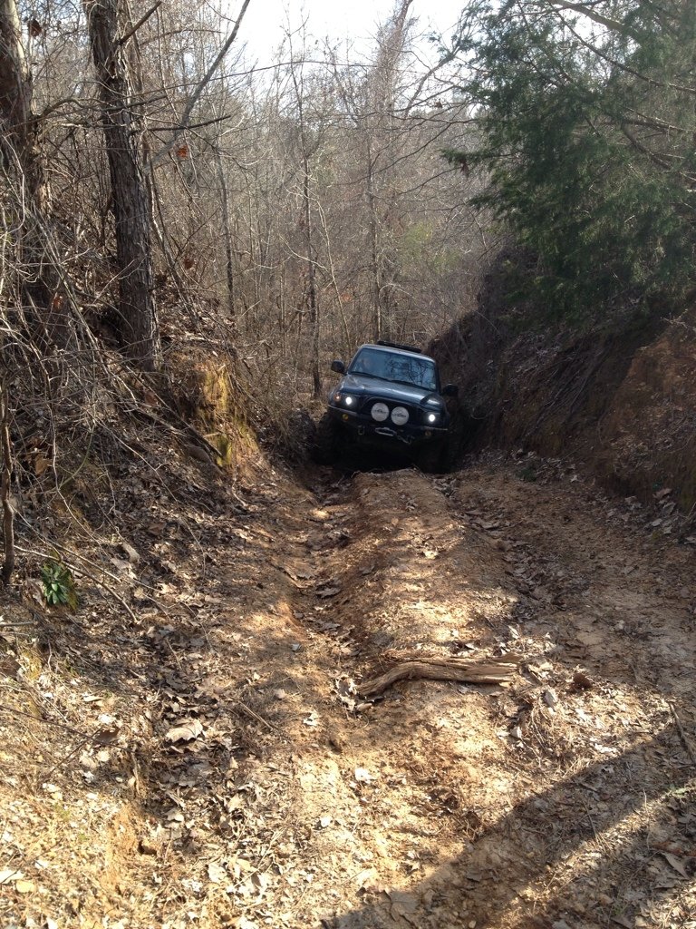

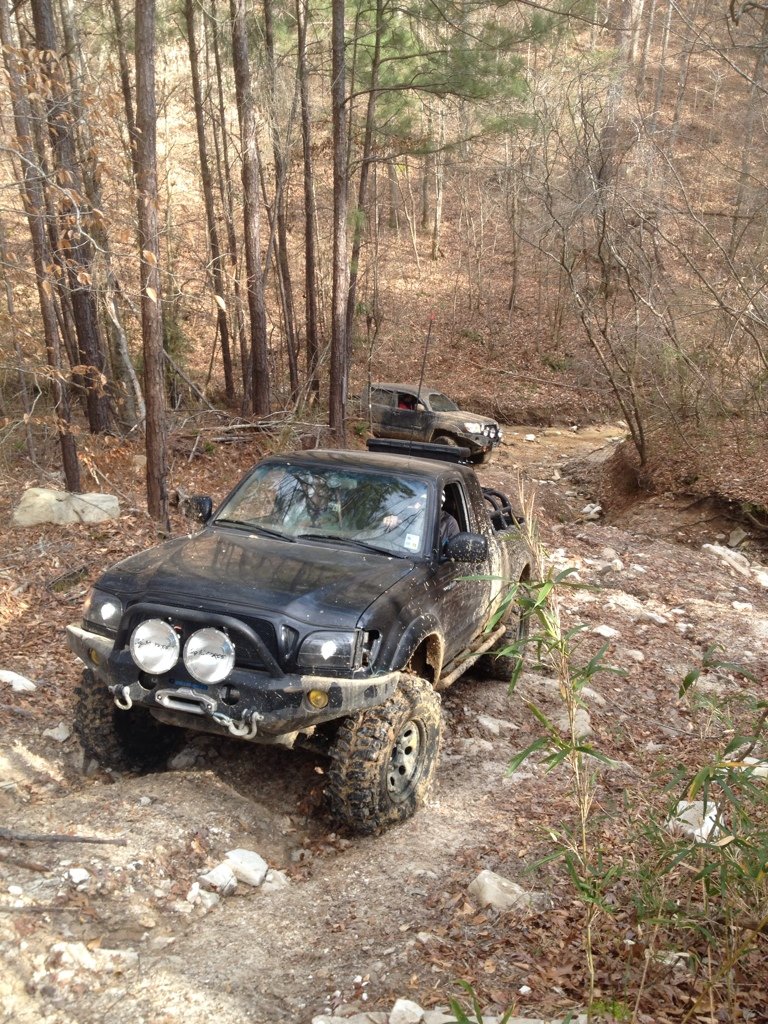

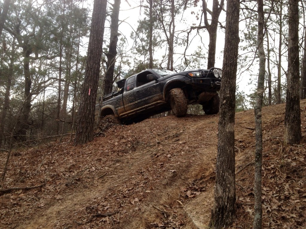

  5. Mar 6, 2013 at 5:41 PM
    #165
    Southern01Taco
    Jul 20, 2010
    #40457
    1,954
    Sean
    Holden, La

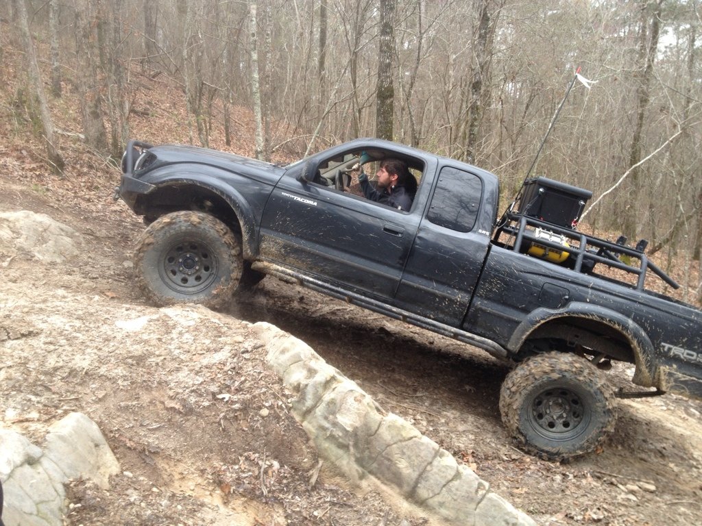

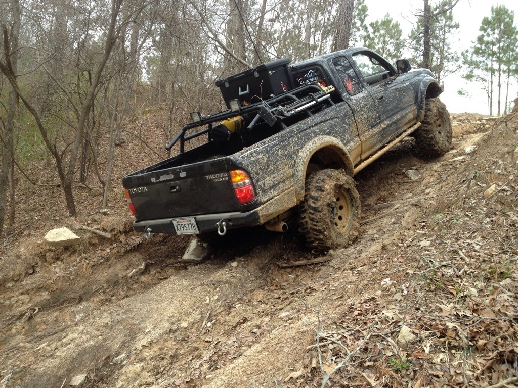

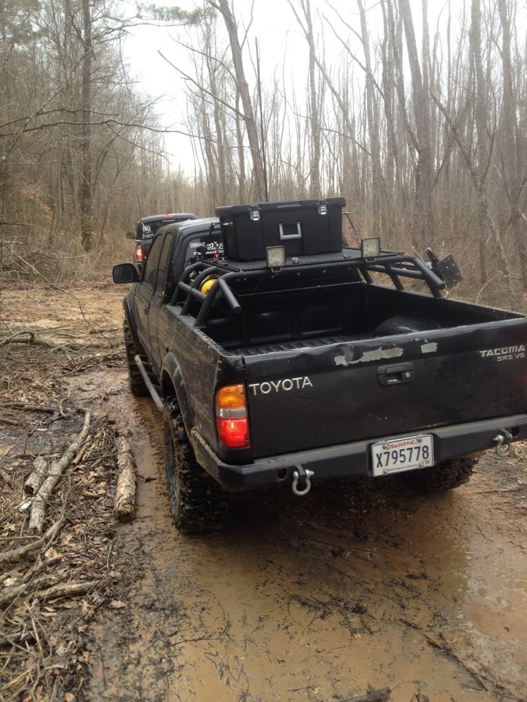

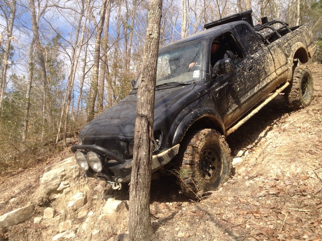

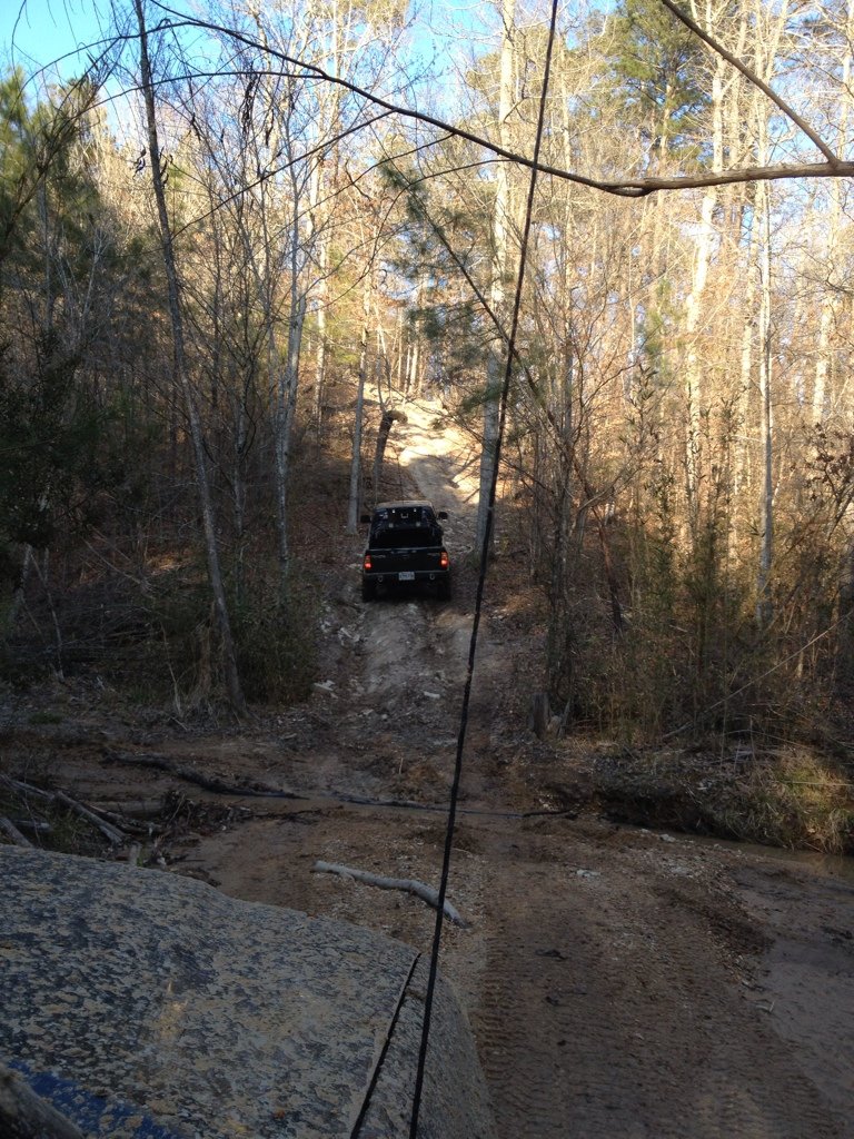

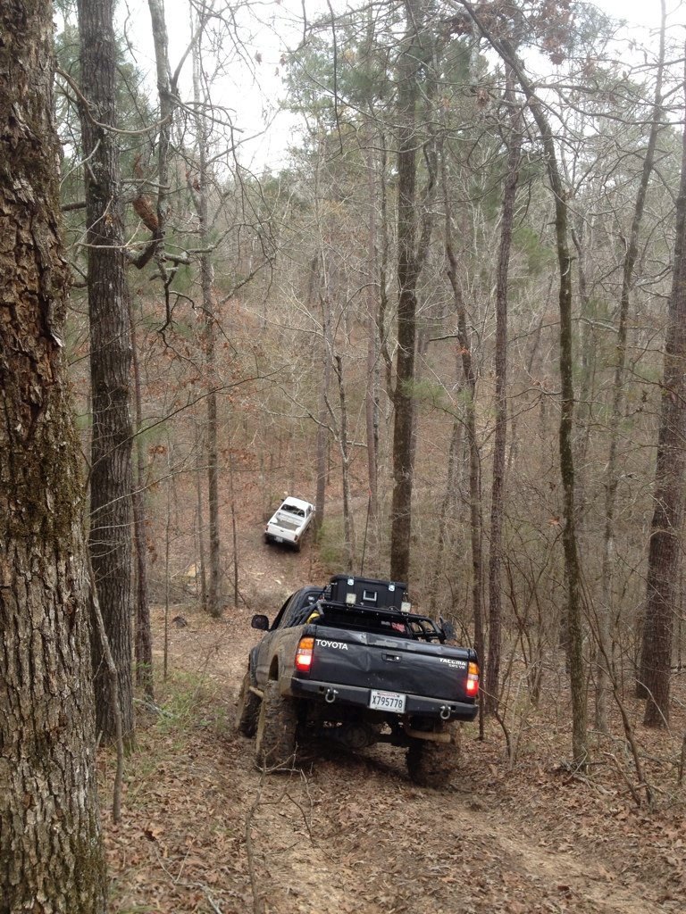

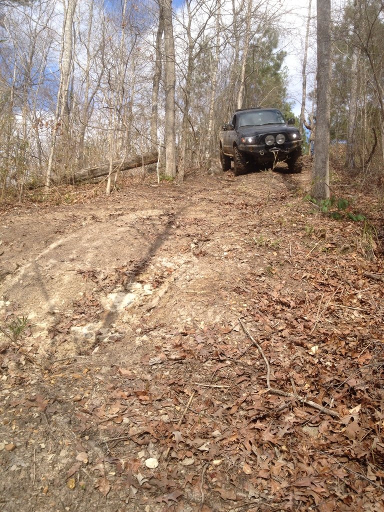

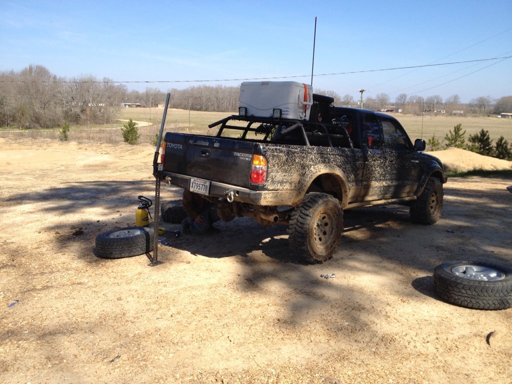

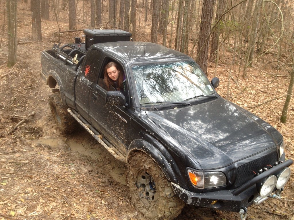

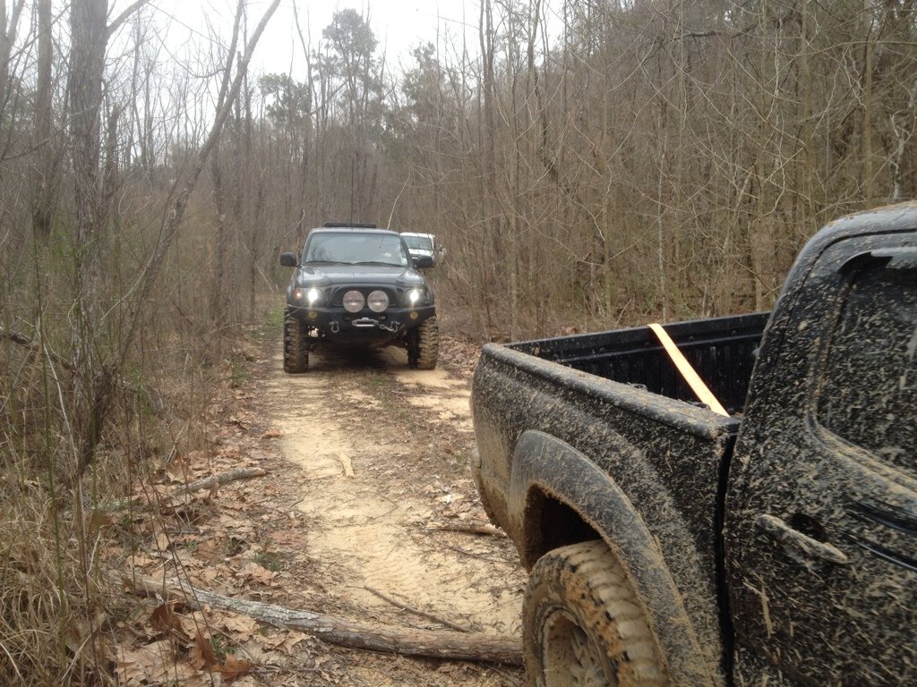

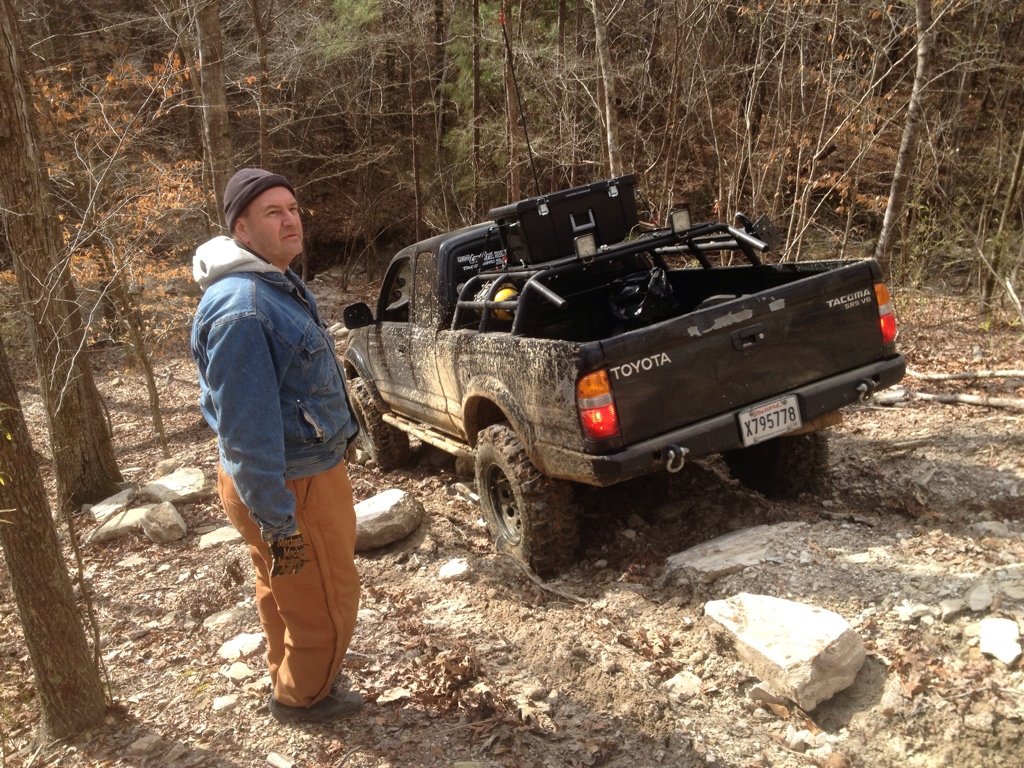

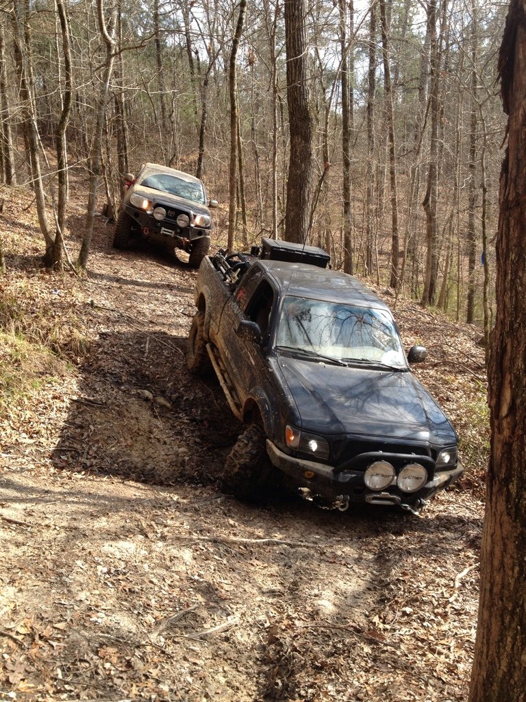

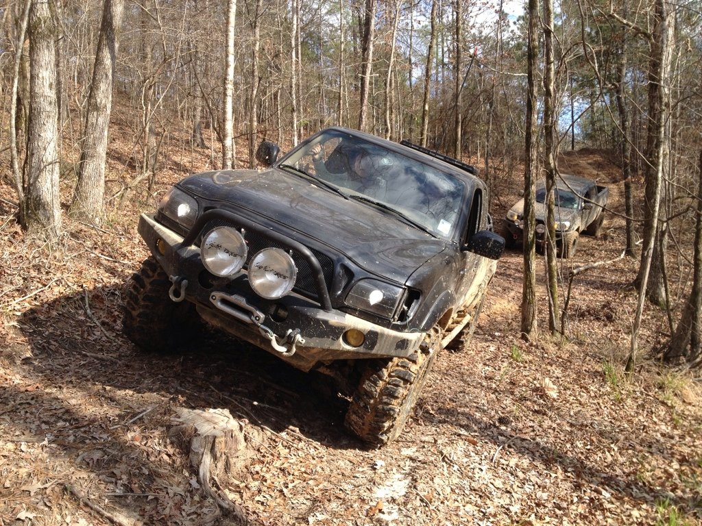

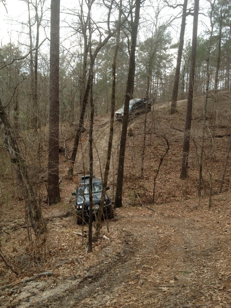

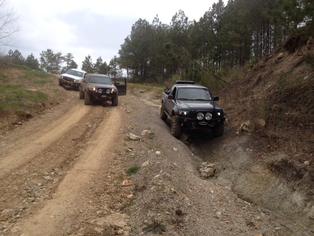

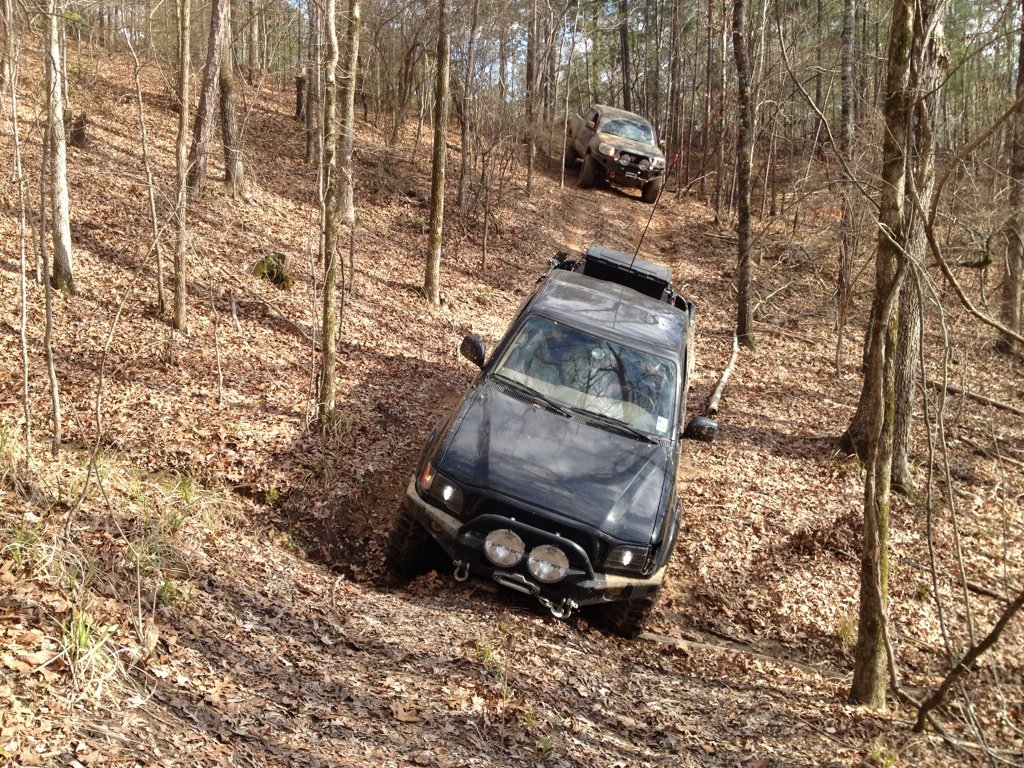

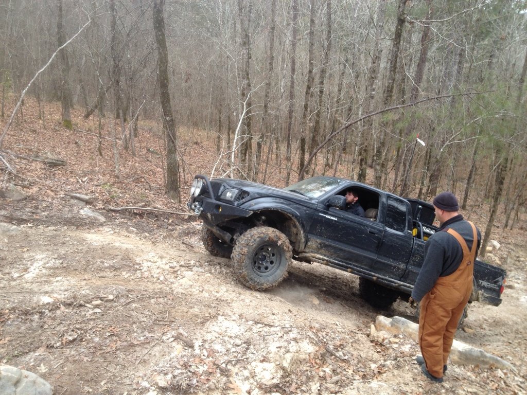

    Here are the rest of the pics of my truck from this weekend. They are all out of order and I'm way too lazy to organize them :D. I had alot of fun. We did a bunch of pretty difficult trails. I only got a little body damage. I hit both of the back corners of the bed, right before the taillight. I need to bob the bed bad but I'll have to just keep beating it up till I get the time to cut it up.

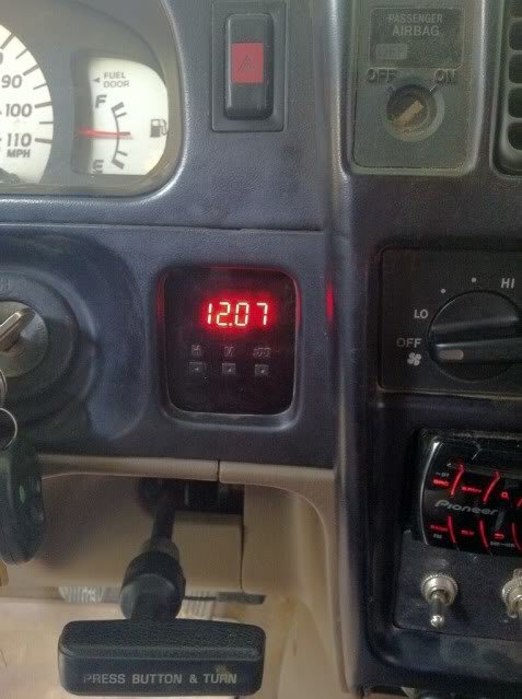

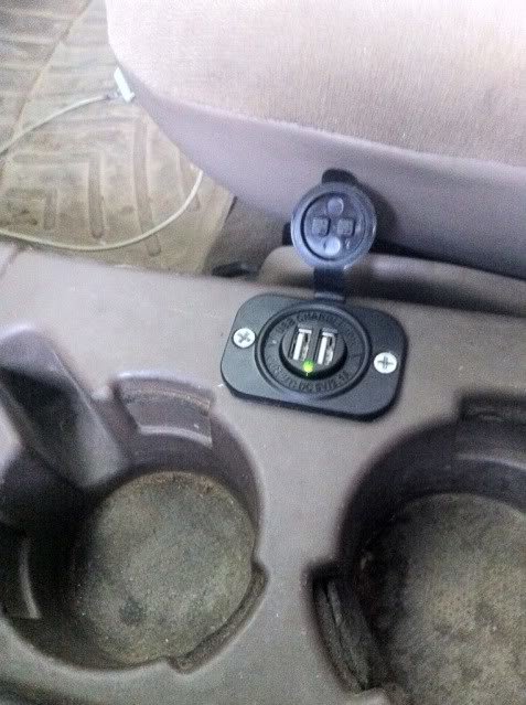

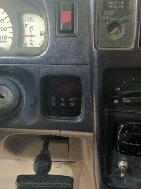

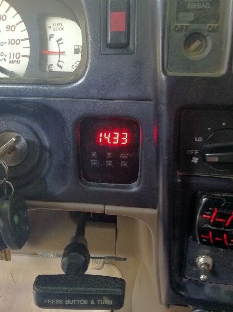

    I transformed the factory clock into a voltage meter. It was pretty simple and turned out awesome. I also installed a USB charger outlet.
    Voltage Meter
    Key off, engine off
    4EAD6AA3-AED5-4426-83E2-854B9E9AA035-273_349b7e7080b1e44ad02a2b01fb70238ebdd25eb6.jpg
    Key on, engine off
    ADE31E24-F18E-4D48-94F1-F30CEEA41886-273_c95f12d0ac2a96e0ce039628da8942466c1e7c48.jpg
    Key on, engine on
    E8308041-A6E2-4B32-9865-ECB263999E96-273_fb817de5ba1885df9b48ad260b5bc642648533c3.jpg
    USB outlet
    F737FD29-E614-4D73-9F08-2150CE559AB6-273_cd55c17c2974efbc39fcd842c384312b30b8545e.jpg
