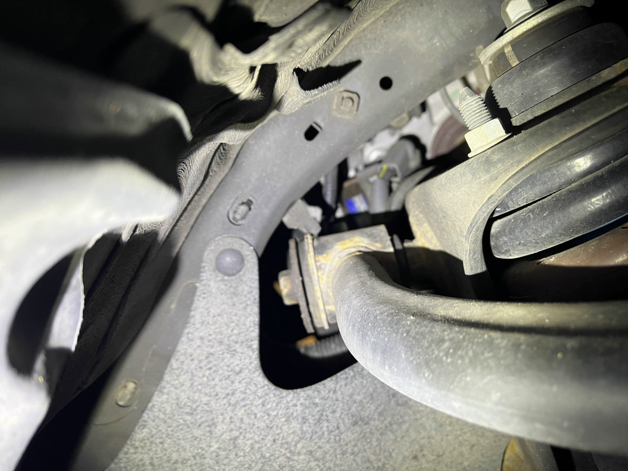

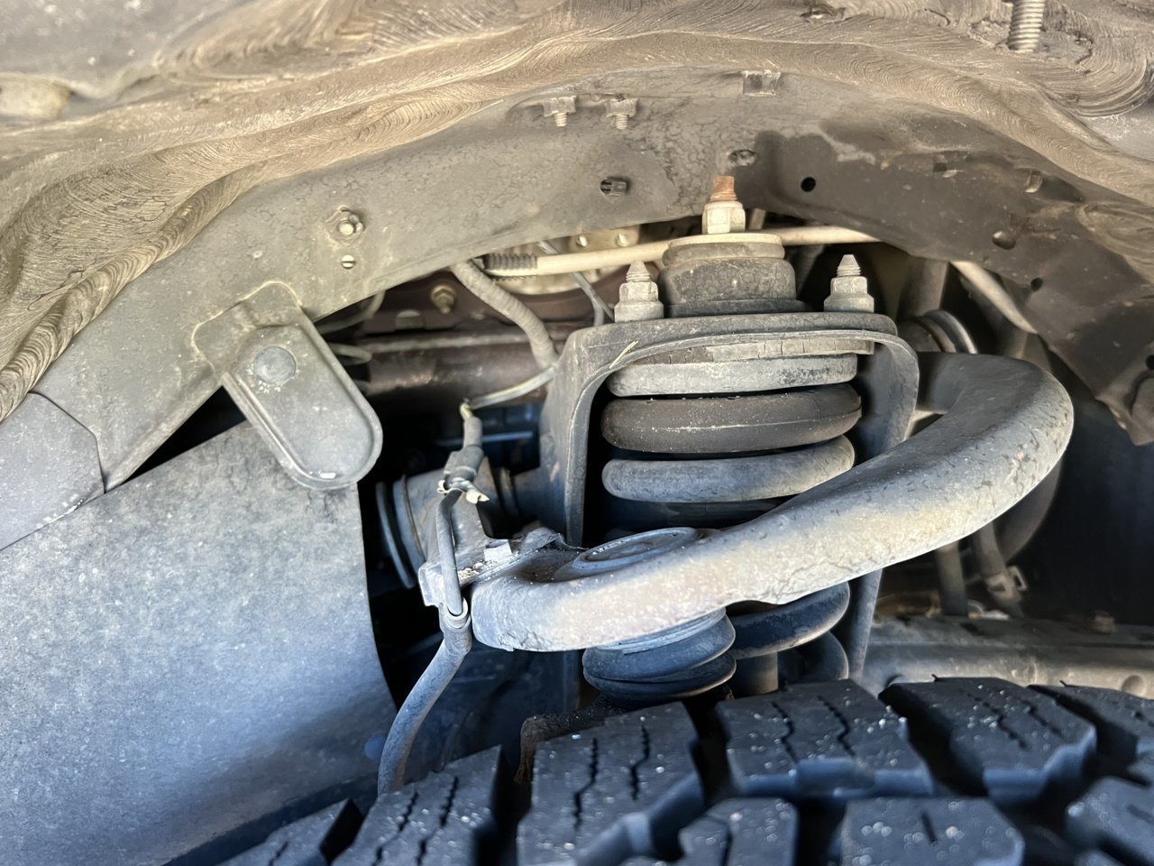

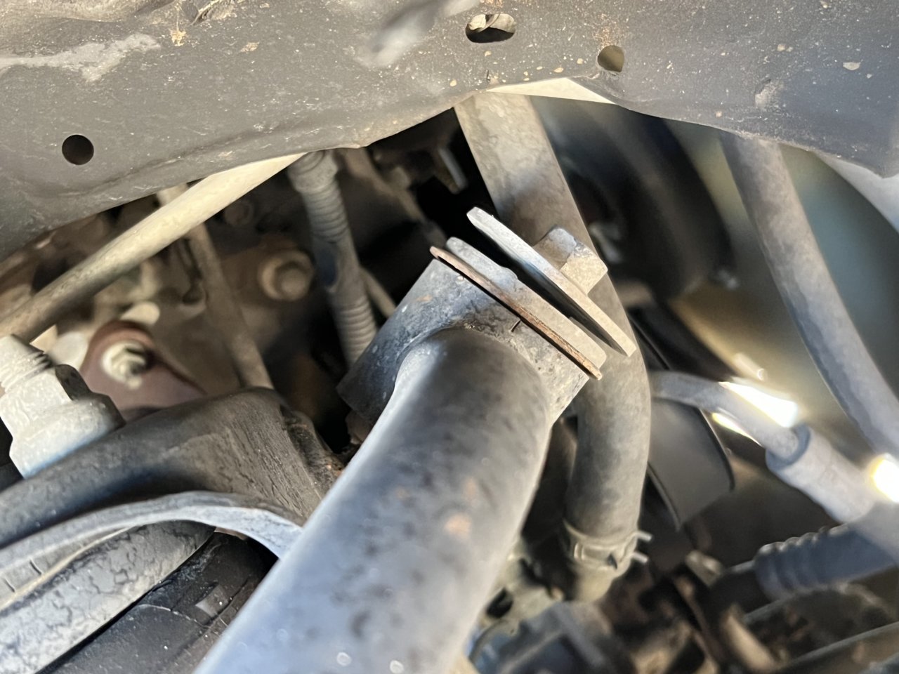

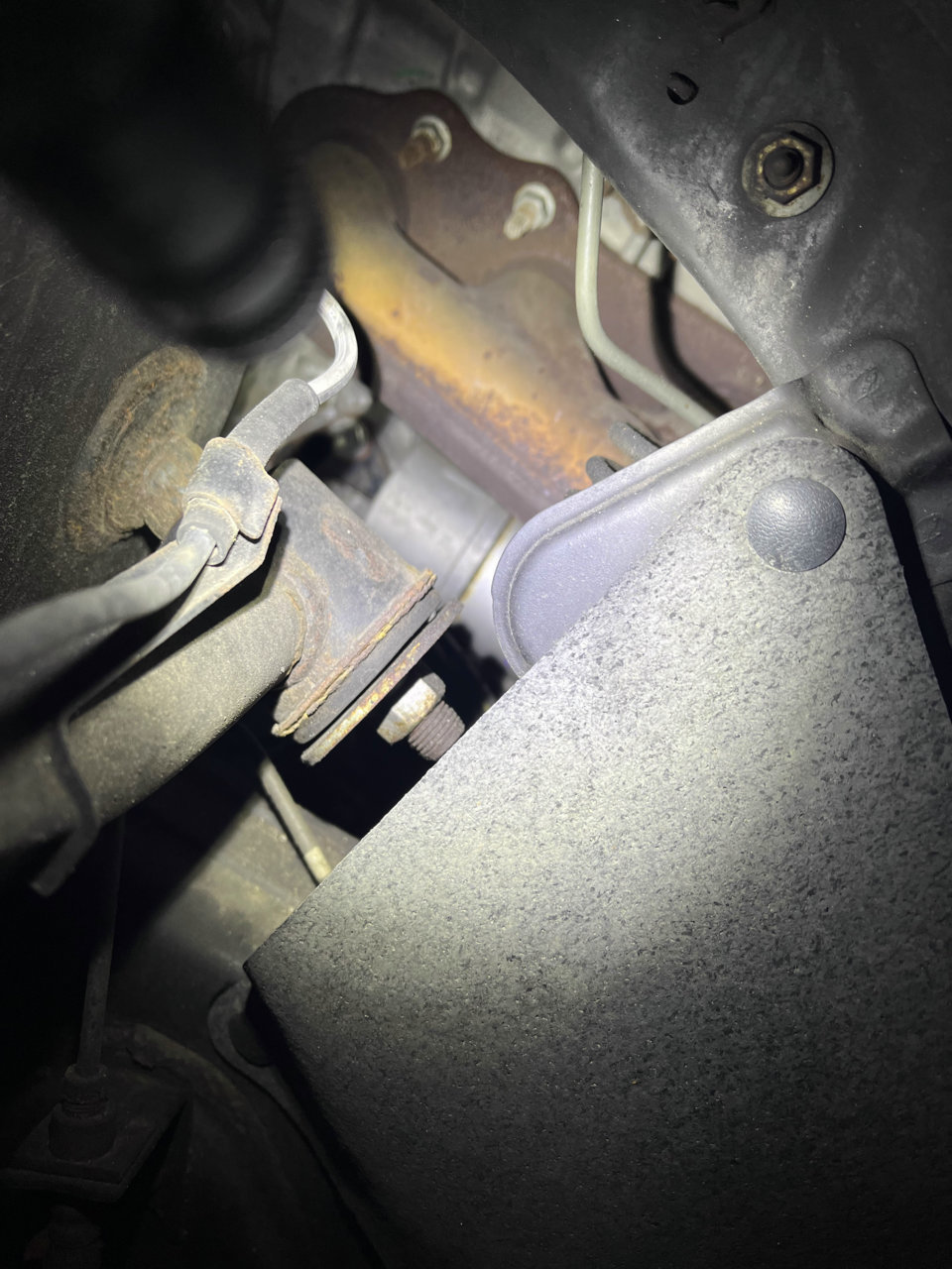

    Was airing up my tires and noticed a gap between the washers/bolt and Upper control arms. Is that how they are suppose to be or is my suspension about to blow up?
    It is the same on both left and right side.
    There is a gap on both we’re the bolt head is and where the threads are

    I believe the bushings on the UCA's have a metal center portion that is slightly longer than the rubber isolators. Look in there real closely and see what you can see.

    Nut torque is 90 ft-lbs IIRC, put a torque wrench on the nut and check at 80% if you're concerned, otherwise I agree with AJ.
