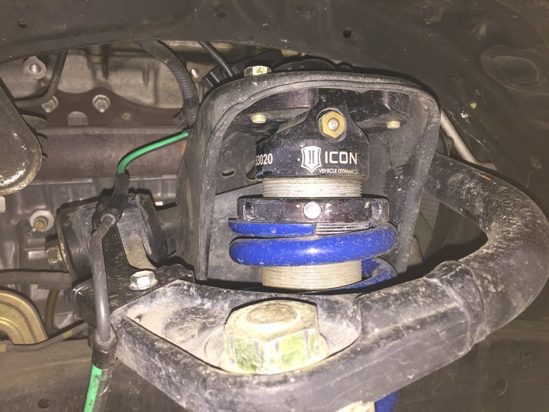

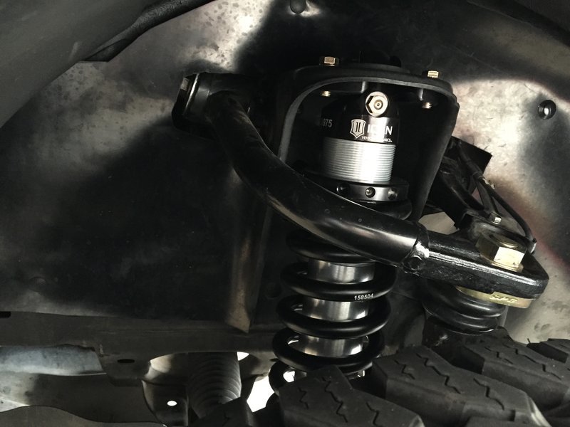

  13. Apr 12, 2017 at 6:58 PM
    #33
    Justinlhc
    Justinlhc Not looking for a relationship
    Jul 7, 2015
    #158945
    3,513
    ^^^ this is what I'm saying is wrong.
    13" 650lb coil:
    14" 600lb coil
    Same amount of lift. Defying physics :cookiemonster:
    Byb127 likes this.
  14. Apr 12, 2017 at 6:58 PM
    #34
    jberry813
    Jan 21, 2011
    #49636
    28,471
    Jason
    Lake Tahoe
    2012 DCSB Sport
    ...too much shit to list.
    Enjoy your thread
    deeezy and bullaculla like this.
