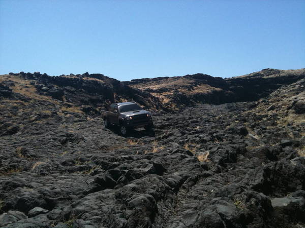

    Not to start an arguement but my friends truck has spacers and we wheel the shit out of it mostly crawling, no high speed whoops or deserty stuff here so cant say much about that but for the crawling it worked fine nothing broke...yet

    ^^^this guy has spacers
